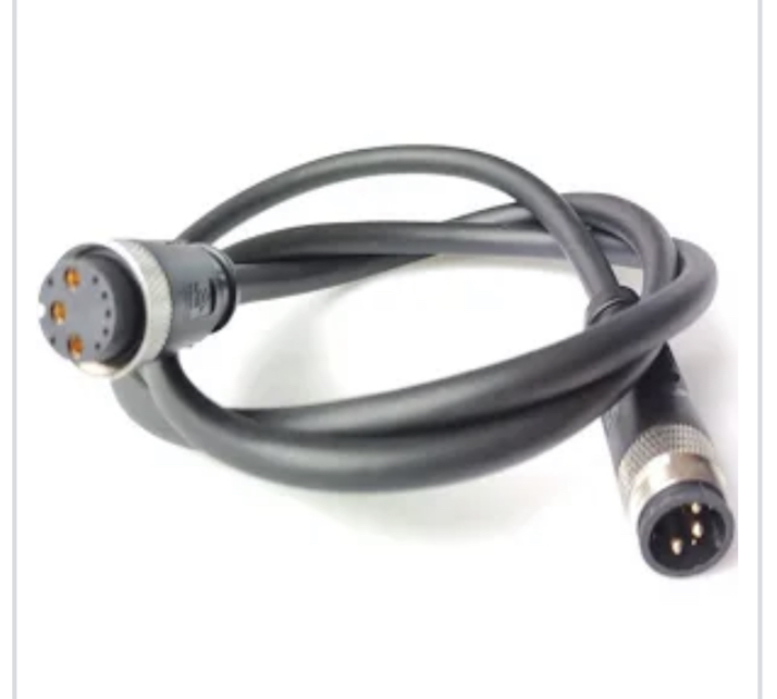

So......now I'm trying to figure out how to splice a female end L1019 to a male end Julet Z916 so I can use a KT controller. That's my plan anyway. Grin has a connector almost like that, opposite ends though than what I need.
Anyone have advice on how to "correctly" splice this together? I know the L10 with have an extra wire (for temperature I think?) that I will have to combine with another wire. Need some guidance on this.
The "extra" wire is of no concern. It's for a temp sensor - IF - so equipped. Don't worry about connecting it with another wire as the KT won't read temp anyway.
To be honest, I don't know an L10 from a hole in the wall. Please post a pic that will positively identify what you are working with.
With a Bafang motor and a KT controller, I'm pretty sure the phase and sensor wires match color for color so splicing an extension on to one end or the other shouldn't be too big a deal. Still, time spent finding the correct extension will be well spent if you can find one.

Here’s what I’ve learned in all this. The L1019 comes standard with the 1000watt Bafang hub. In all seriousness, I wanted a 750watt hub, but couldn’t find many kits at the time. When I found some they was more expensive than the 1000watt version???? Weird I know, but true.
The 750 comes with the Julet Z916. Would have been easier with the 750, but oh well.
Thanks for the wiring info. Here’s a pic of the L10

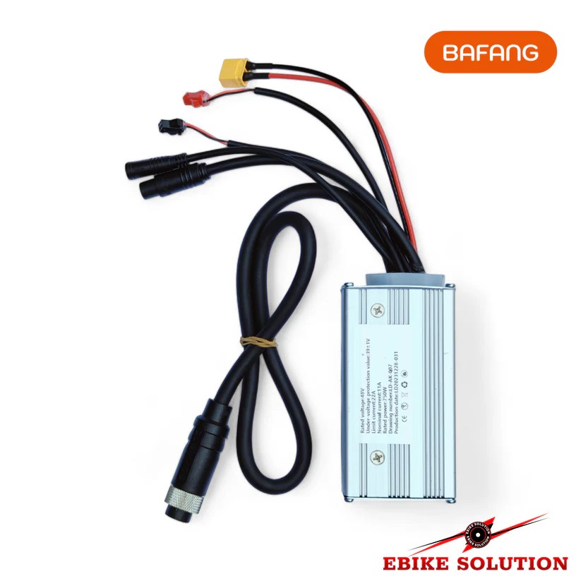

Hello All!
I recently bought a kit with a Bafang 1000w rear hub. I'm running a 48v 19ah battery with a Allocomile controller(Basic Chinese) and 500c display. This thing just goes to fast in the PAS levels. What controller could i reasonably get to help tune the speed or power down for the PAS levels? I'm ok with replacing a display also. My controller is HiGo ended. An example is PAS level 1 motors up to 14.8 mph. A little fast just to mosey around on. Any thoughts? I'm new to this but learning fast. It's hard to get a clear answer though.

YOU NEED TO BUY an LD-AK-007 BAFANG CONTROLLER if you want to program it with the bafang program or with your telephone with the speeed app from playstore
