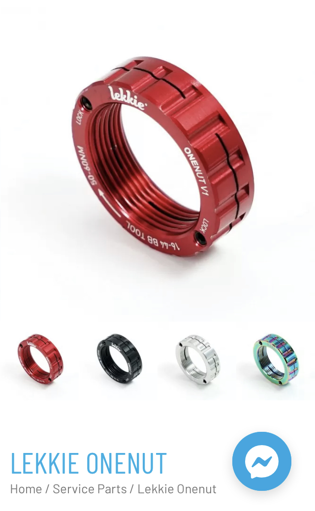

Lekkie lock nut BBSHD BBS01 BBS02 M33
tomjasz
Minnesnowta
Lekkie ONENUT is a full CNC machined motor lock nut with a built in locking function that replaces both stock motor locking nuts.
One nut to rule them all!
We are excited to introduce a clever little product that will make installations easier and add extra quality and bling to your bike.
The Onenut is born out of the frustration of having to find a non existent tool to tighten the main bottom bracket nut when installing the BBS kits. Also, when you are fitting to a 73mm bottom bracket, the Bafang cover can not be fitted.
The Lekkie Onenut is a single fastener that can be tightened with a standard Shimano bottom bracket tool, or the Lekkie Sixteen-44 tool. Once tightened the One nut has a locking feature, by tightening 2 grub screws the nut locks to the bottom bracket thread, and can not shake loose or rotate. For customer installations this is a must add on. Cheaper than buying a specific tool for the Bafang nut and completes the look. Available in Red, Black, Silver and Slick.
Why have two nuts when you only need Onenut?
Designed in New Zealand in true Lekkie style to be the premium choice!

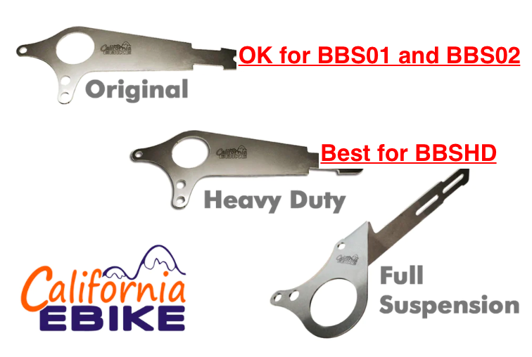

Uh-huh. Let me just say that in 7 years we had scores of complaints with BBS02 750W and BBSHD 1000W motors dropping. It's a part that addresses a market demand. Like the Stabilizer Bar. The bar I find to be ugly. I use two primary rings rather than the "pretty" secondary and primary. I've NEVER personally had a dropped motor with ANY BBSxx series motors, and I've run them all from 250W BBS01 through BBSHD. A and B versions. Some lucky fellas got great deals on used motors.

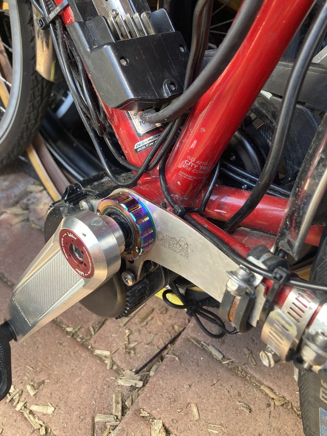

I might get one of these in the future although my primary and pretty secondary have held up fine since using loctite 242 on the primary. Takes forever to get off though since the loctite keeps the primary from ever really getting loose enough to loosen without the luna wrench (which had to be modded/filed to work).
I personally use the stabilizer bar (suspension version) and never really see it. I could always paint it black to match the bike

Yeah. I thought of doing that but as I wrote I never have had a drop. I had those stupidly over priced Bafang sockets and actually never needed them. Loctite green penetrating have served me well. That said I like Lekkie products and I pay dealer prices so WTF. I’ll do my dirt nap broke.

Like grumpy, I've never had a drop. That said the hottest selling item I supported was the stabilizer designed and left in the public domain by Doug Snyder founder of California eBike. Copied and claimed as typical by Luna(tic)
Bought a OneNut from California Ebike, my Breezer Downtown has a 73mm bottom bracket so previously I could only use the one lock nut and it constantly kept coming undone. The part came in the mail today so I fitted it, now to see if it does the job of not unscrewing.
