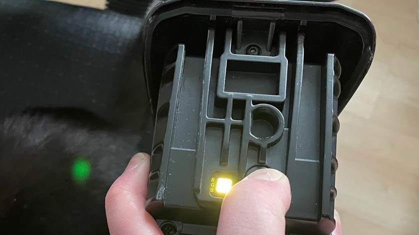

So, I suspect that I have identified the problem. If anyone is interested, TurboAnt asked for a video showing the problem. It's here, but in a nutshell, my display shows error 26 and I pull the battery and measure the voltage with my DMM. http://www.cir-engineering.com/bin/bike/battery_problem.mov
While I had the battery out later that day I pressed "the button" on the battery that indicates charge level with LED's; green, yellow, and red. The LED showed yellow, so the battery considered itself as being usable still. This led me to believe that the BMS still 'thinks' that the battery is good to go at 43.5 volts and is not causing the shutdown.

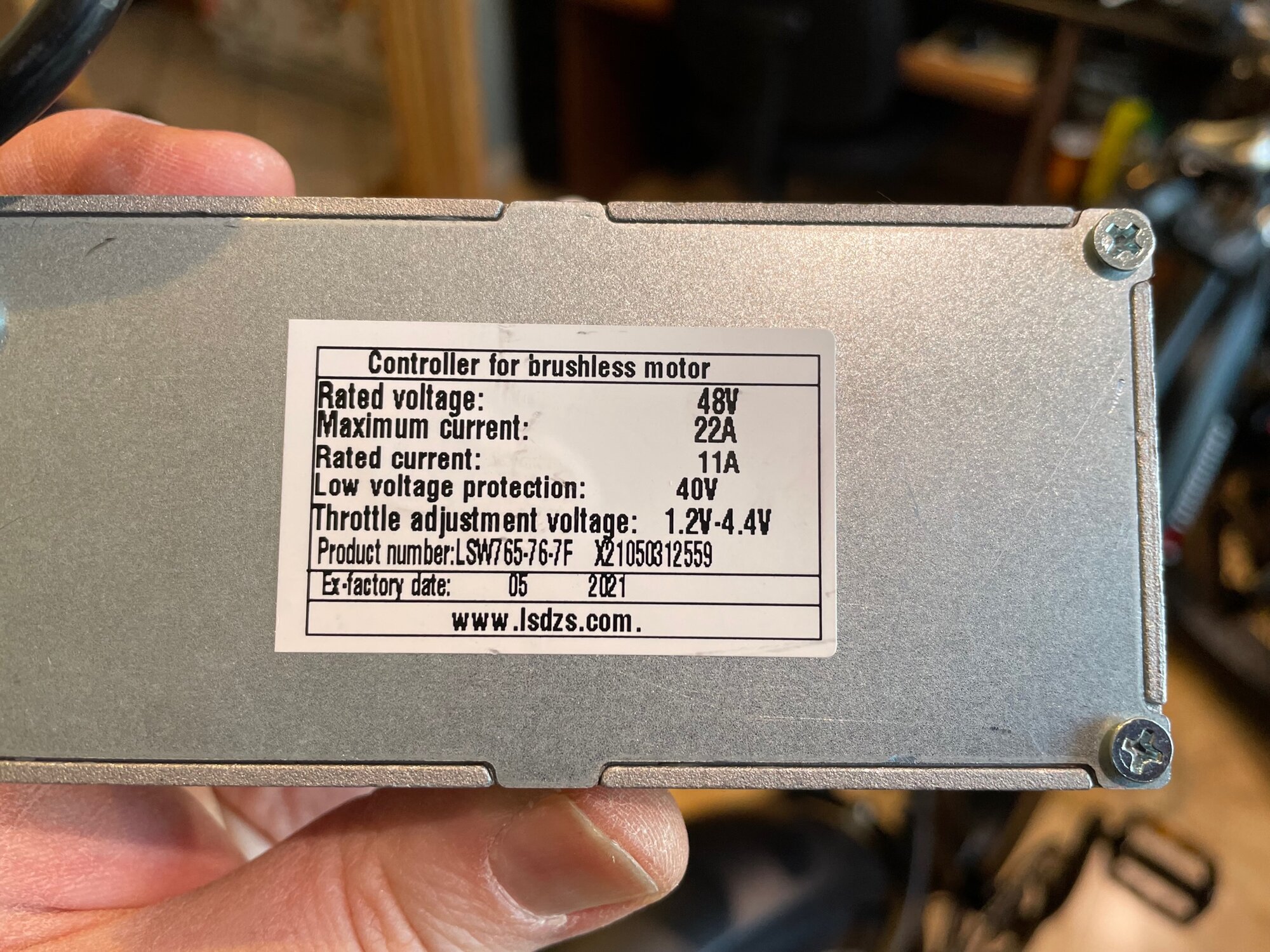

I then remembered that I had pulled the controller and photographed the label on it for my records. Note that on it, low voltage protection is shown as 40 volts.
Others with my bike who live in hilly areas have had issue with this controller overheating because it's also only rated for 11A continuous. Luckily for me there are no big hills in Chicago, so I have not had that problem, but this controller is a POS.

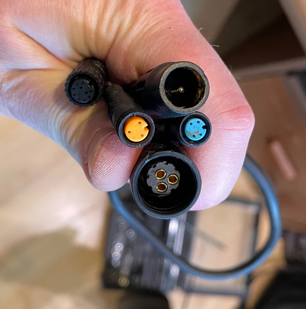

I'd like to replace this controller with as little splicing as possible to keep it close to OEM. This is what the termination looks like, and it does have headlight, taillight, and brake light.
If I must slice, splice, and solder I will. Can anyone point me in the direction of what controller may be compatible with my system? I cannot find a datasheet for this controller anywhere.
On that note, I suspect that the controller's LVP is hard wired and not programmable. I'm planning to open it today to see if it's potted and if I can modify or even disable the LVP circuit in the controller. Maybe I will get lucky and even find a couple of trimmers that are adjustable. I am assuming some here would object to this idea, but I would like to hear the cons please. The BMS in the battery is good and I would think knows better than the controller what is safe for the battery?

Thank you Harry, for this early comment regarding the controller.
