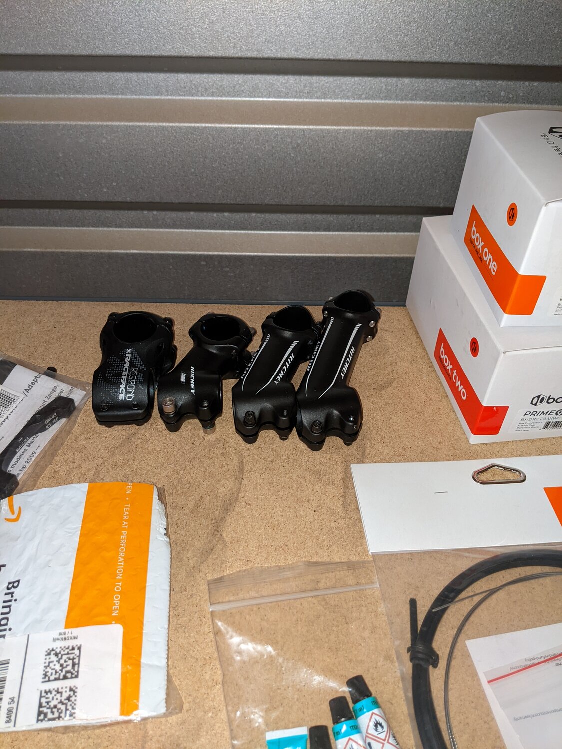

Bicycle fitment is something you can fiddle with to a bigger extent than many may realize. Its something I am covering in my 'how to build an ebike from scratch' series. Here's a picture from the 'Perfecting' chapter that I have yet to release. If your saddle is too far back because of seatpost setback, then rather than chucking your post your next fitment alternative (after moving the saddle forward to the furthest extent allowed on the scale found on the side of the seat rails) is to put in a shorter front stem - assuming thats possible. This brings your handlebars back towards you after you moved your body back and increased your reach with the seatpost. A shorter stem also makes steering more responsive, which is probably something you will not notice, frankly.
The OP's discomfort is, I think, much more likely due to reach than it is to leg position.
I started out with a 110mm post with a 7-degree rise (not pictured) and ended up changing to the far-right stem, which is a 120mm stem with a 45mm rise, taking my bars further out and up (I had a different issue to solve that mostly involved handlebar height).
Now I have to literally think about laying my hands flat on the bars on this bike. My gut tells me to grab the bars with thumb and forefinger and ried that way which tells me I may have solved the height problem, but now I need to deal with reach. A hopefully final solution on this bike will be to add in a PNW Components Coast suspension dropper post (note the use of those two terms - suspension dropper - in the same sentence). That post has a zero setback versus the probably 1 inch setback I have now, and advertises 40mm of travel but reality is its much more if you ride with the post normally extended.
This was not something I was aware of when I bought it due to my own ignorance/newness to bikes and components.

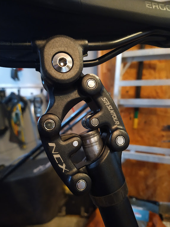

Absolutely not. What I did is remove the 4 set screws which hold the roller pins in place and pushed out the pins; reassembled the lower part as per how it came (had to remove this lower roller pins to get to the upper set screws); then flipped the top part + seat mount around so the seat mount is almost inline with the post. It works the same as it came when new, it's just the seat mount is about 1.5" more forward, and higher, which allowed me to drop the post further down into the tube.
Hopefully this picture helps show how the seat mount is more forward and higher than the original position:
The stock location from Suntour has the seat mount back much further and lower.

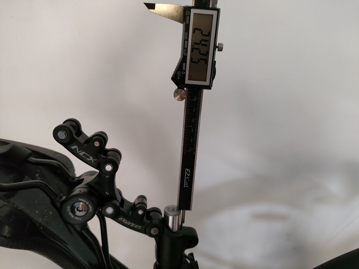

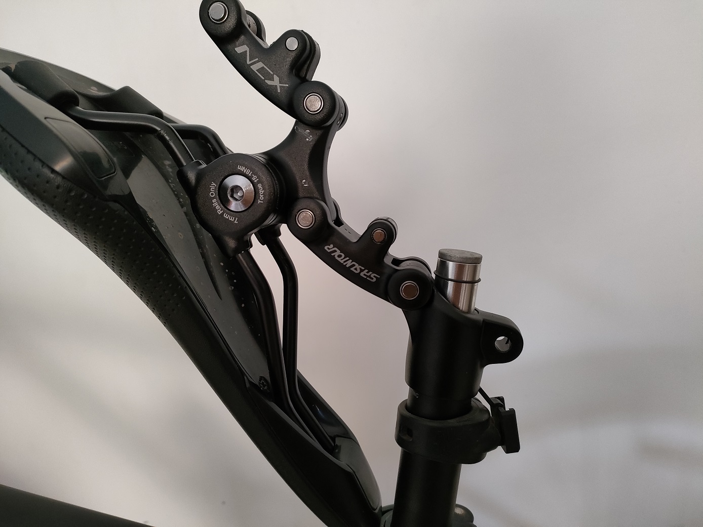

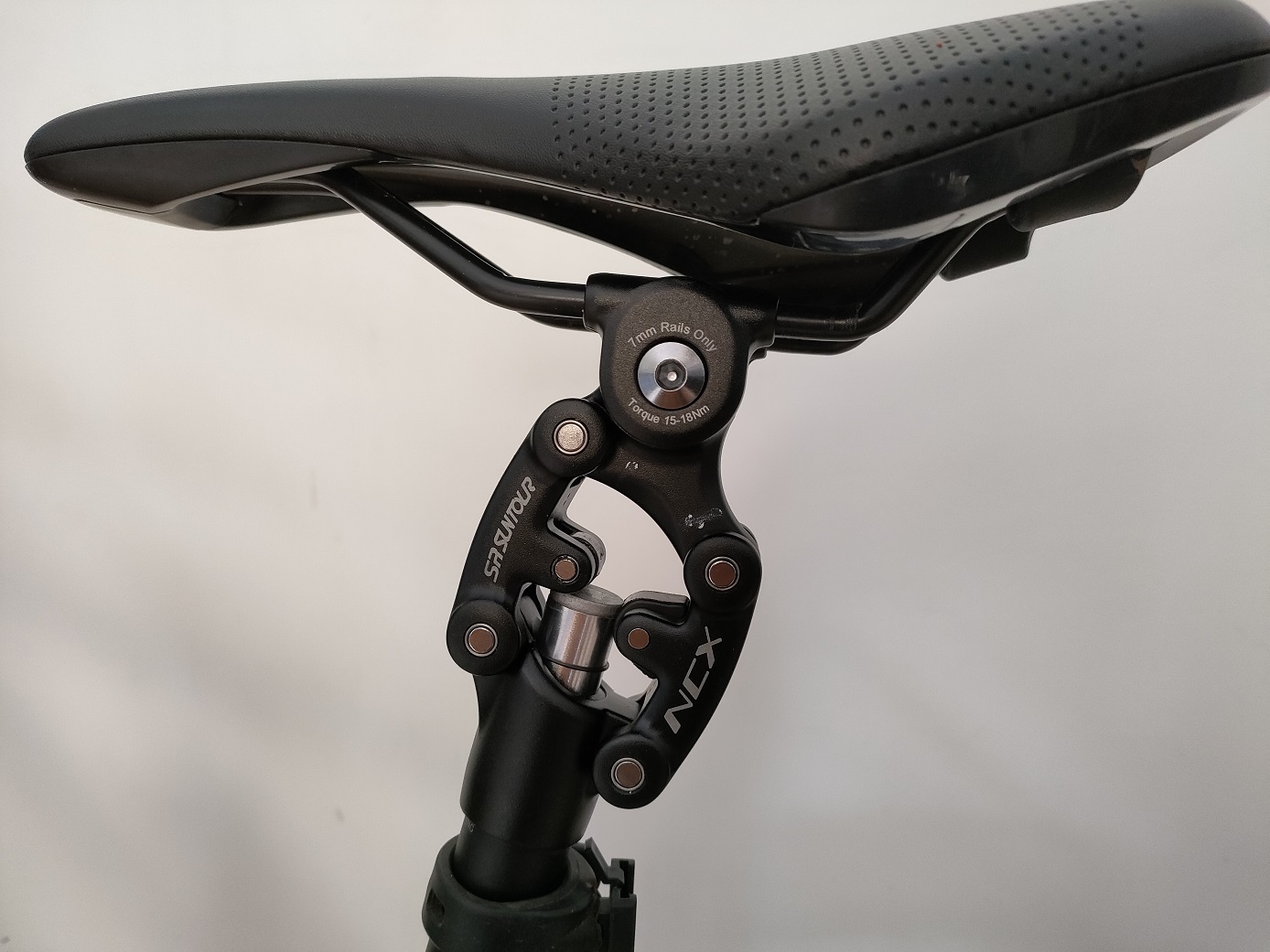

Took a few pics for those interested.
For the sag adjustment, the manual recommends 1/3 of travel. Full length of the exposed suspension rod is 24.25mm, less around 3mm for the wear disc on top. Therefore 1/3 travel is roughly 7mm.
I placed an Oring over the rod to help measure the sag when I sit on the bike.
After pushing the O ring to the bottom, then sitting on the bike, I was able to measure how much the O ring moved. In the following pic, thats around 7mm of movement. The bottom spring adjuster has around 12mm of threads exposed (minimum 10mm recommended) so it should be all good.
I weigh 70kg. According to the manual, the standard spring is for 70-95kg rider, soft spring for up to 75kg rider, so I've ordered the soft spring and will compare.
