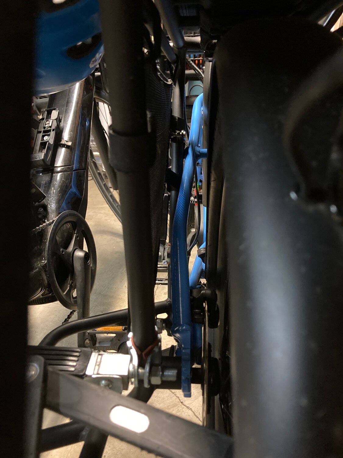

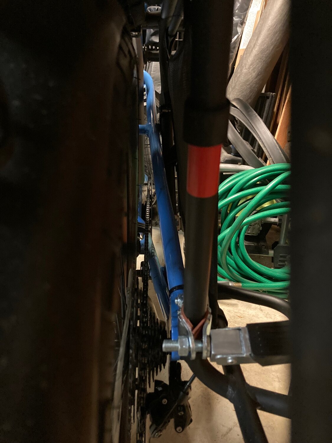

hi there!
I am Nathanael, I am french, and I am the owner of a Benno Boost E 2020 since few months.
I have done 1500km with my bike now and i am using it mainly to go to work or to carry my 2 kids on the back with 2 Yepp seats.
I am quite happy with this bike and it looks robust.
but I am a bit concerned with something I recently realized.
on the rear left triangle, I discovered that it is bent. in contrary, the rear right triangle is straight.
I don t know if it is normal, to let enough space for break system maintenance or if there is an issue with my bike.
I put some pics in attachment.
would you be kind enough to check on your own bike and tell me if you have the same curve on your rear left triangle?
many thanks!

Hi Nathanael,
I like the color of your bike!
I looked at my bike to see if I could help you out, see attached pics.
On left side of our bike with the brake caliper the seatstay is bent. On the right side of our bike with the cassette, the seatstay is straight.
I like your brake system access idea. I've found it more challenging to adjust my brakes on this bike, perhaps the designers saw this coming and wanted to make it easier.

In summary, the clean lines of the boost our broken to clear the wide tires.
I hope this helps you out.

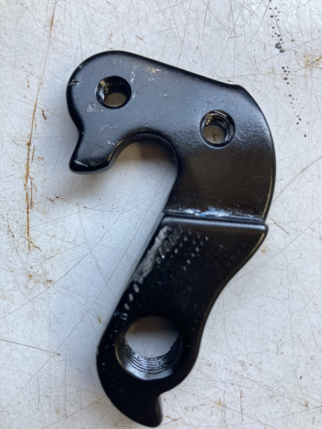

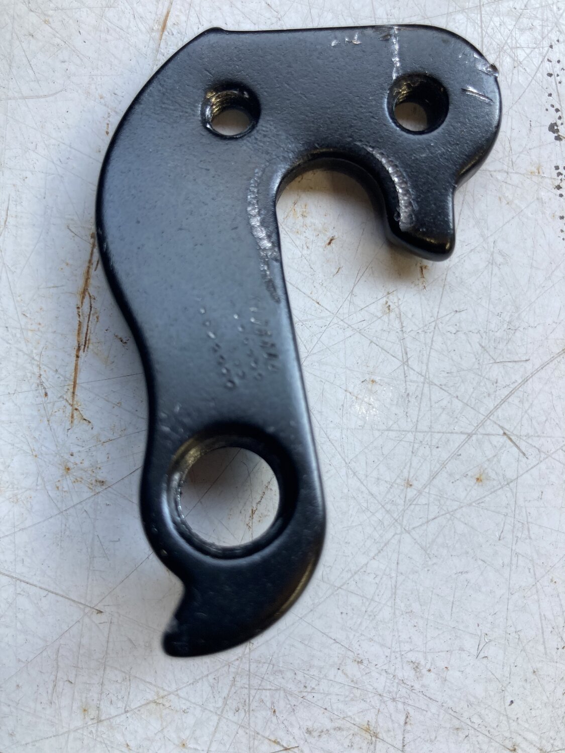

On March 6, 2022, when removing my rear wheel to replace the rear rotor, I had the unfortunate experience of bending my derailleur hanger. I knew this was trouble right away as I sensed this would be a difficult item to track down. I contacted my local bike shop, Propel the next day. I also researched replacements from third parties but could not find a match. That week, I got impatient and bought a derailleur hanger straightener from Parktool. This video made the repair look easy and it was. By the following weekend, I was back on my bike (March 13, 2022). Propel had to order the part from QBP. It has now been 5+ weeks and I have not yet received the derailleur hanger I paid for on March 30, 2022. I'm glad I got the park tool derailleur hanger straightener, 5+ weeks without our benno boost would have been too long. The straightener works and the repair has been durable. Any other stories out there regarding pandemic shopping for bike parts. Hopefully I will receive my new derailleur hanger next week, 1 month after I repaired the bike hanger myself.
