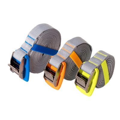

I have the QuikRstuff Mach 2 rack that is pretty much a 1UP rack with no tools needed to install/adjust. My wife's Radcity rear tire fender is made of flimsy plastic and and rack arm over the fender really doesn't hold the 70lbs ebike to my liking. I can adjust the arm stop in-between the tire/fender for better contact; but, the arm stop is lower on the rear tire at the 9 o'clock position.
I have some Bomber tie downs and they are easy to add and secure on any part of the ebike for a little extra peace of mind for emergency stop situations or driving over rough terrain.
6ft/$10, 10ft/$11, & 13ft/$12 lengths and prices:
