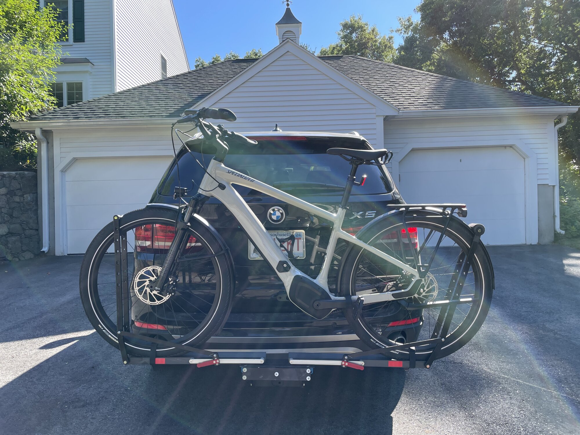

I have the 1Up Dual Super Duty rack. It works fine with my bike's fenders using the adjustable wheel lock feature. They also sell foam fender attachment for the wheel lock.
Im using same rack with foam roller - works great.
