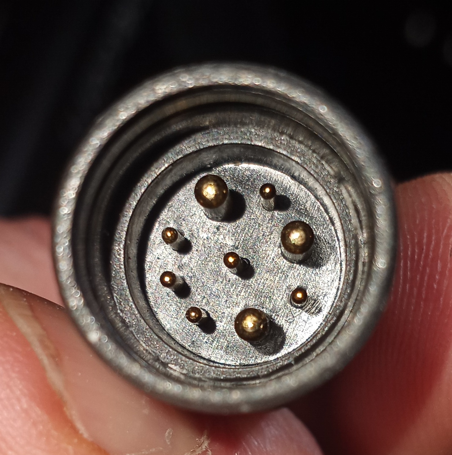

Did the Julet connector that goes from the controller to the motor plug in and work?
I'm worried that Das-Kit changed the connector or the pin configuration of the connector.
This is what my Julet cable connector from my controller to my motor looks like on my Das-Kit powered, ET.CYCLE T1000,..
Yeah just plugged it in and worked fine. The only issue I've run into with the conversion is I can't get it to go over about 24 or 25mph, but that's been good enough for me so I haven't really looked into it much. There's a few settings that need to be set to tell the controller some attributes of the motor. I can get those for you tomorrow if you'd like. The battery, throttle and brake cutoffs will require soldering on new connectors. Easy stuff to solder, but just an FYI.

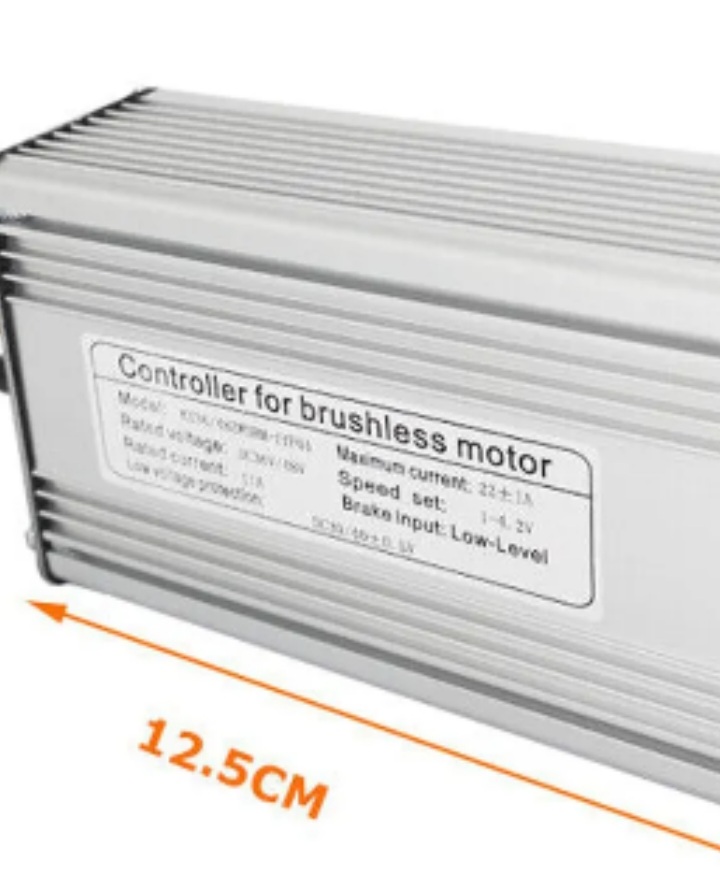

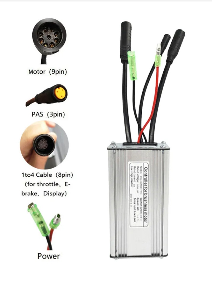

I found this 22 amp controller on ebay that has better pictures than AliExpress.
It looks like it just plugs right in to all the connectors, except the PAS sensor.
The PAS sensor wire on my bike goes directly into the controller with no connector.
It looks like the controller to display connector should plug right in to my display? But I don't know if my display will like being plugged into a KT Controller (I doubt it).
I might be able to use it as a dummy display along with a new KT display to adjust the settings?

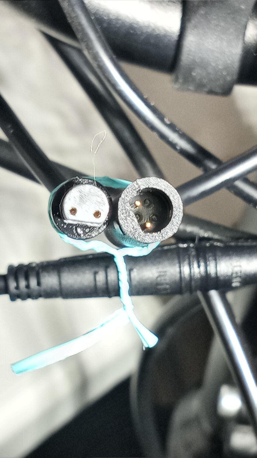

My brake switches are some weird Julet 2 pin connectors and the KT needs a 3 pin HAL sensor connector for the brakes switches.
The throttle connector is the same, but male and females are reversed from the KT (and a lot of other controllers). I think the female side was on the display and the male side was on the controller for the Moscow.
Yes, I installed a twist throttle and had to solder on a connector for it because the connector was reversed.
