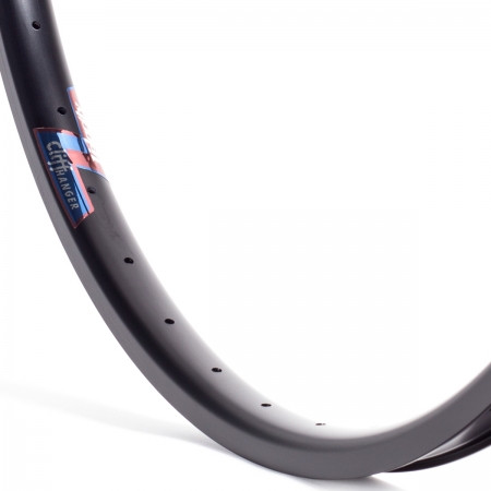

I rebuilt my wheels with 26" Sun Ringle Rhino XL (36h) rims. And have Maxxis Holy Roller's 2.4 mounted.
These wheels are also compatible with rim brakes should you go that route. I have Shimano BR-T4000 rim brakes on my electric Electra Townie with Clark pads and can lock the wheels.
Though in short supply you can find Rhino XL's online.
Another option is Sun Ringle's MTX-33 (though this one is disc only)
And there are Velocity Ciffhanger's - but expensive.

Velocity seems to have 26 inch 36h rims with 30mm and 39mm inner width with the Blunt 35 and Dualie respectively.
Supposedly the Troll can take a 26x3 tire so that tire with the Dualie Rim could be in the future.
