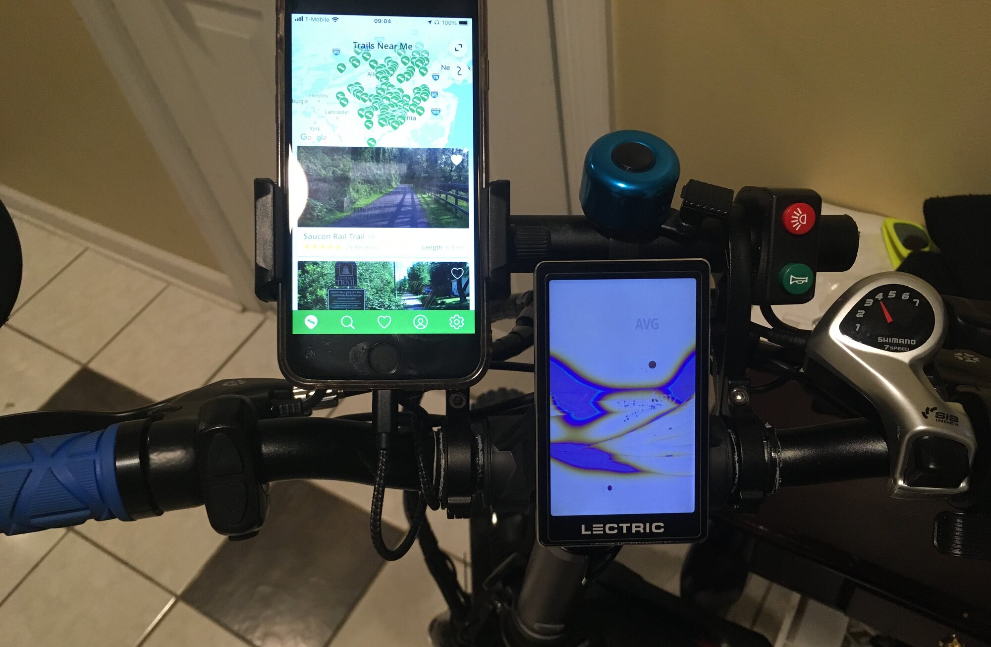

Some time ago, my 1.0 Lectric XP fell over and my display broke. The bike was still usable but as you could see from the picture, the display was useless. I reached out to Lectric and they offered to send me a replacement display for $73.14 (tax and shipping included).

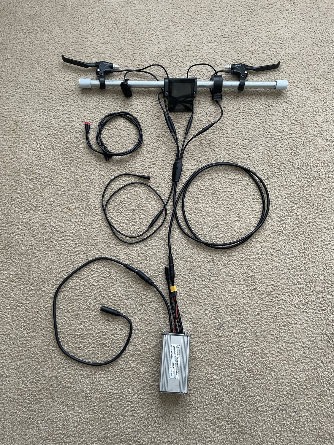

I ordered the below items from KT Ebike Accessories Store at AliExpress totaling $178. So for about $105 more than just a replacement display, I get an upgraded more powerful controller (12/25 Amps) and color display (KTLCD8S).
Total - $178.00

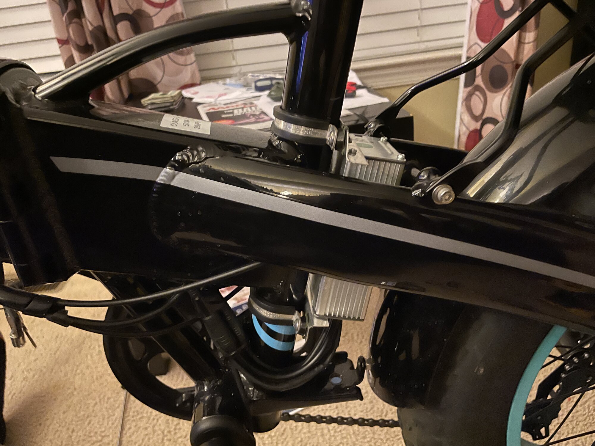

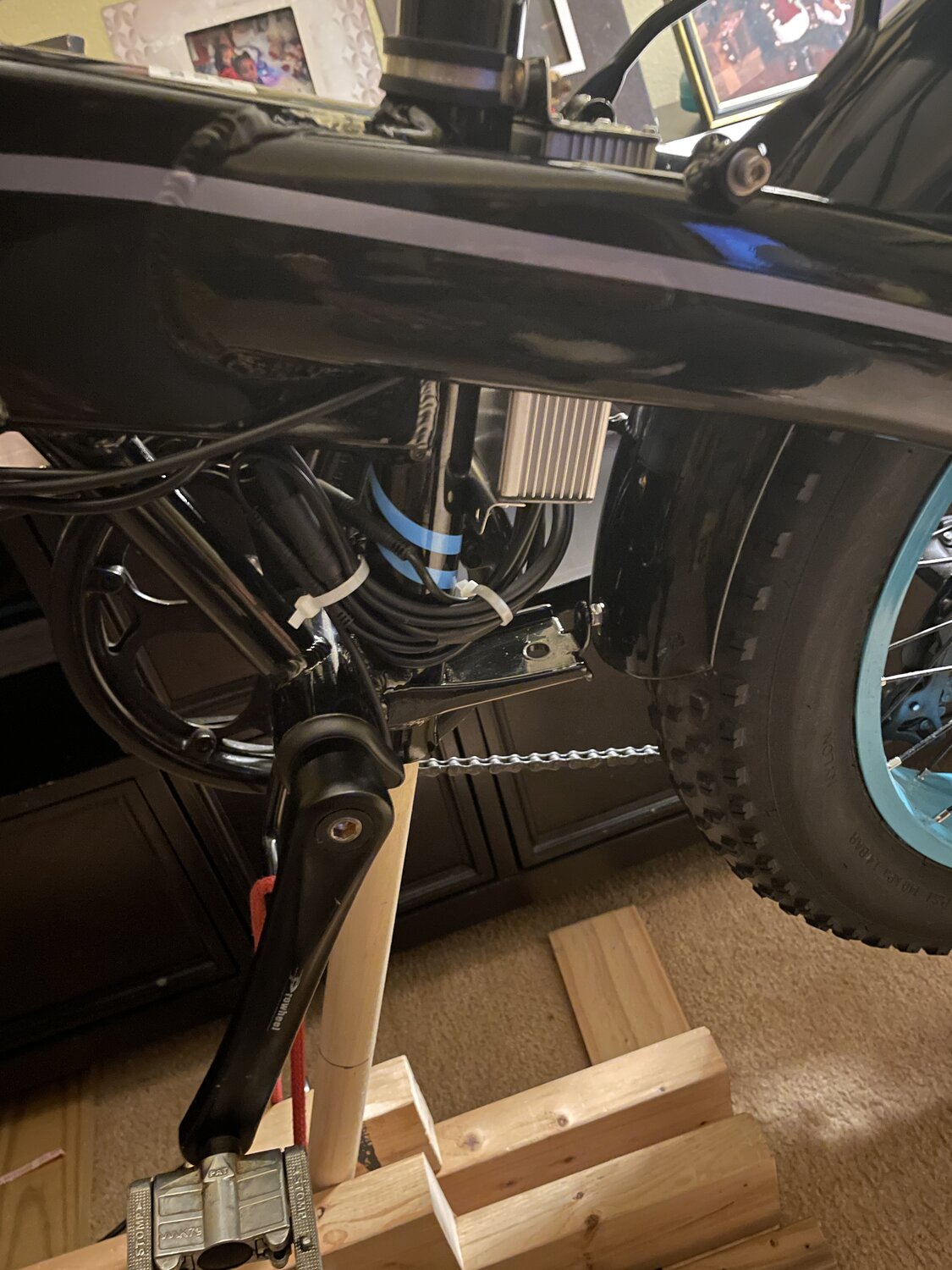

This new controller is physically bigger than the OEM controller so I mounted it behind the seat post. With this controller's ALL waterproof connectors and the 1T5 cable, wiring was MUCH simpler and cleaner. Having the controller out in the air stream also aids in cooling.

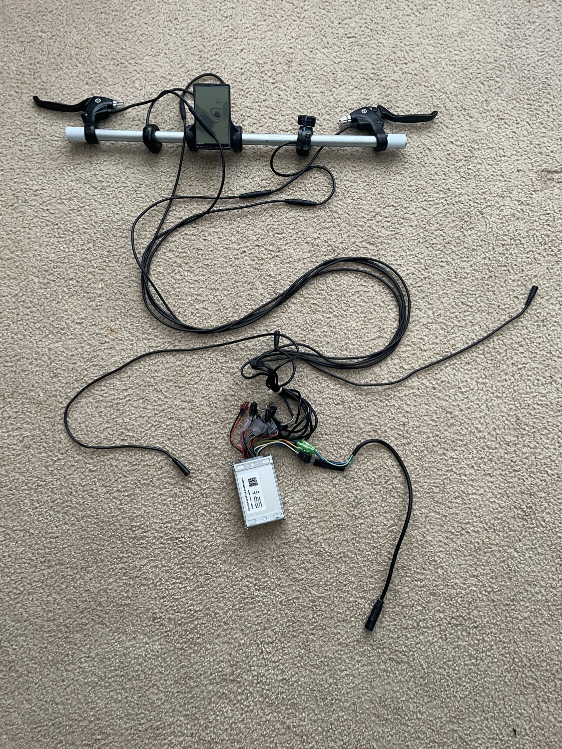

Original controller, cables, display & brake levers (with replaced thumb throttle)
New Controller, cables, display & brake levers.

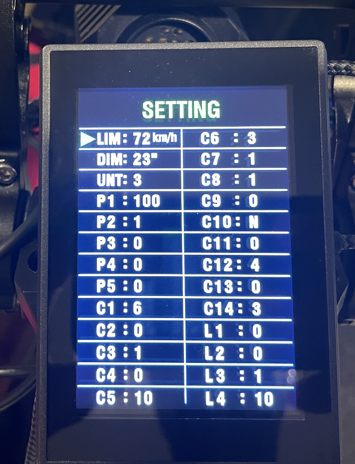

After everything was wired up and tested, I went through a few iterations of controller settings. The below are are my current settings and seem to work well. Note, I had to set the tire size to 23" to get the speed to read correctly.

One thing I hated about the OEM controller was PAS behavior. It was slow to come on and when it did it was "aggressive" even in the lowest setting. While I have C14 set to 3 (Strongest assist), the KT controller PAS enables quicker and is MUCH smoother. NO abrupt “jerk” after a half turn of the pedal. Another caveat with the KT controller is when using throttle only, speed/power is tied to the PAS setting. That is, in PAS 1, your throttle only speed is limited to about 14 MPH. To achieve maximum speed throttle only, you will need to up the PAS level to 5. There may be a way to override this behavior but I have yet to find it, though I haven’t' looked that hard since I'm OK with it.
Here is a better picture of the mounted controller. Simple aluminum angle and cushion clamps.

If you decide to make throttle work full power on any PAS , try setting P3 to 1.
Yup! Changing P3 to 1 allows full power throttle only on any PAS settings.

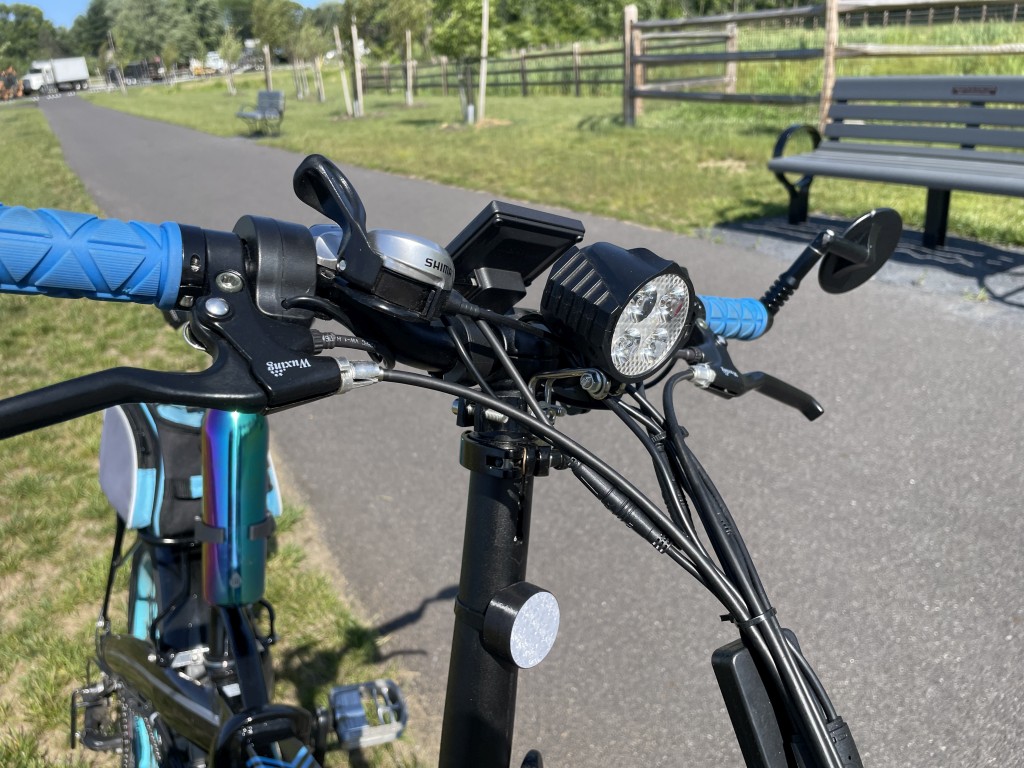

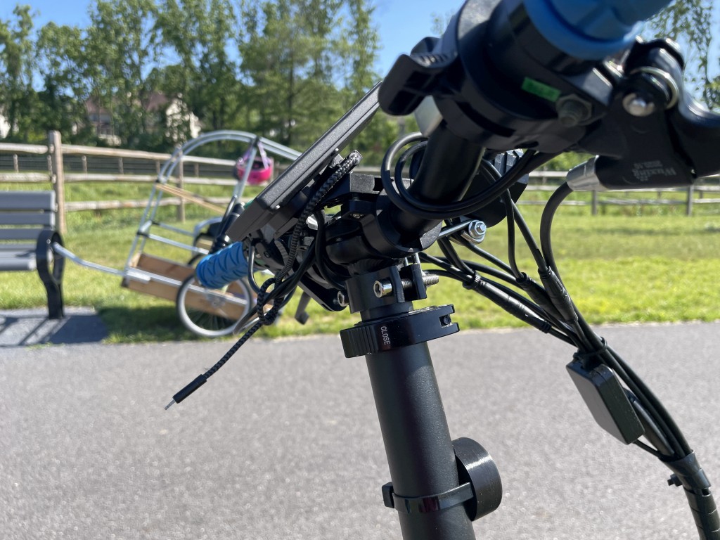

With the updated controller and display with integrated USB port, the 1 T 5 cable allowed me to move the light up high. I had already replaced the crappy OEM light with an LED Light/Horn set that operated from 12-72 volts. With a Handlebar Cycling Clip Clamp, I was able to place the light at the top of the stem.
Ebike E-Bike 12V 24V 36V 48V 60V 72V Electric Bicycle Light/Horn Set
Handlebar M6 Screw Cycling Clip Clamp
