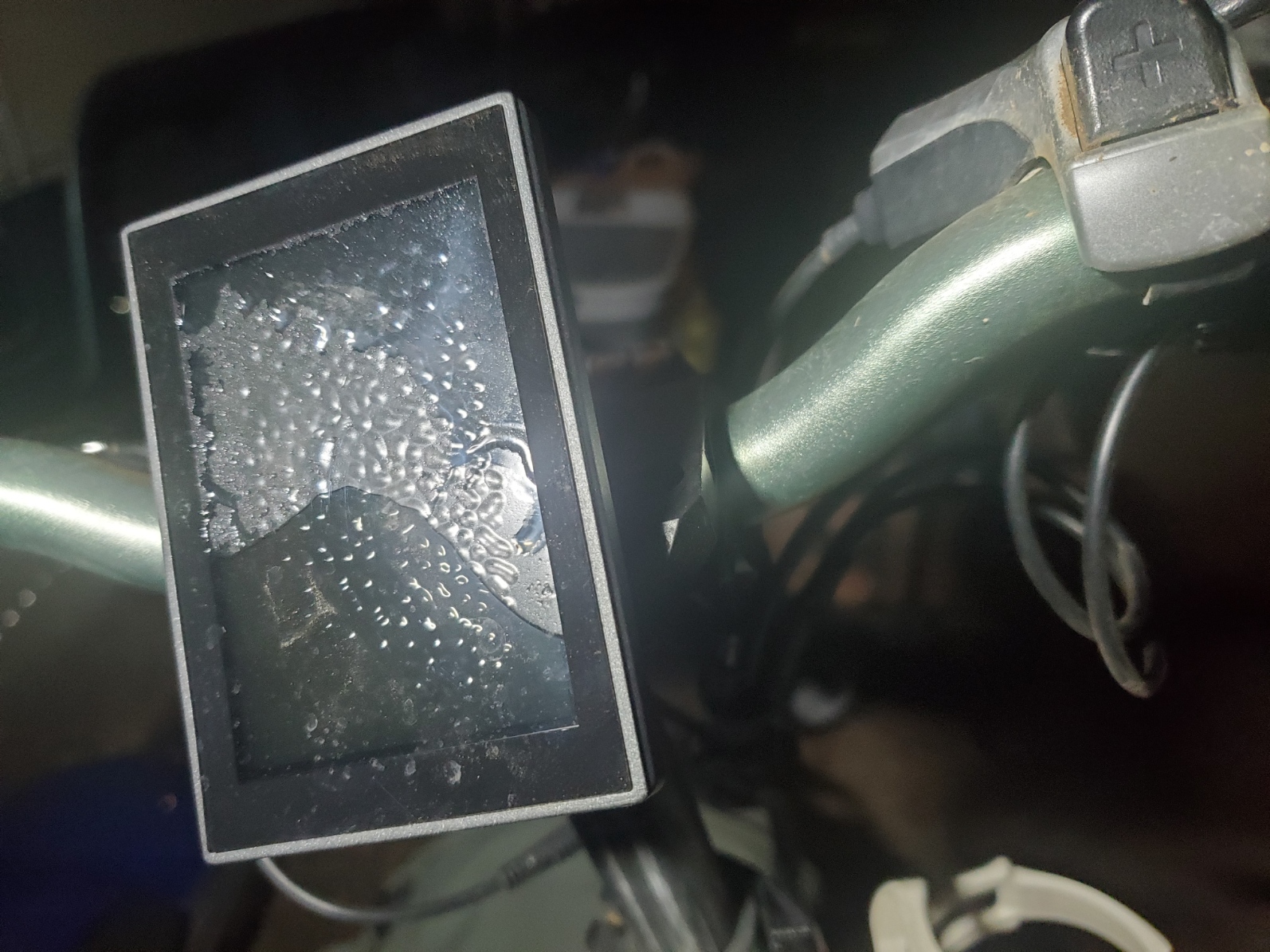

I've had this controller setup for a few months now and we've been using it sporadically. It's been decent, although we've had the controller shut down a few times when using the higher assist levels, maybe because the battery voltage got too low on an older battery. The battery was fully charged, but putting it on P3 to P5 and going to full throttle will usually only last a minute or so before it shuts down. It will usually reset without a problem and work again. We did need to turn the key off once which cuts power to the controller, and then turn it back on to sort of reboot it. I guess keep in mind that the stock Lectric XP controller was designed specifically for this motor and battery combination where this KT controller is sort of a universal one. It's got a higher output so it puts more of a demand on the battery.
Now, however, the controller won't work at all because rains managed to fill the display with water. The screen cover actually curled up on the edges and let water in, which is weird, I don't know why that would happen. There wasn't even a battery IN the bike, so no power to anything. Usually these bikes are stored outside under a waterproof cover, but a bad storm blew the cover off while we were out of town and when we got back, the display was full of water and wouldn't turn on. Also, my bike that still has the OEM display (OEM known to not be waterproof), that was also full of water and wouldn't turn on. So both bikes are broken for now.
We're waiting to see if KT customer service will help us with it since the KT display is supposed to be waterproof.

I've left my bike out in moderate rain a few times with no effect to the controller or display. That must have been some storm. Was BOTH the controller and the display damaged by the storm? Let us know what the folks at KT Ebike say.
w3curtis, thanks for the information on the C4 setting. I was going to ask KT if it were possible to lower the cutoff voltage, and it sounds like it is. I'll have to observe for a while what the voltage is on my OEM Lectric 1.0 bike when I'm low on battery and using the throttle to see if it's a good idea or not to do that on my wife's bike with this KT setup.
And yes, the storms have been bad. It's 'monsoon season' in northern AZ, so sudden high winds and lots of rain on the open plains we're currently on. I can't be sure if the controller is affected or not since the display is dead. My thought is that the controller is probably fine, there hasn't been a battery in the bike since this happened.
And thankfully KT customer support agreed to send us a replacement display, I just have to pay the $10 for shipping. That was nice of them, since I think AliExpress only covers 75 days and it's been a little over 90 days now.
Just as a follow-up, after chatting with KT on I think Facebook, or could have been WhatsApp, they sent me a new KT-LCD8S WP USB display. I had to reprogram the controller, so maybe the settings are stored in the display? But after that it's working great. They stood behind their product so I'm happy.
Also, I rode the bike using throttle only with a fresh charged battery and the controller hasn't shut down so far, so it looks like changing the C4 setting helped with that. I think it was because we were using one of the original aging batteries and the voltage was dropping below 40V.
