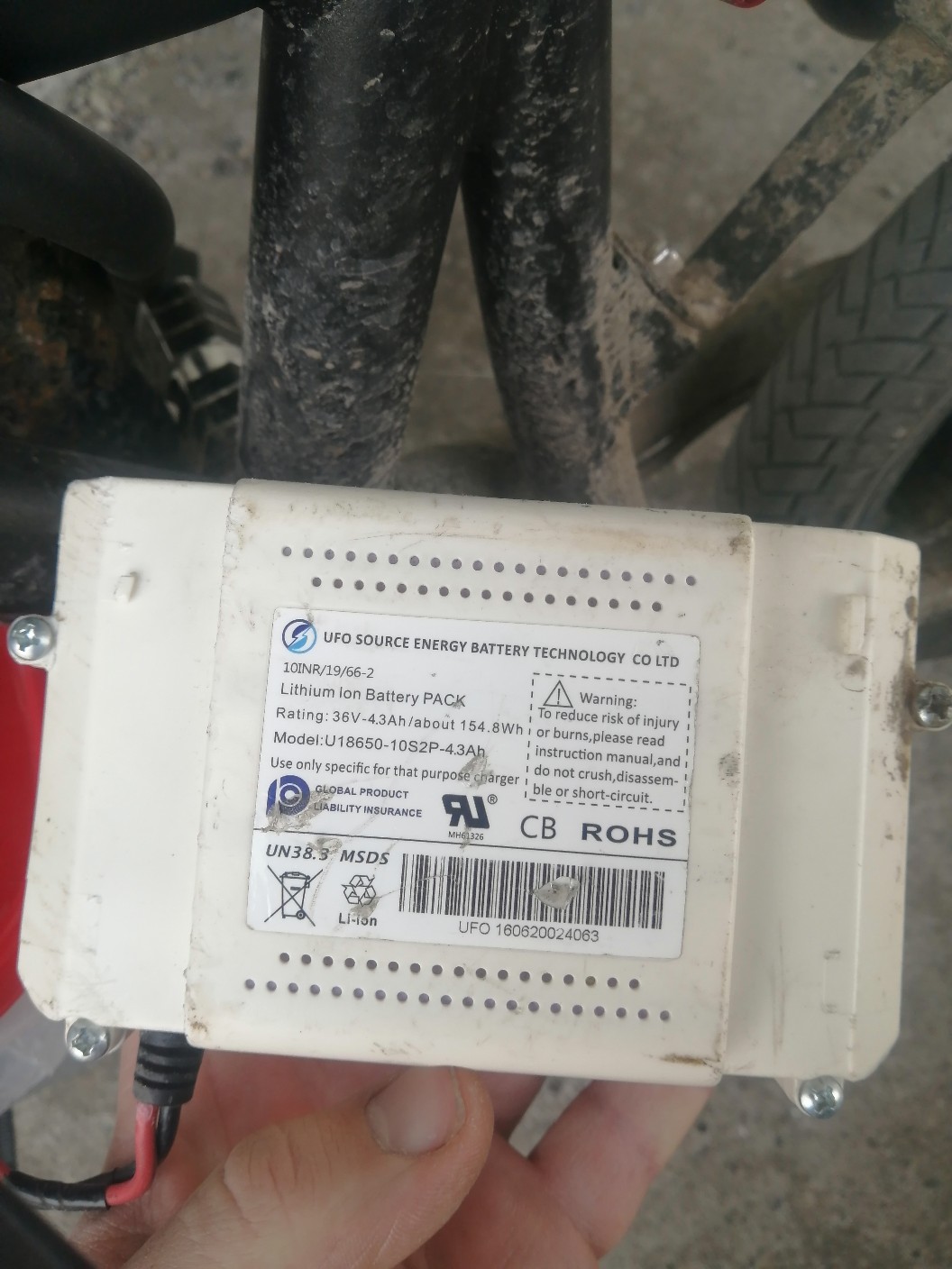

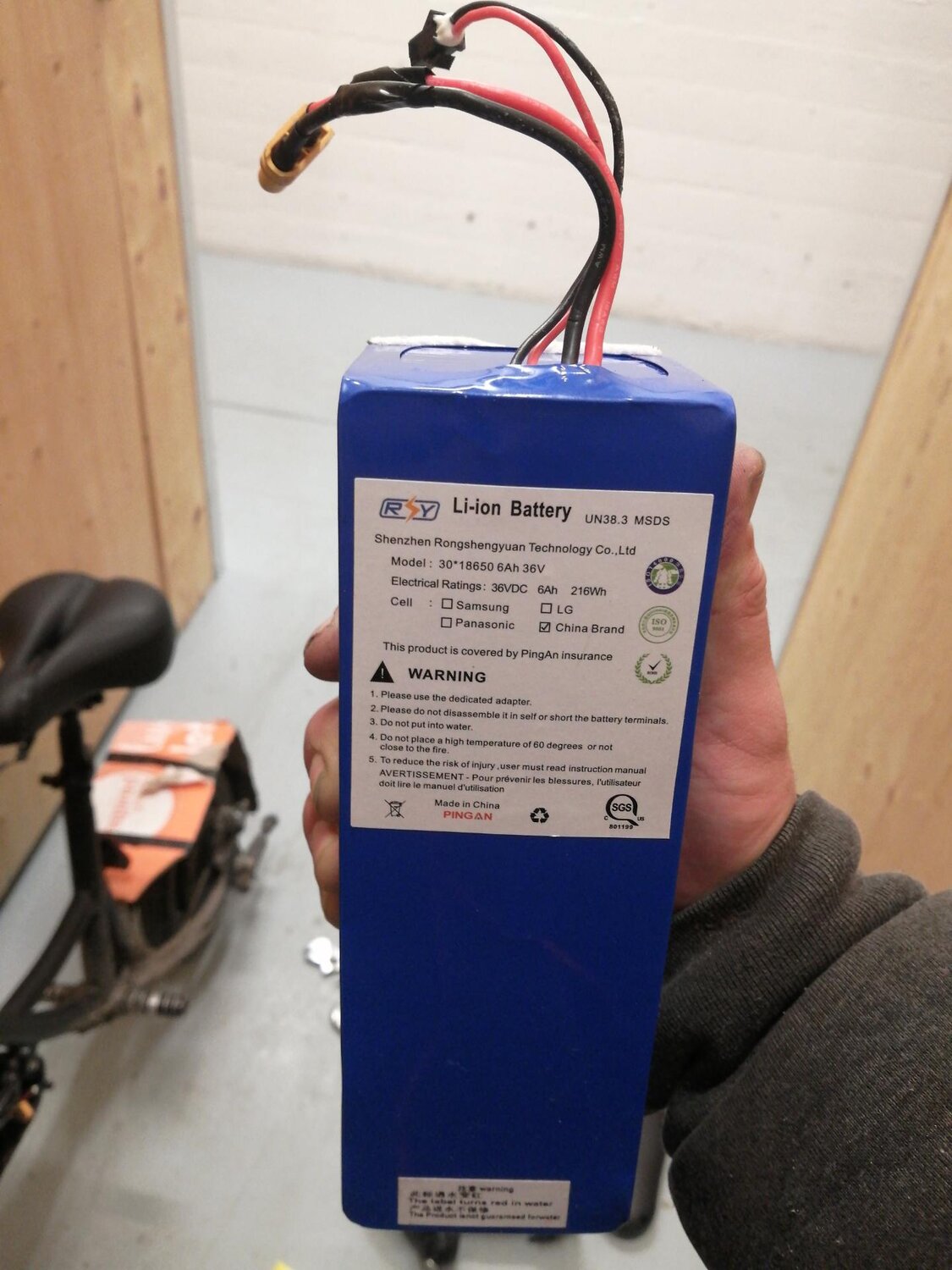

Will a 36 volt 6 ah battery and a 36 volt 4.3 ah battery in parallel on a 350 watt brushless motor will function properly?
I am fairly certain that both batteries have a BMS and protection circuit
They have xt60-u connectors
These are the two batteries I want to combine in parallel.
The batteries likely have different c ratings
Me, I would avoid that set up in parallel. Period.
For safety and reliability you are much better off using one, then the other.
