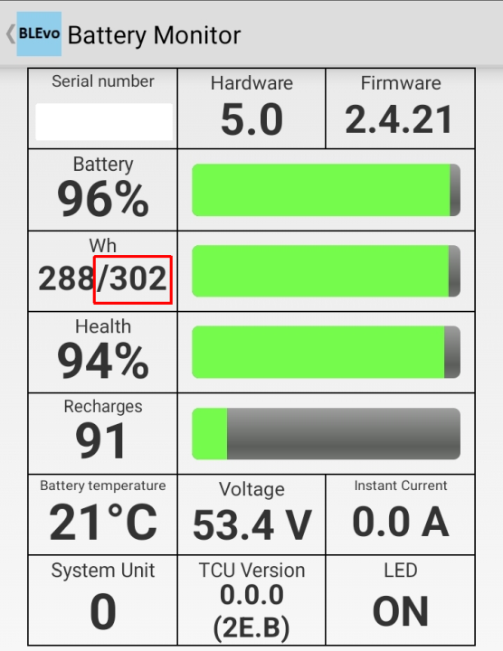

The 100% health figure tells you if the battery is on the expected decline curve. BLEvo is interesting and you need to understand what the actual battery numbers mean or don't mean. It's kind of like when your doctor tells you that you are healthy for your age.
Allan: The user is not interested in if the battery is ageing normally. The user is interested in the actual charge stored in the battery after so and so many charge cycles. The truth is...
The battery that originally was 320 Wh is 302 Wh after just 91 recharge cycles. (I ignore the Battery Health given by BLEvo but the maximum battery charge is a measured value here).
Convince me Allan the Battery Health in Mission Control is not a label but an actual data field.
Ah cool - I was thinking that was suspect - guessing from my own range-o-meter I'd say its about 92%. Aging gracefully, but not 100%.
So interesting - downloaded Blevo and the battery shows 91% (about what I guessed). The bike is a US spec class 3 (45 kph cutoff).
If I save a config in Blevo, will that mess that up? I see where I can change that and the wheel circumference in the app. Is that functional?
It will not. BLEvo cannot affect parameters other than the assistance level settings. Don't worry about Class 3: my big Vado is 45 km/h and BLEvo has never upset my e-bike.
It will take no effect on the e-bike. The wheel circumference only corrects the e-bike data in BLEvo. For instance, the wheel circumference is hard-coded in the firmware of my Vado 6.0 as 2300 mm (it cannot be changed even by the dealer) but the actual figure is 2255 mm. BLEvo reports the correct distance ridden in its own odometer, that's it.
Good info, thank you.
Thanks for that!!!!!!!!!!!!!!!!!!!!! :eek:
"Oh, you're not dead for your age!!!"
