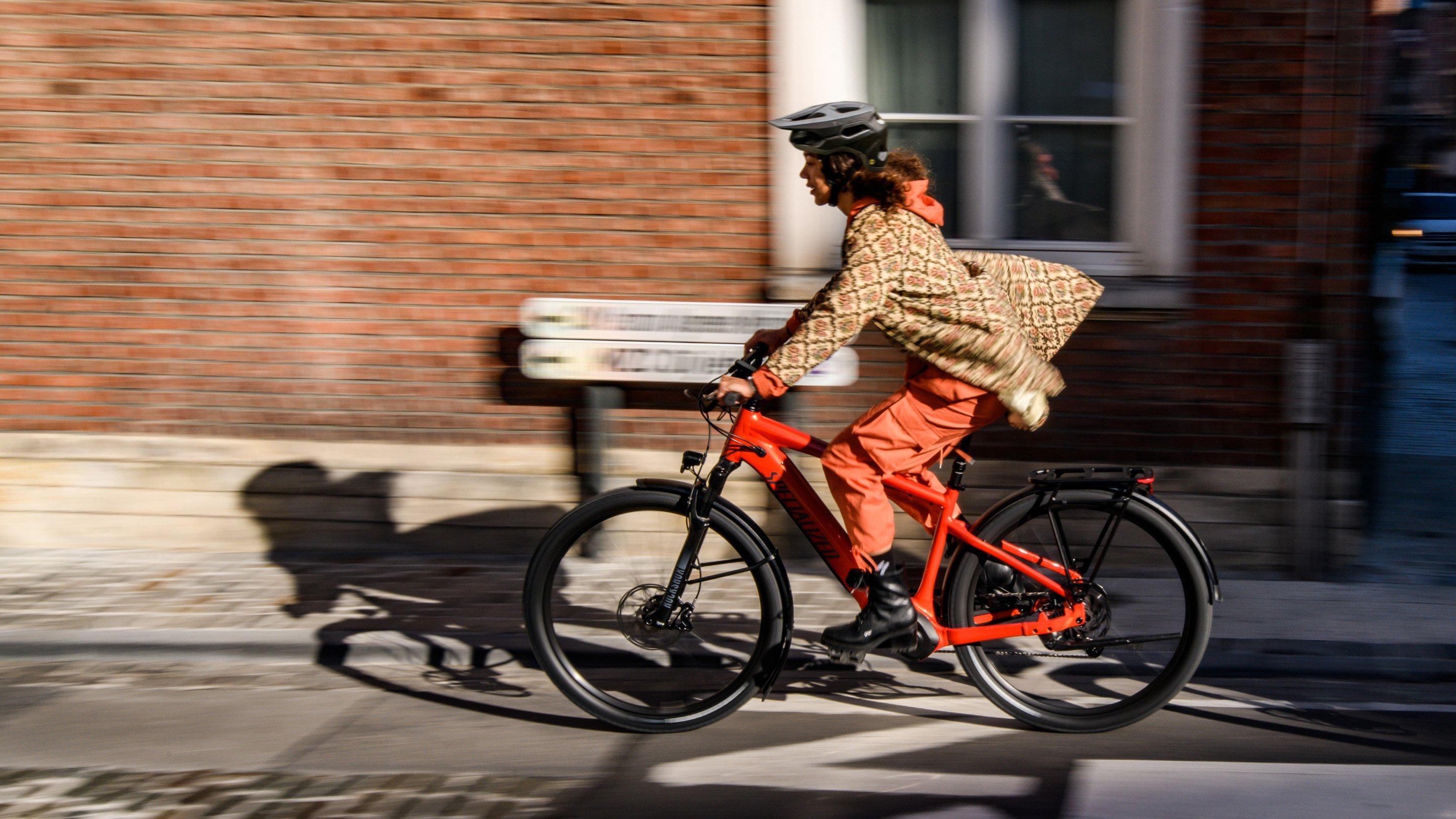

Is this Turbo Tero Equipment Kit a new offering ?
https://www.specialized.com/us/en/t...582?color=335200-205582&searchText=98922-5060
Maximize the capability of your Tero with the Tero Equipment Kit. The kit is designed to complement a non-equipped Tero with racks, fenders, and integrated lights. Turn your Tero into a pack mule, a freight train, or whatever you need for your greatest adventures.
98922-506_CMPNT_TERO-EQ-KIT-BLK_HERO
My Vado 5.0 is outfitted pretty much like the Tero. Looks exactly like the picture and has the 36t chainring. What do you need to know?
