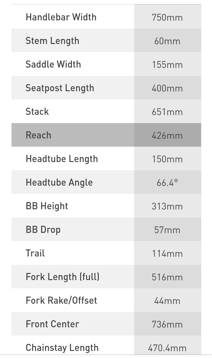

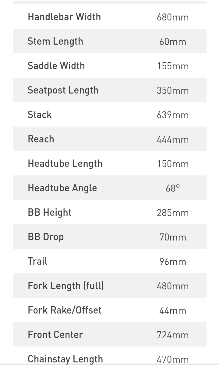

Heat tube angle of the Vado 5.0 per the table is 68 degrees. The head tube angle of the Tera per the table is 66.4 degrees. They will have different steering characteristics. This wolftooth page for their geoshift headset explains the differences:
Frame specific differences (Tero vs Vado):
Headtube angle: 66.4 vs 68 degrees (Tero has a more slack geometry than the Vado)
Reach: 426 vs 444 mm
BB Height: 313 vs 285 mm
BB Drop: 57 vs 70 mm
Trail: 114 vs 96 mm
Front Center: 736 vs 724 mm
Chainstain Lenght: 470.4 vs 470 mm
Frameset specific:
Fork Length: 516 vs 480 mm
Non frameset specific.
Handlebar width: 750 vs 680 mm
Seatpost Length: 400 vs 350 mm
These two frames are very different.
