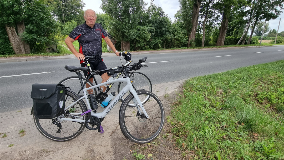

On a 93 km (57.8 mi) leisure ride with my friend, Vado SL. (I always mount the Range Extender for any ride longer than 80 km; it's safe).

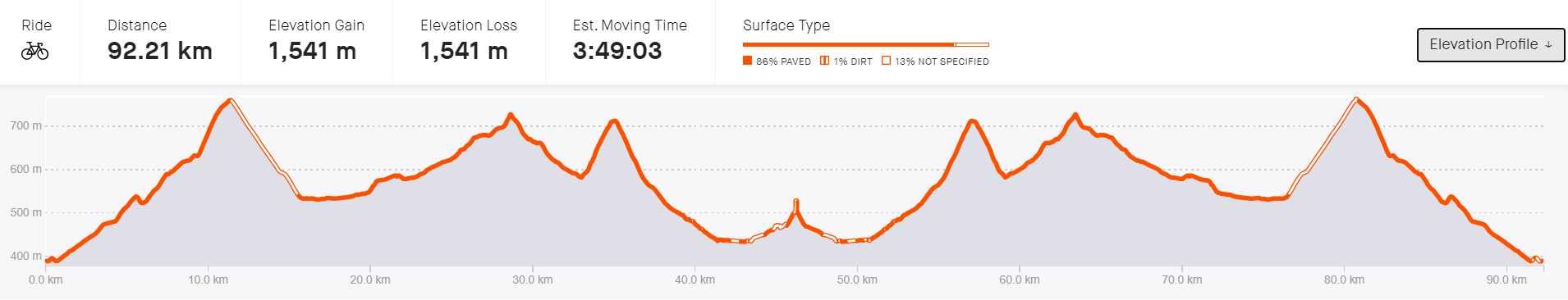

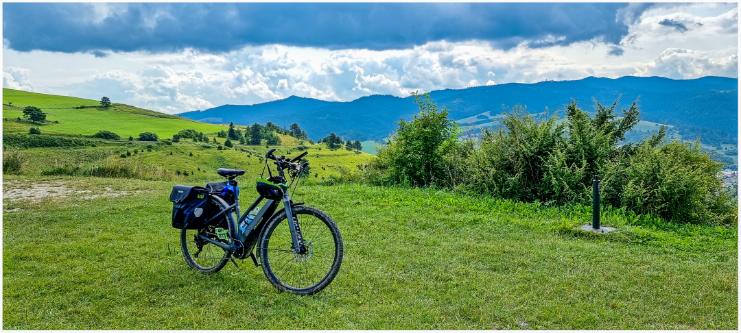

Vado 5.0 on a similar distance ride as above but with 1,500+ m (4500 ft) elevation gain, a mountain ride with 6 steep climbs en route. I always take a spare battery for any ride longer than 80 km, or whenever significant climbing is expected.
This picture clearly demonstrates Vado 5.0 climbing capability. I wouldn't have dared taking Vado SL on such a ride unless I were a totally fit person. Although Vado 5.0 is not Tero 5.0, replacing the chainring for a 38T one made my "big" Vado almost as good as Tero on mountain roads (but Vado is unsuitable for off-road technical singletrack!)

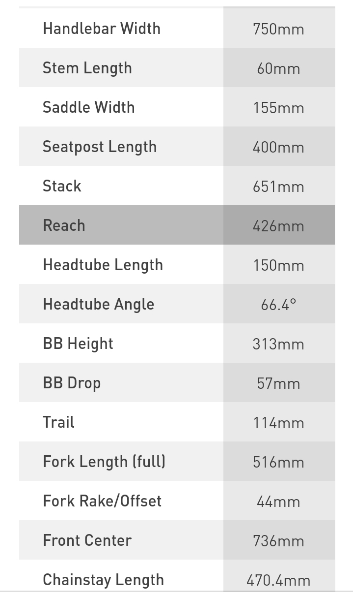

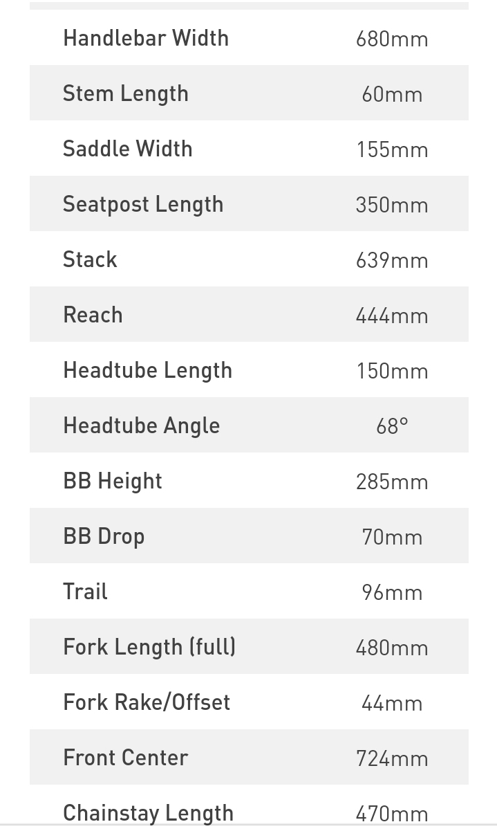

You either took wrong data or don't understand bike geometry Camasonian (sorry to say that).
View attachment 103016View attachment 103017
Tero 5.0 size M and Vado 5.0 size M.
Different Reach, Trail, Head Tube Angle, Trail, BB Drop, etc etc. These are critical parameters making a commuter e-bike of Vado and an XC e-bike of Tero.
It is impossible to fit either 80.mm travel or 110 mm travel fork to the frame of the same geometry!
