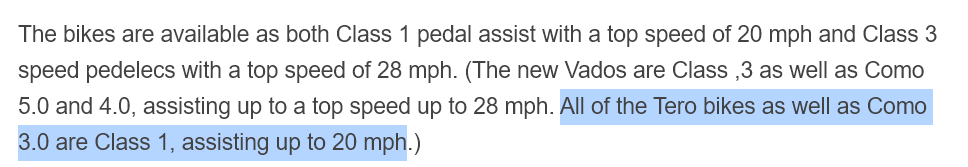

Not sure if mentioned above that Tero is class 1 (20 miles per hour) vs Vado class 3 (28 miles per hour).
please confirm this.
I can't actually find anything on the Specialized US web site that confirms the Tero is Class 1. They definitely say the Vado is Class 3. Well, they at least say it goes up to 28 mph. But nothing on the web site about the Tero. If it is Class 1 then that would be a deal killer for me as a commuter bike.
@Nxkharra is right!
Tero being a class 1 might be a deal breaker for many. Specially commuters.
