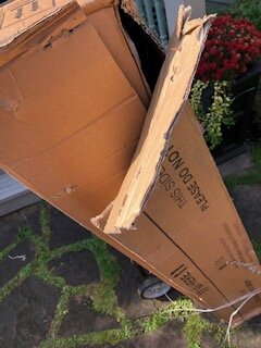

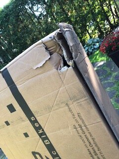

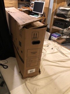

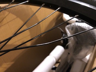

I go my RX today. Unfortunately it was damaged during shipment, although not enough to stop me clocking up 30 Kms.

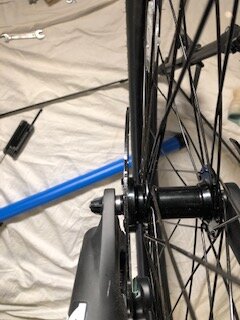

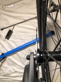

When it arrived, it looked pretty bashed up but as far as I can tell, the only damage is on the front wheel; a bent brake rotor and two bent spokes. A few scratches on the pedals an front wheel. Very frustrating since I've been waiting since mid August for this and shipping seemed very screwed up. But did my best to minimize the rubbing from the bent rotor and bent spokes and had a great ride up and down le Petite Mountain and Mount Royal, then a long sprint along the Lachine canal to Lachine. I touched the from disk a couple of times and it wasn't hot so I don't think the rubbing is too bad. A perfect day for cycling. I also set the levels to 9. I find the motor noisy but I've never owned an electric bike before so not sure what s normal. A comfortable ride and enjoyed burning past people walking on the cycle path by taking to the grass. My derailleur needs some adjustment, it seems to skip gears then jerk into action a little later.
I've sent a message to Rize, I hope they'll just send a new front wheel but I'm not returning this one for now. We have a few more great days of Fall left in Montreal and want to enjoy them to the full.

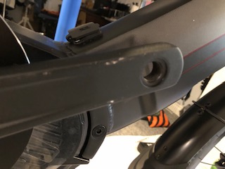

Does anyone know where the serial number is please? I see separate sn's for the forks, seat, battery but don't see anything etched onto the frame
According to a post in the Rize owners FB page, “It's the white barcode you can see lower down on the frame between the motor and the battery.”
Pretty sure I saw one on the bottom of the crank case when I had the upside down trying to get the front tire to not be lopsided. :)

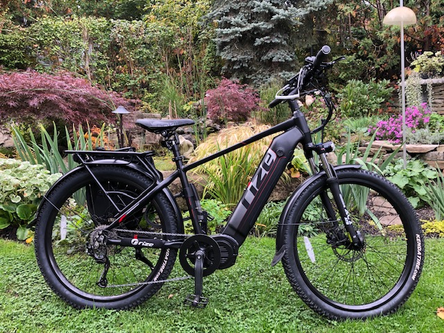

Number two finally arrived. Mostly good shape. The rack was all kinds of bent, derailleur bent, front brake rubbing… got it all sorted out and the test ride was good. Hoping to get one of these out for a longer ride tomorrow and really see how it handles. Just need to argue with the wife to determine who gets which. :) They both look great and I’m kind of grooving on the gloss red. :cool:

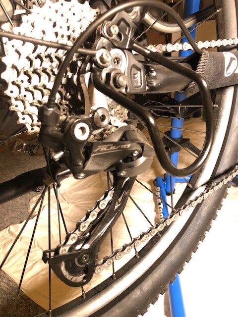

Looks great, they are neat bikes. I managed to do a pretty good job of flattening my bent front rotor, no rubbing now and I think the bent spokes are no problem, I’ll replace them eventually. Shipping seems to be a problem for Rize. Did 40 kms yesterday & 60 kms (70% battery used) today. I keep an eye on power and even battling head winds, slightly up hill, 35 kph and Level 1, it’s only using around 250 watts. I did some tweaking this morning, double checking bolt tightness. trying to adjust the derailleur without much success, I find it a bit rough and skips out of higher gears. Needs more adjustment. I had to add about 5 psi to the tires but I’m now up to 45 psi, I think I’ll go to 50psi for mainly bike path rides. Still find the motor a bit noisy but maybe normal.

As far as the derailleur adjustment, when the bike is in 9th gear (or whatever your top gear is) get a visual from the rear. Your derailleur should be directly in line with the gear selected. That's where I start anyway.
If the derailleur was bent when you got it, check out the hanger it bolts on to (small aluminum piece). They'll often bend when the derailleur does. If this is bent, it may be rubbing (or very close to rubbing) on your top gear. That's a SURE sign it's bent! If it's bent, even if nothing is rubbing, it can be very difficult to adjust so your derailleur shift cleanly through it's entire range.
If you need to straighten that little hangar bracket, do so VERY carefully! Your bike will be down a while if you break it, as they are unique to the bike frame. I have no idea why that part isn't standardized, but it's not.
Do these new bikes not come with a heavy wire guard protecting the derailleur in case of a tip over or something? They used to, and I'm not seeing it in the pic above.... -Al
Thanks. It may still be a little out of whack, but it’s not miss shifting at least. And no. I had no kind of covers on the derailleurs.
On the second bike, the piece of wood that’s nailed/stapled to the block for the front fork was completely off and under the rear tire. How the hell that happened, I haven‘t a clue. I did check the tire for punctures just in case.
I take that back. i believe there was a foam block next to the derailleur, but I’m pretty sure they weren’t in the proper place anymore. The chain was also off the front sprocket, but I would assume that happens often. Hell… I’m just happy it finally showed up! :)
I think AHicks means this bend U shaped piece that sticks out then turns down to protect the derailleur. It was attached correctly when I got mine. I think they are on all these bikes.
I've been fiddling with the derailleur adjustment for a couple of hours, certainly is fiddly. In the higher gears mine was moving correctly then a little later going back again. I think I have finally got it to go through all the gears and stay on the bike stand but haven't road tested it yet.
On the bold, yes, exactly! I don't see one of those on Acurione's bike above?
As far as adjusting the derailleur, once done initially they're usually pretty easy to set up. Sometimes though, it may help to watch one of the many Youtube videos on the topic. No point rushing here. A well done derailleur is a treat to use every time you use it. Not so well done, and they can make the bike a PIA to ride.....
Even the RX on the Rize web site doesnt show one, seems like a good idea, but on the other hand, I’ve ridden a non electric bike for more than twenty years and never damaged the derailleur, not sure why in feel I need one on an eBike. In fact I’ve never even had to tweak the derailleur on my old bike, it has just worked perfectly since I bought the bike. I’ve seen some of the YouTube explanation, agree they are very good.
