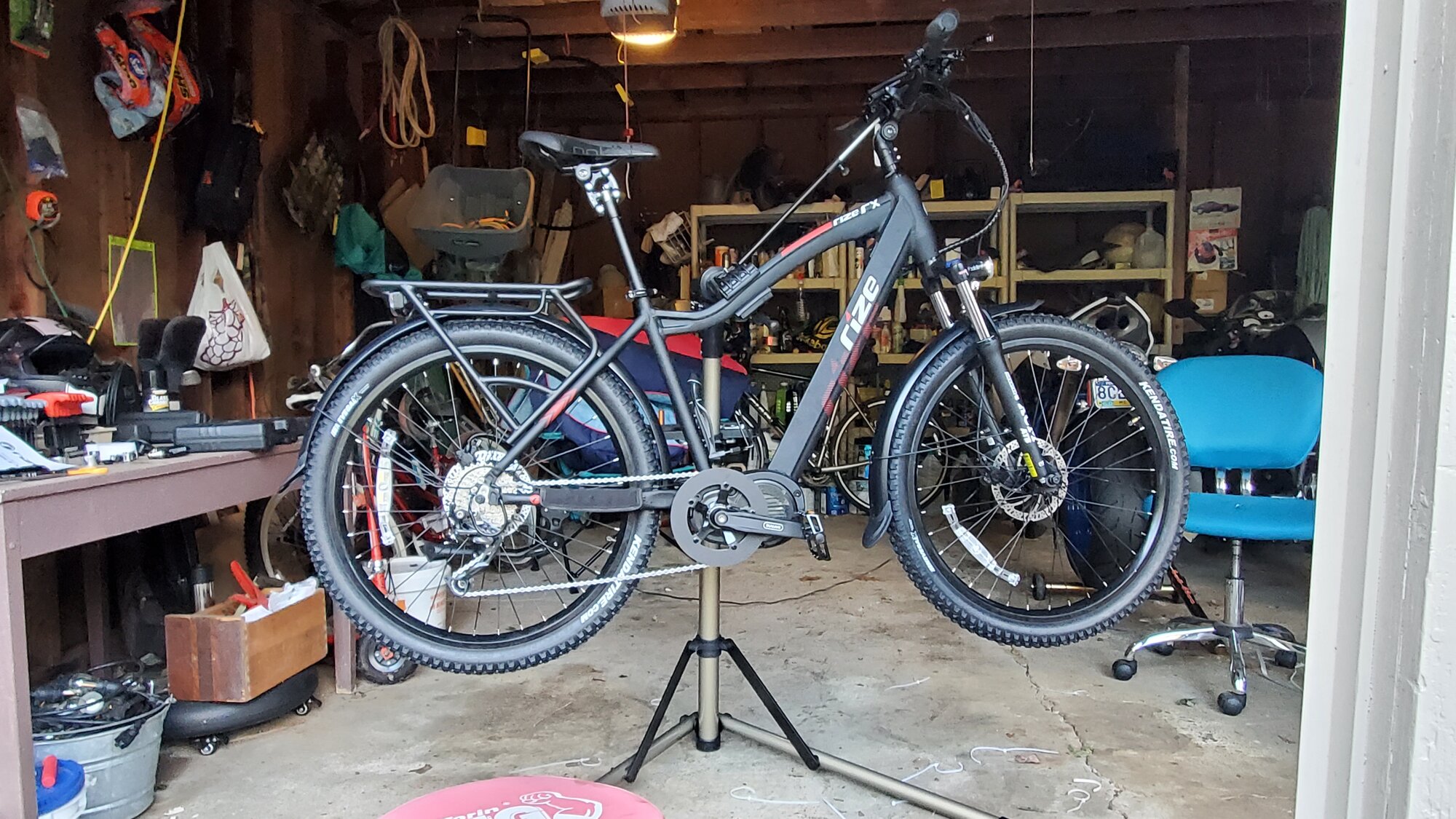

My RX arrived this afternoon. Was able to put it together and take about a 5 mile shakedown cruise. Bike looks good, shifts and functions well in all gears. Build quality seems pretty good. Took the time to 'bed' my brakes. Need to do some final adjustments and check all the torque settings and bolts before a longer ride as well as put on the fender and other small thingies. Did hit 28mph without pedal and 30+ with pedal on a battery at roughly 55% capacity.

Couldn't figure out how to post an image and text. Here is my RX just before inaugural ride. Excuse my messy garage, it's a work in progress.
That's a fine looking machine there. I had to loosen some nuts and some bolts and tighten some. Front wheel was way over tight. Loosened the nuts and it glides great. Check crank. Check rack bolts too.

Front brake rotor rubbed on the stand when I spun the wheel. Found a quick video on adjusting: Loosen two 5mm mounting bolts on the caliper, spin wheel, squeeze brake very hard and hold it while retightening the mounting bolts. May have to do a few times to get mm perfect - which I did. Went from a rub that slowed the wheel to a stop, to free-spinning with no friction in a matter of 45 seconds. Love YouTube for the quick fixes.
Also, I had to adjust the derailleur so that it was smooth in all the gears. Having it up on the stand made this an easy and quick fix, as well. Just turn the little knurled knob on end of the cable heading into the derailleur as you move through the gears. I just listened until I achieved the least drive-train clatter in all gears as I turned the pedals.

Yes the stand is real nice. Did you have it or did you get it fir the rize bike?
Bought it on Amazon in anticipation of getting the RX for $89. Holds bike steady, and has an arm to lock the handlebars from flopping/moving, also. Rated to 60lbs, so I intend to only put bike on it sans battery. Made it very easy to build and tune the bike. Has a nice tool tray mounted on the back, and you can articulate the clamp holding the bike 360 degrees, so you could rotisserie the bike if needed.

Nice bike.
A little trick that I learned from the chief mechanic when I worked in the bike department of a sporting goods store. We found that we’d often damage decals or paint when bikes were clamped in the tuning stands, even with padded jaws.
Hank was an older Dutch gent who was trained in the Netherlands; actually attended a technical college to certify as a bike mechanic. Hank taught us to raise the seat up and clamp onto the seat post. Mostly chromed steel or straight aluminium in those days but problem solved. Not sure how this will work with anodized seat posts but one could likely find a cheap steel one to pop in when using the stand.
