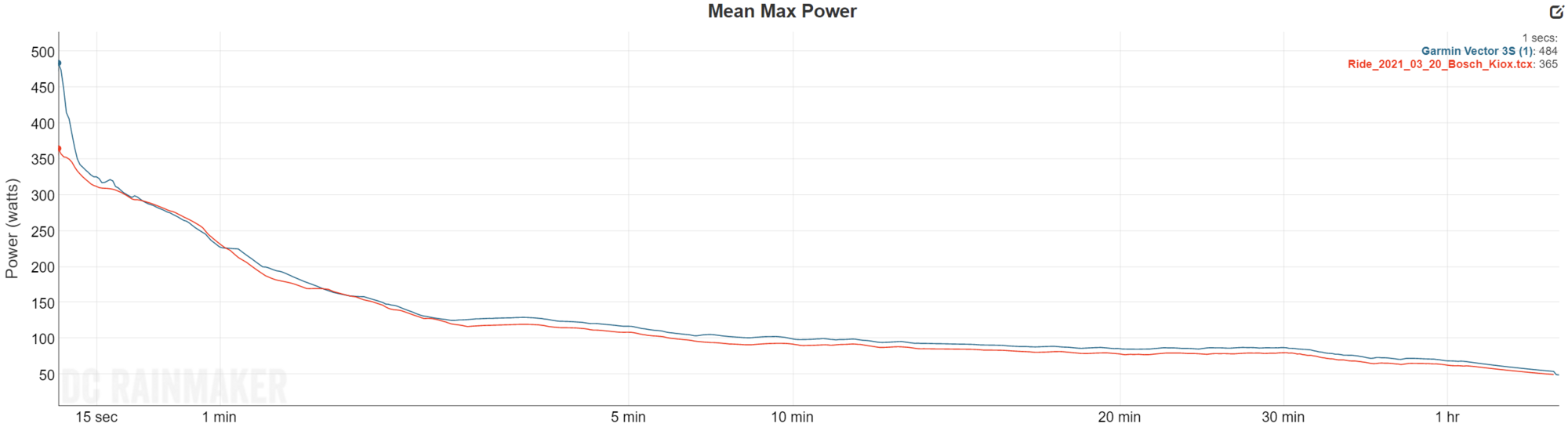

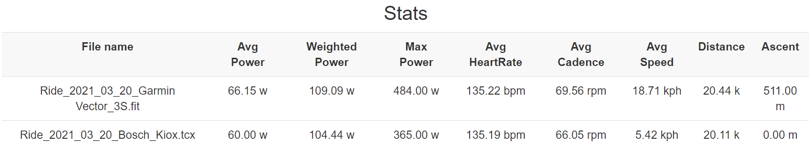

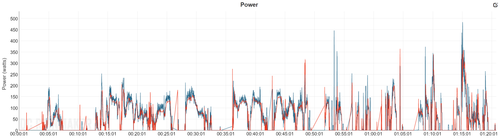

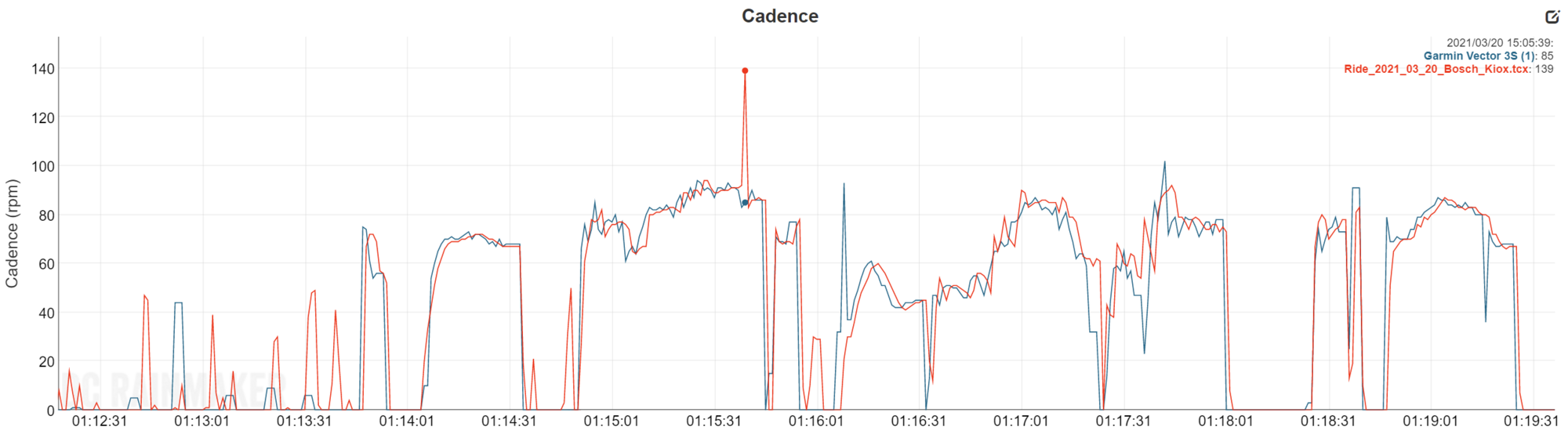

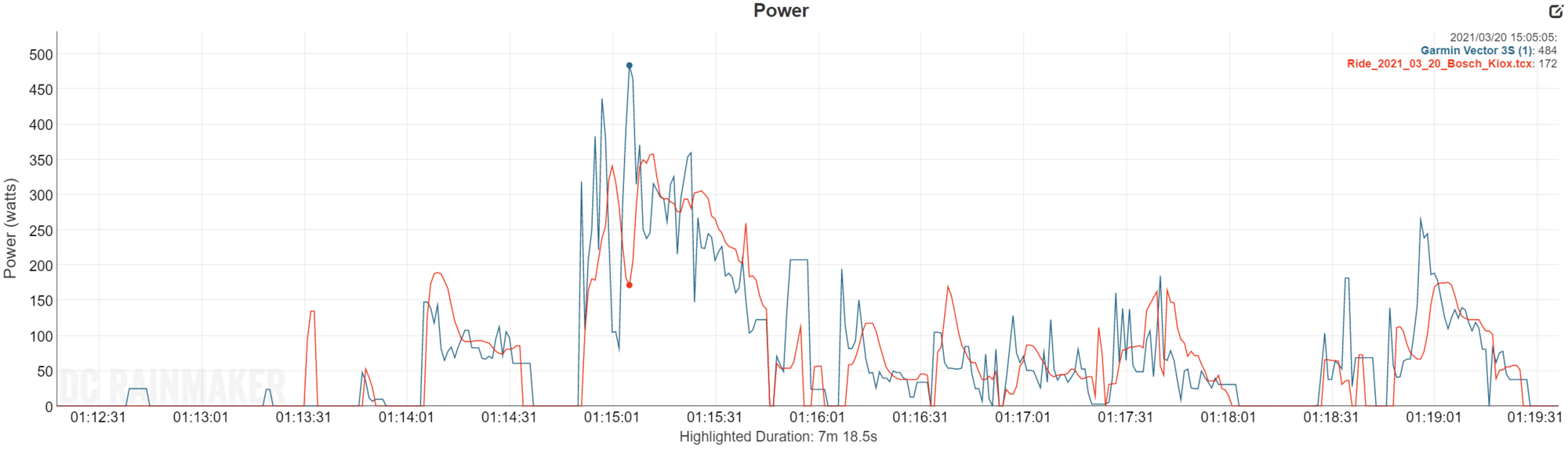

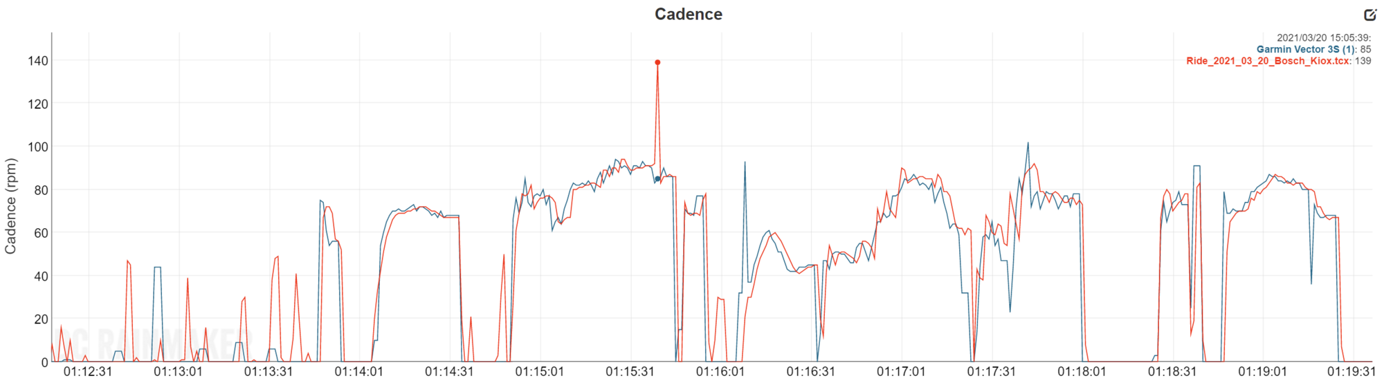

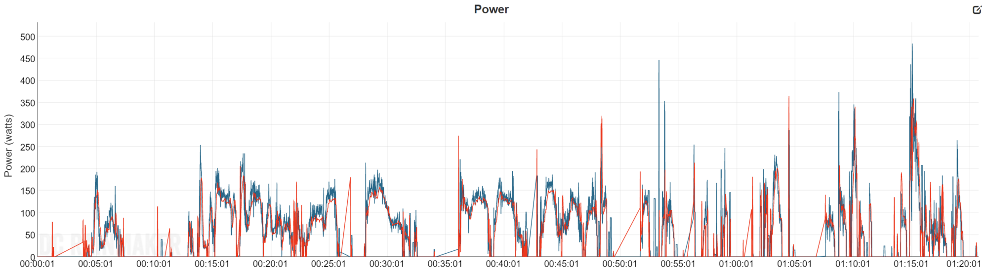

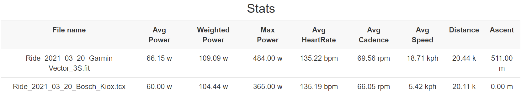

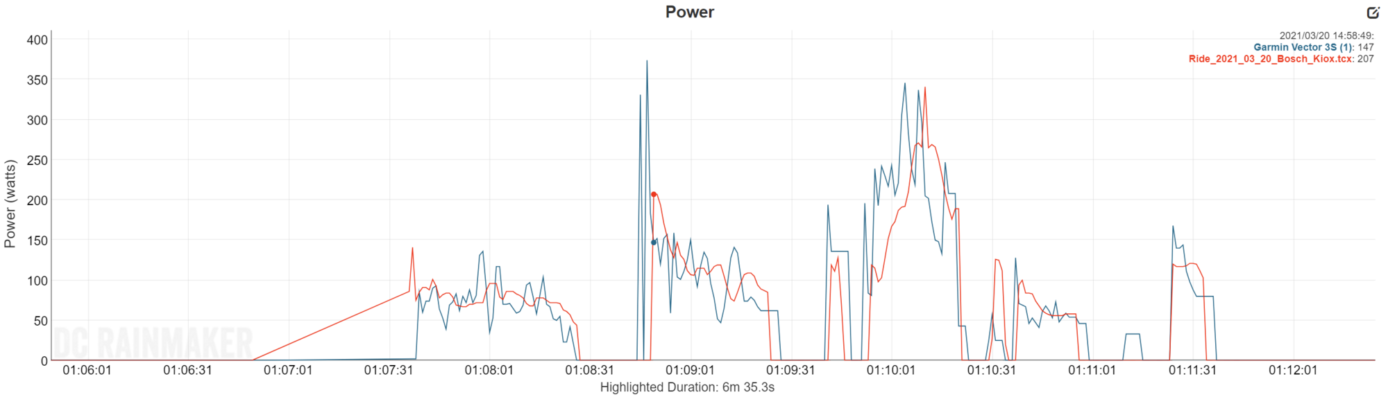

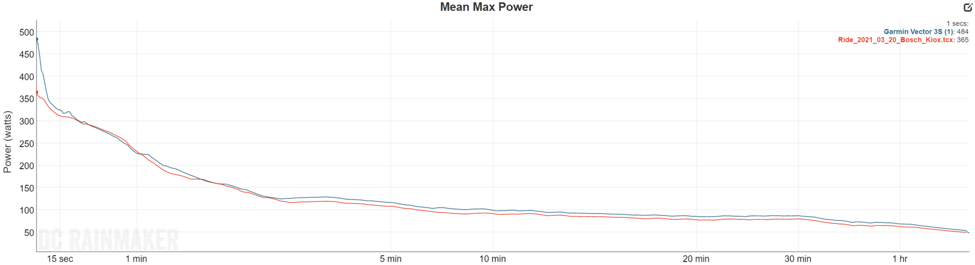

I uploaded both sets of files to DC Rainmaker's analysis tool and there are indeed very large differences in the power data. The Kiox file is TCX format and the Garmin data was captured by a Hammerhead Karoo 2 in BLE mode as a FIT file. At first glance it looks like Bosch samples less frequently, but I'm not at all certain about that. Cadence data looks pretty good, though. There's some kind of issue with the speed data, maybe something to do with KPH vs MPH and a failed conversion somewhere. Public link is https://analyze.dcrainmaker.com/#/public/aecfba23-e458-4eda-606a-6a3fc59534fe, but I'm not certain how long that will work with a day pass.
Screen caps are attached, and I have also attached the cadence, speed, and power data in CSV format.
TLDR: @Johnny is right that the Kiox power data is useful only for a relative measure against yourself.

Unfortunately this confirms that the data is useful only for self assessment/relative measurements. At lower power outputs and when the output does not vary too much, it seems somewhat accurate, like %10 still not good but ok, anything else it is not.
This also explains my troubles. Varying between high and lows is completely off. For example 1:09 - 1:10 in your second graph, it completely missed some high outputs, averaged the rest etc.

The average power and weighted average power numbers actually don't seem that far off. I agree that there is a discrepancy, but it's not massive.

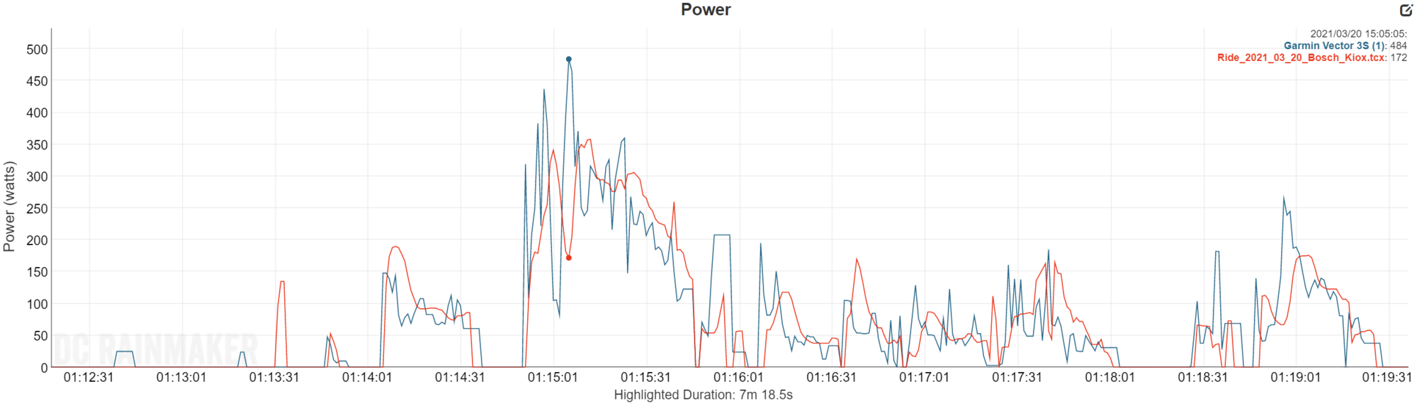

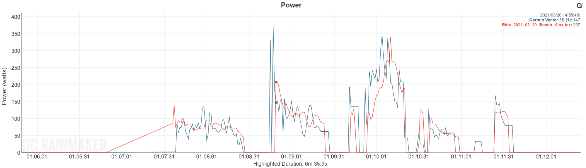

It IS at times massive. The sudden highs are almost completely missed by a huge margin(even the rider's max is 484W vs 365 from kiox). 50Pmassive.JPGmassive2.JPGmassiveHigh.JPG
46 vs 30W, 71W vs 26W , 123W vs 205W, and these are from intervals ranging from 6 minutes to 15 seconds. All of these are long enough intervals, a good power meter should track in the range of %1-3 accuracy.
If one changes the effort level between high and low in short periods (like 5 second pushing hard then 5 seconds rest etc.) I expect this to lead to a huge difference overall(which I have experienced)!
On the other hand average power looks usable for everyday riders(still %10 difference) if the rider keeps its power stable for prolonged periods(no frequent starting/stopping etc.).
This is 96W vs 87W, around %10 which is fine.
As @ubt mentioned several things maybe the cause. The sampling rate maybe low. It is possible that the torque sensor output is too noisy so a short term averaging maybe applied. There also seems to be a delay when one starts and stops pedaling.
