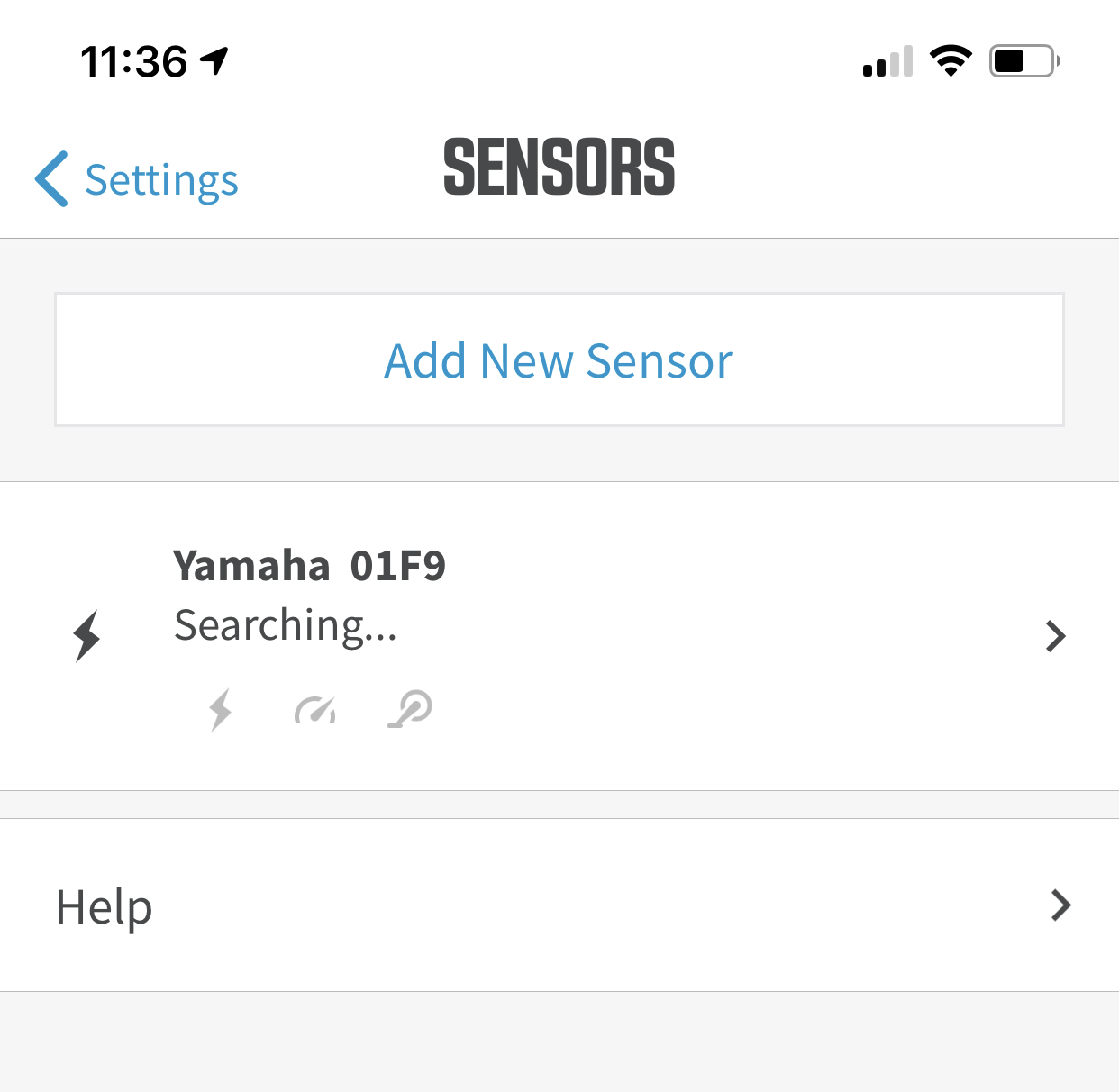

I don't know how much has changed on the Civante vs the older bikes but...the bluetooth communication seemed lacking and it was not clear what apps could be used to read the cadence and power data. I've only played around with it very minimally and out of the 10 or so that I tried, only the Wahoo app seemed to read it. But I've not played with it on an actual ride. 🤓
RTG Cycling also reads the Power. I’ve used the Civante on Wahoo, Zwift, Rouvy, Ride with GPS, to name a few
Hey Oski, can you talk a little about the connectivity stuff re the Wahoo or RWGPS? This has sort of gotten past me but it sounds interesting. Pretend you’re talking to an idiot.
LoL Dave, I’m new to it too but basically Wahoo and RWGPS are like the bike computer (Display X) that we have on our bikes. But, Wahoo, RWGPS and Kamoot add a Navigation component (using either an app on your phone or a Garmin/Wahoo device) that you can mount on your bike. They’re not just for Navigation, they also give you data that our Display X isn’t giving us (like elevation gain, avg heart rate, calories burned). Apps like Rouvy and Zwift add a gaming component to riding a bike. Rouvy tracks my ride but on the display it shows me pedaling in some carton world on my phone. You can compete on Zwift with riders from all over the world. It really is a complicated set of phone apps and devices. Some apps don’t register the Power transmission on my ebike while others do. Some include heart rate data, while others don’t. I know I’m making it sound confusing and that’s because they all overlap now a days. Some apps like Strava used to just track your rides. Now it also lets you plan rides like Kamoot does. Rouvy actually lets you go on a virtual ride of some (maybe all) of the Tour de France stages. I like that better because it’s not a cartoon. They actually use real Google Maps-like footage so it feels more real on my big screen 4K TV. What do you specifically want to know Dave? The picture is of the Wahoo app on my phone (just for you to see)

I didn't write the question very well. I've been on RWGPS for several years, used as my bike computer on my iPhone. I'm buying a Wahoo Roam currently for this year to see how that stacks up against the iPhone, and this discussion of feeding data from the Civante to these things caught my eye. That's the part I haven't waded into yet.
However, looking at your answer, I wandered into the other side of the basement where my Civante is sadly waiting out the winter, turned it on, and played with the Sensors setting I found in RWGPS, and lo and behold, I see that I can get the cadence from the bike onto my computer screen, so that's great. I need to learn some more about getting power numbers onto the Wahoo and what is involved with that.
I've been happy with the iPhone's implementation of RWGPS, especially the mapping, the smoothness of the map rendering and the excellent voice nav cues. It seems like some of that will go away with a Roam or Karoo, but on the other hand I will gain gradient as a metric, which I cannot get on the phone, and that is a biggie for me. Much better battery life and the phone can just go in the handlebar bag where it belongs.
Always fun playing with the technical stuff! Thanks for the response. I cannot wait to get that bike back in business again fairly soon now.
