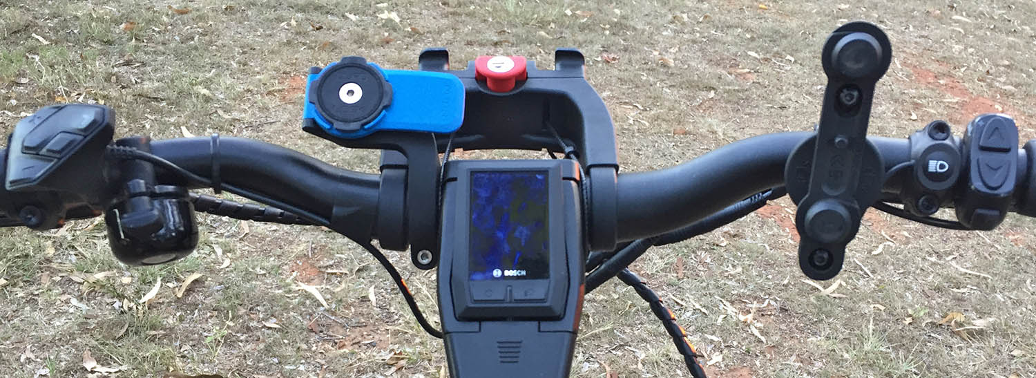

What are the brands and of handle bar accessories that you have around your Kiox? I just bought a Homage and am trying to figure out the best water bottle, phone and possibly front bag. I looked an ortlieb bag yesterday and the bracket did not look wide enough to go around the kiox display. I like your setup but didn't your accessories when I was originally at the bike store. Your thoughts would be extremely helpful.

What are the brands and of handle bar accessories that you have around your Kiox?.
I was wondering what kind of mount you have for your handlebar bag? .
Marc & Brooklyn Boy…
Starting with the most obvious…
  • Fidlock water bottle (shown removed) which has a magnetic mount: twist slightly clockwise to remove; hold close to the connector to have it 'grabbed' firmly into stowed position. I've found this superior to handlebar-mounted cages and the Fabric stub system (on Delite & Charger) which must be pushed down to secure with this action resulting in the mount twisting around the handlebar.
    Caution: Fidlock and Fabric bottles are more difficult to squeeze than conventional water bottles.
  • KlickFix handlebar adapter E (with red locking button). Look carefully and you'll see thin securing cables inside the mounting arms. The adapter has been offset to the left to make room for…
  • Quadlock Out Front smartphone mount. Also available with black lever (at extra cost!); the blue lever is hardly noticeable when my iPhone is mounted (which is always, except for when photos are being taken!).
  • Mirrycle MTB mirror. There is a better option if you are able to mount on the left (Richard, can you help?). Some cyclists prefer to mount their Mirrycle so that the mirror is below the handlebar grip (rather than above and beyond as I have it).
  • Ortlieb Ultimate Six Pro handlebar bag. I also have Rixen+Kaul's equivalent which fits the same KlickFix mount. (I'll write up a comparison soon; suffice it to say that they both have advantages.)
… David
