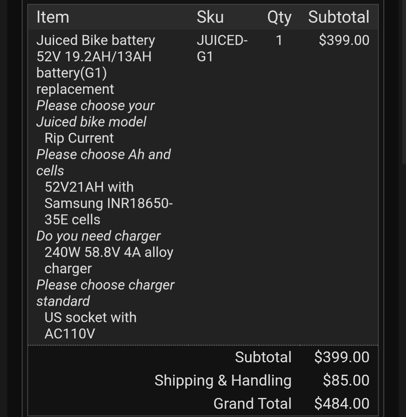

I just ordered the G1 21aH battery from greenbikekit so hopefully it'll be here in about a month!
Oh, final comment for you… Is this an aftermarket battery, or is it a Juiced battery with modified innards? I’d be concerned that it will work properly with proprietary stuff on the bike.
Not sure. It didn't say. I'll let you know when I get it.

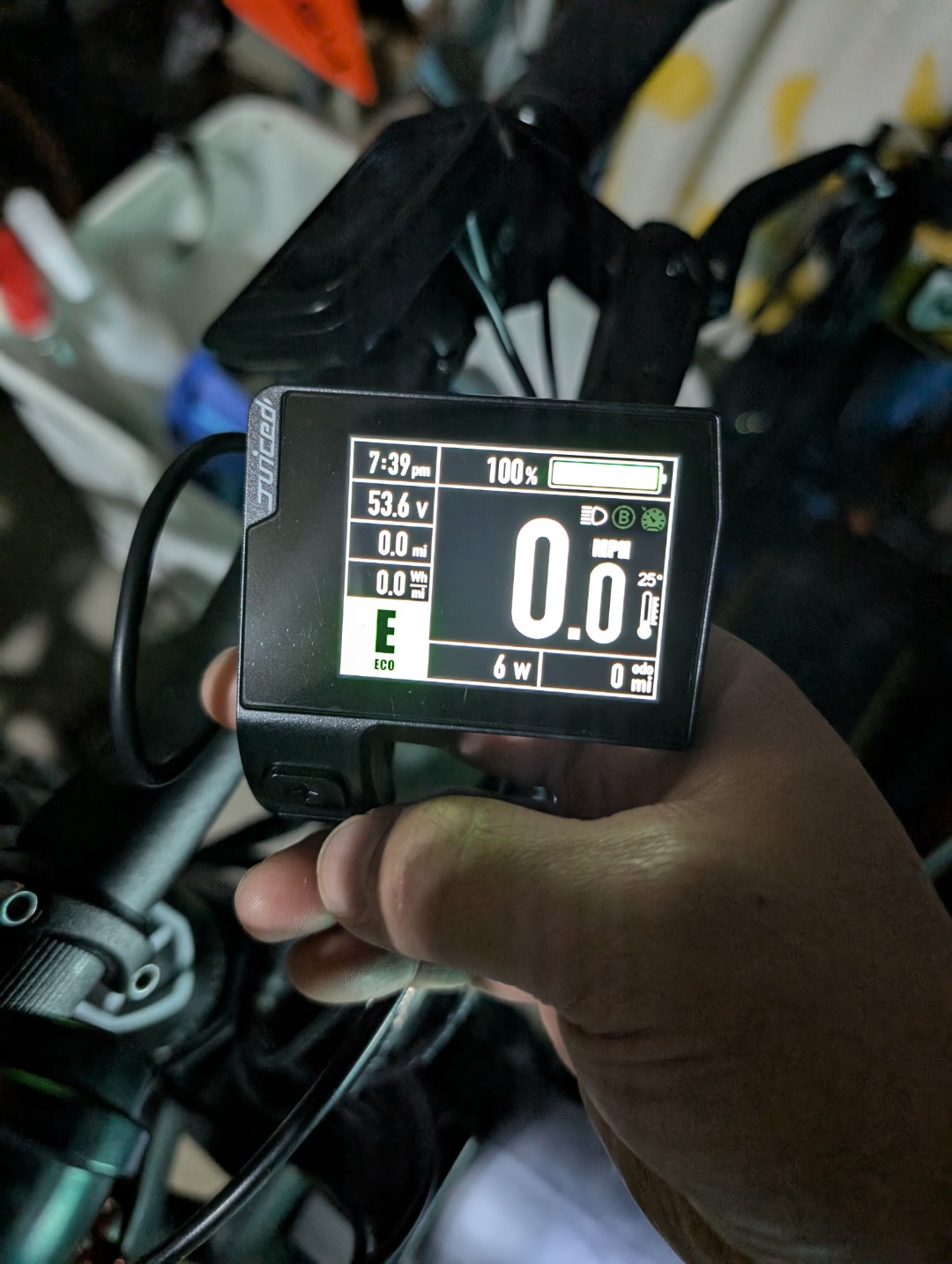

@Chazmo I finally got the replacement 21 ah battery from greebbikekit. Took about a little over 3 weeks to get to me. This thing much heavier than the stock 13 ah battery. I've pushed it to 30 mph on R with barely a sweat.
Wonderful! Glad the new battery is working for you, @jwhy! So, in total, you only changed the display and the battery, right? That’s great.
So, I’m not sure how much experience you have with lithium-ion batteries, jwhy, but try not to charge above 80% (55.4V) most of the time, and try not to drain below 20% (45.4V). And, if you’re storing the bike, get it to 50% (50.4V).
My experience with the bar graph on the display is that it’s kind of a weird algorithm… but it’s relatively close. I use a voltage table for accuracy. The display shows accurate momentary voltage, which is good if you’re just firing up the bike or if you’ve parked it a while. It’s also really interesting to look at the momentary voltage under load. I’m sure you’ll see it drop precipitously with your older battery.
