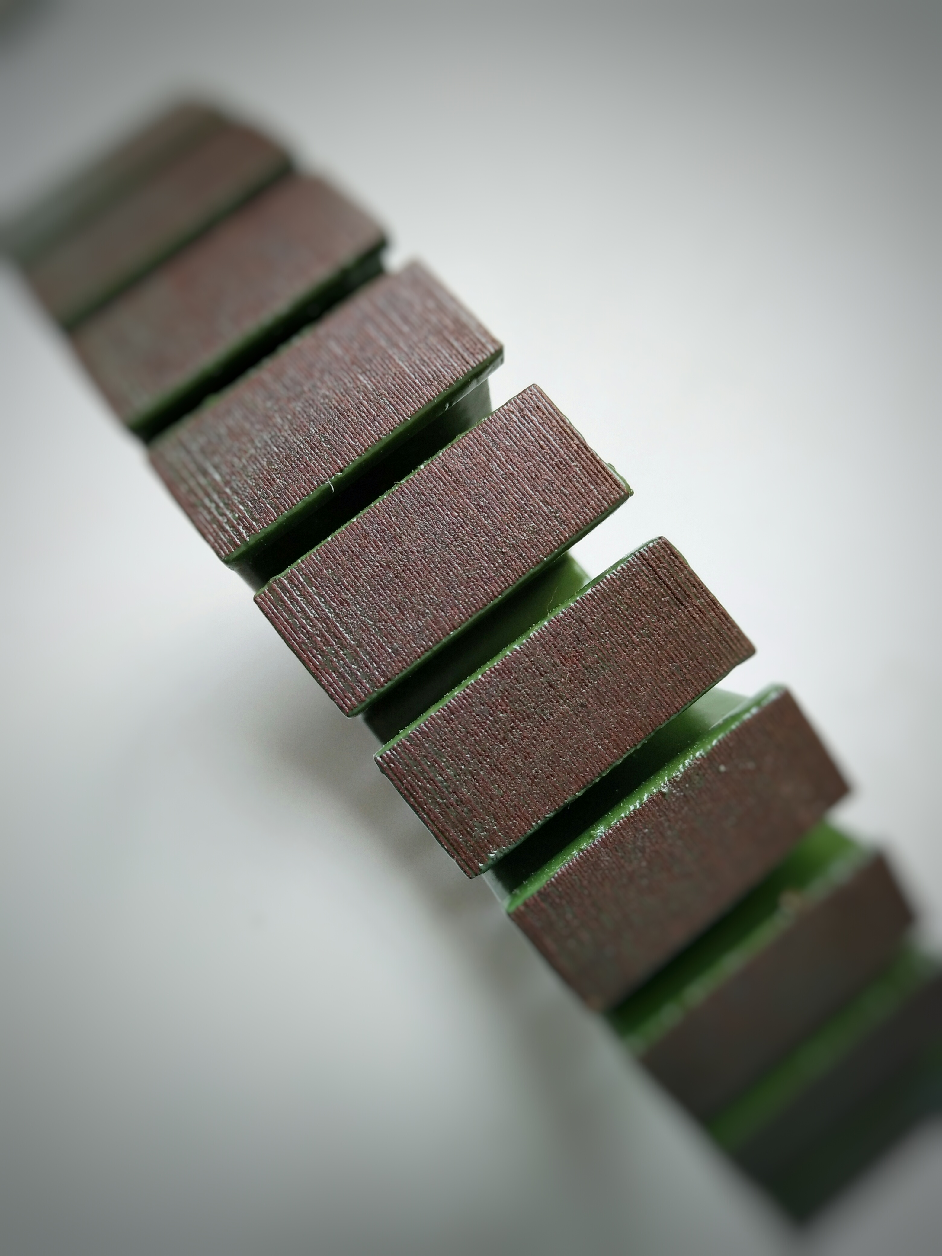

0.27mm thickness means what? A piece of paper? A hair? A $100 currency?
Today I will let you know a GOOD NEWS!
MAC Motor has started using 0.27mm thickness stator laminations for every motor, every one!
Forget 0.5mm, forget 0.35mm; now, it's time for 0.27mm Higher Grade Stator Laminations.
0.27mm Stator Laminations show greater performance and efficiency especially in high power motors, which can reduce heat loss obviously.
Do you have any performance measurements of the 0.27mm lamination vs. the older, thicker lamination? I know Justin at ebikes.ca has some really good hub motor testing equipment. I'd love to see some data from either MAC or from ebikes.ca to show the performance gains from the thinner laminations.

Ohhhhhhhh.......... Thank you so much!
Luckily, what you are looking for is what we are doing now!
1. About the ugly and stupid controller
Last week, we have finished tests on matching ASI Controllers with MAC Motors. On the 2016 Interbike Show, we deeply realized how stupid our controller is! ( But it is still very functional.) So many customers came to visit our booth and said your motor is powerful, efficient, high quality....but, en, your controller...
OK! Let's do something! After coming back to China, we started contacting ASI. Buying some samples controllers and inviting ASI after-sales engineer to our company. The test was smooth and successful. Now, MAC Motor can supply ASI controllers with motors together. ASI controller has such a smaller size and relatively good outline. I think many customers will like it.
2. About the Thru-axle
Also over the past several weeks, we processed some 100mm X 5.5mm thru-axles for our front motor. Currently, 142mm X 12mm is difficult for MAC hub motors, since the OD of our shaft is just 17mm. Based on our current shaft, 5.5mm is the max. thru-axle diameter we can achieve.
3. Yes, we do have some fresh performance data for 0.27mm laminations- 36V/48V/60V, with 6T/8T/10T/12T. How to send to you? Via email?
