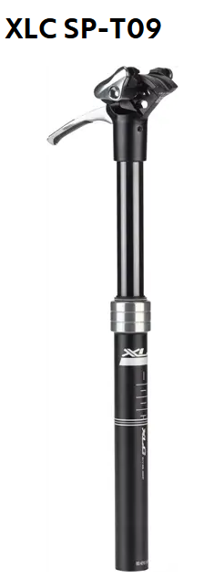

I have just ordered an inexpensive dropper seat-post actuated by a lever under the saddle for my Vado SL. I would use the dropper only for off-road descends or riding through a treacherous surface (sand!) That gives me a plenty of time to grab the handle (I'm not riding really fast off-road). I'd love the Reverb XPLR but it is unjustified for my needs to buy such an expensive equipment!
I think you'll find it useful at traffic stops and getting on/off the bike too...
