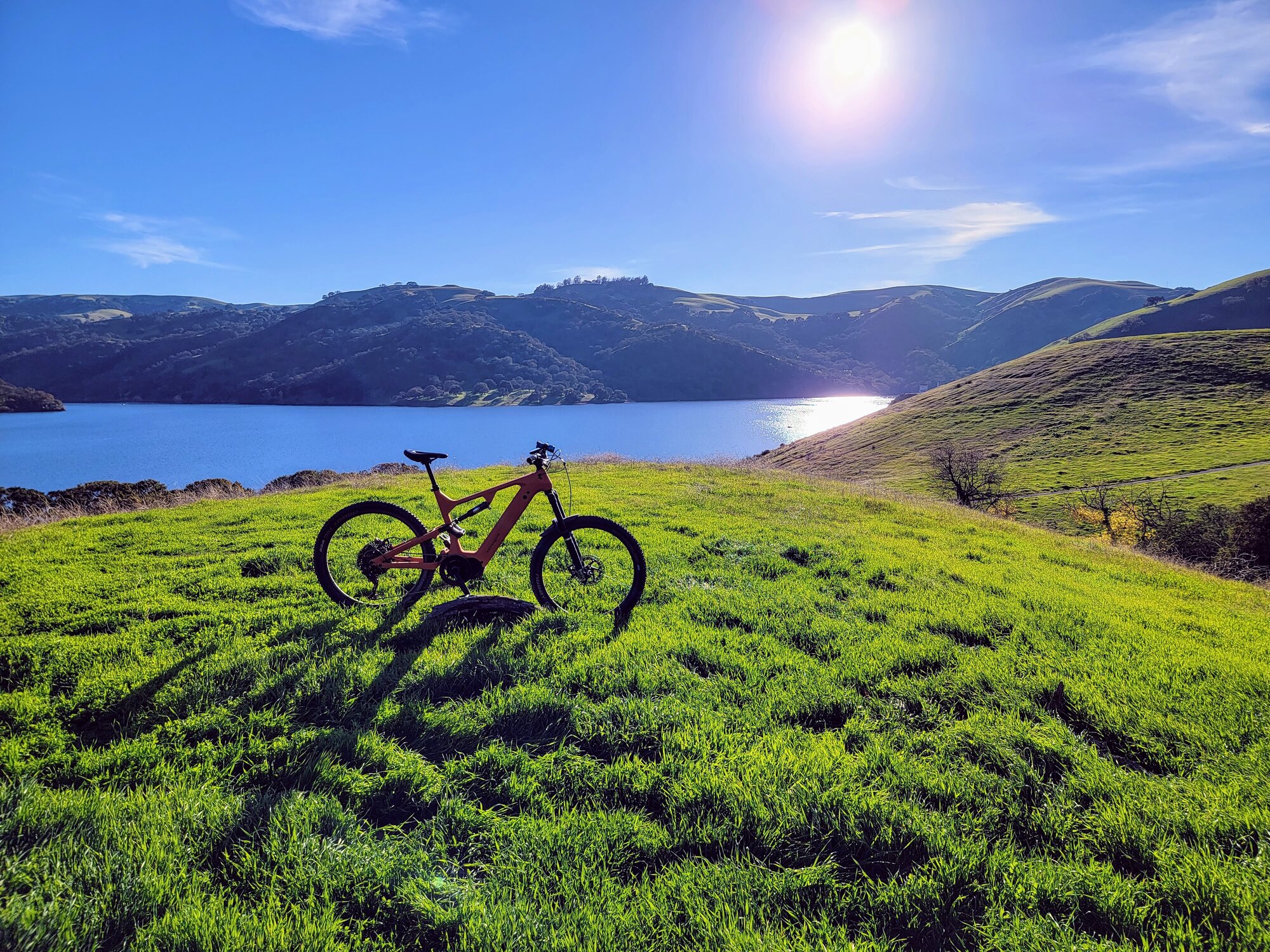

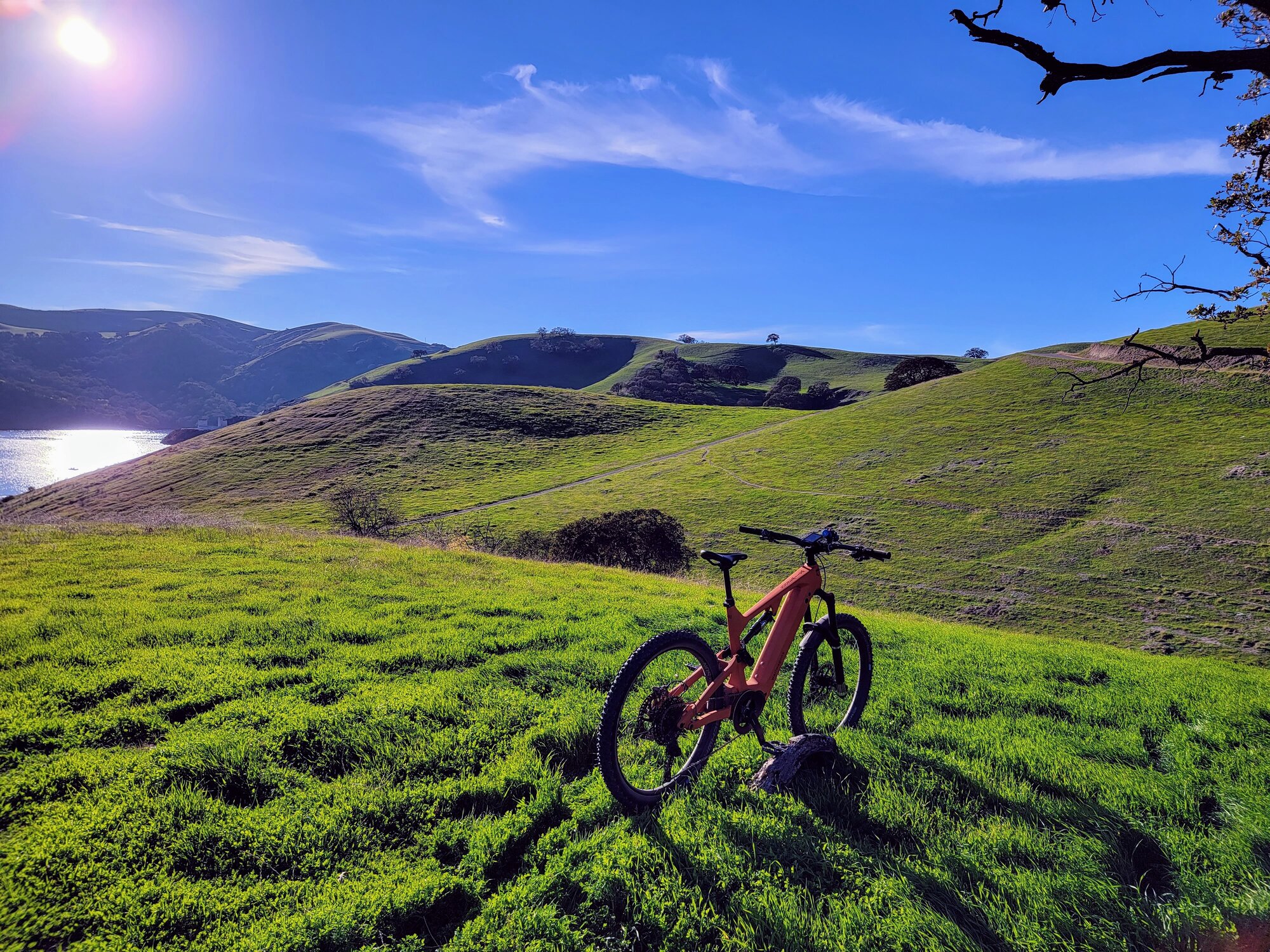

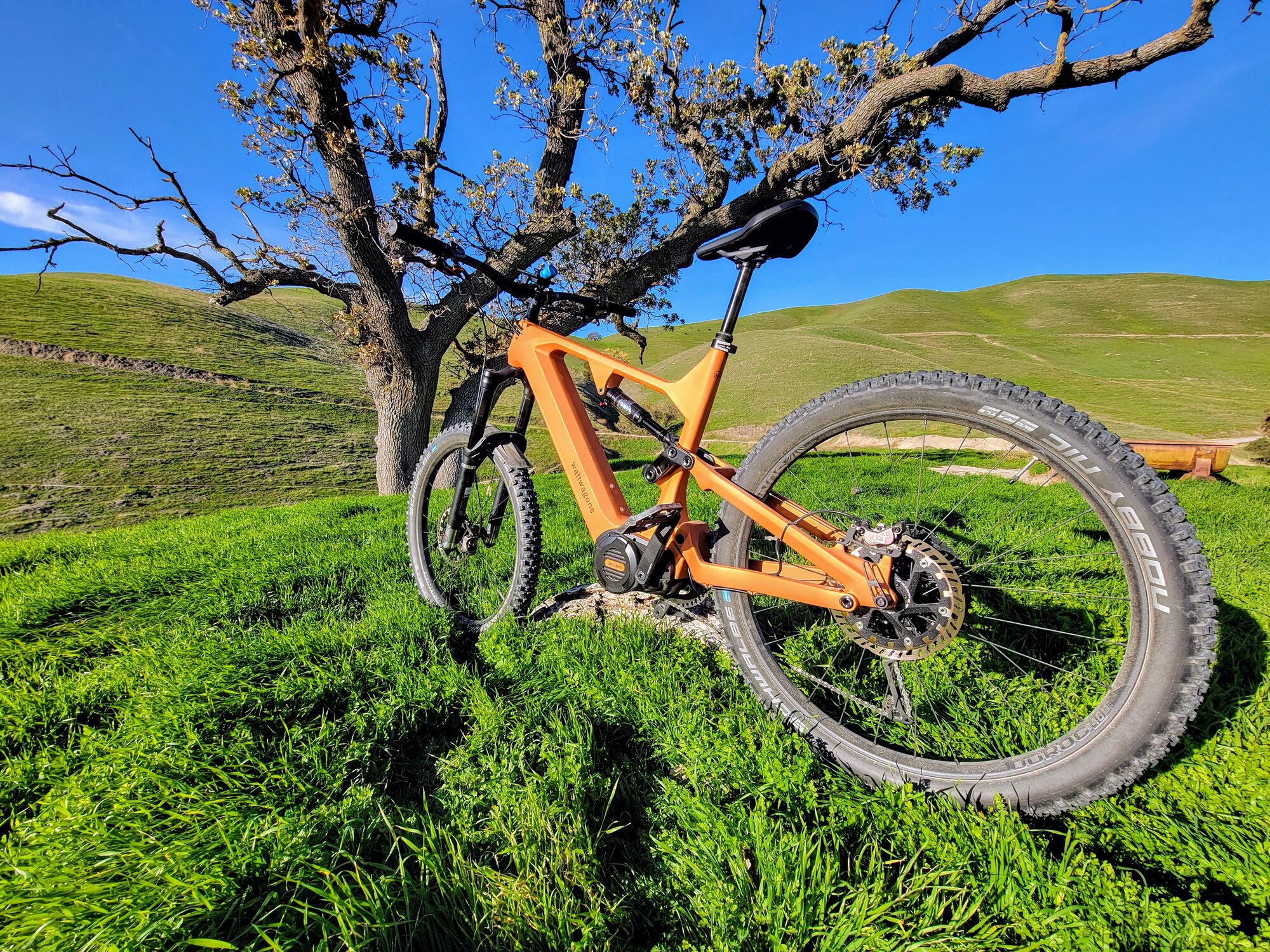

Ordered Hydra Jan 31st was delivered Nov 18th. Fedex took a couple days longer than they were supposed to, but it got here.
Nice, that looks to be quite a bit of greenery for end of November. Where do you ride?
Yeah, congratulations! Amazing pictures too.
Glad it's feeling great after you have put it through its paces some.
This is Del Valle Regional Park in Livermore, CA. In some ways this is best time go ride, green hills and was 60s today. Next fews day is supposed to hit 70F. Most of the year there is no rain, its all dead grass, no shade, and >90F.
