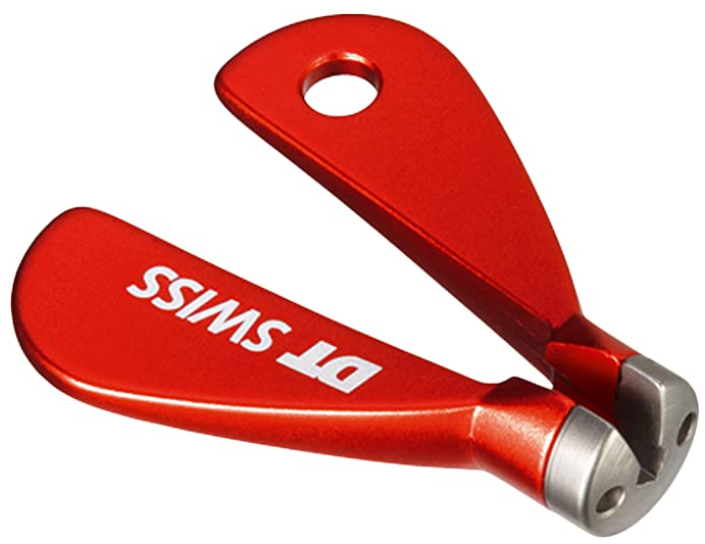

Speaking of spoke wrenches I recommend you get a good one rather than a cheap one. Nipples will strip easily especially if they are older. The Park Tools ones are ok but I prefer the DT Spokeys as they grip all four facets and the flat paddles are easier on the fingers.
Take note that not all nipples are the same size. The most popular sizes are 3.2 and 3.5.
Is this what you are referring to? Does this work with all nipples or is it specific to a certain size?

I'd guess your bike has 13G spokes; I do not believe DT makes that size spoke wrench. The round one that Sierratim linked to should be fine.
