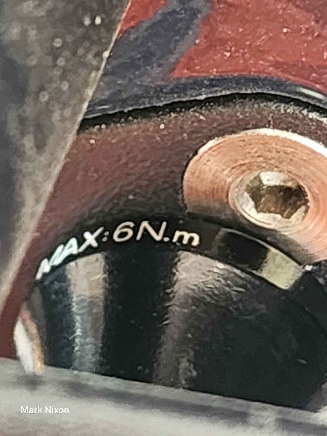

20 Nm is waaaay off! I've got that bike and it's printed right on the nut "6 Nm max"

My Allant has the torque spec printed directly on the rear nut. 6 N.m max
