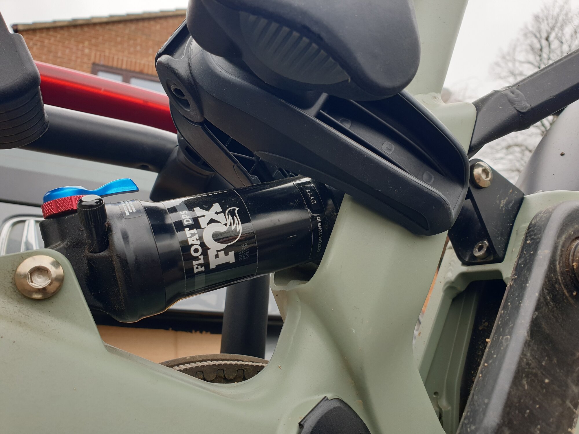

Yes it will. I have the large size frame with the GX option and the same EasyFold. The standard wheel straps on the EasyFold will engage OK but it's a bit fiddly to get right if you are doing it on your own. If you have someone to hold the bike or a smaller frame size, then, I would think it will be easier. I decided longer straps would be better so got the 'Fat Boy' straps that Thule do and it has made it easier for me. Unfortunately I don't have any pictures to show where I put the clamp but it's across the frame where it straddles the rear shock.

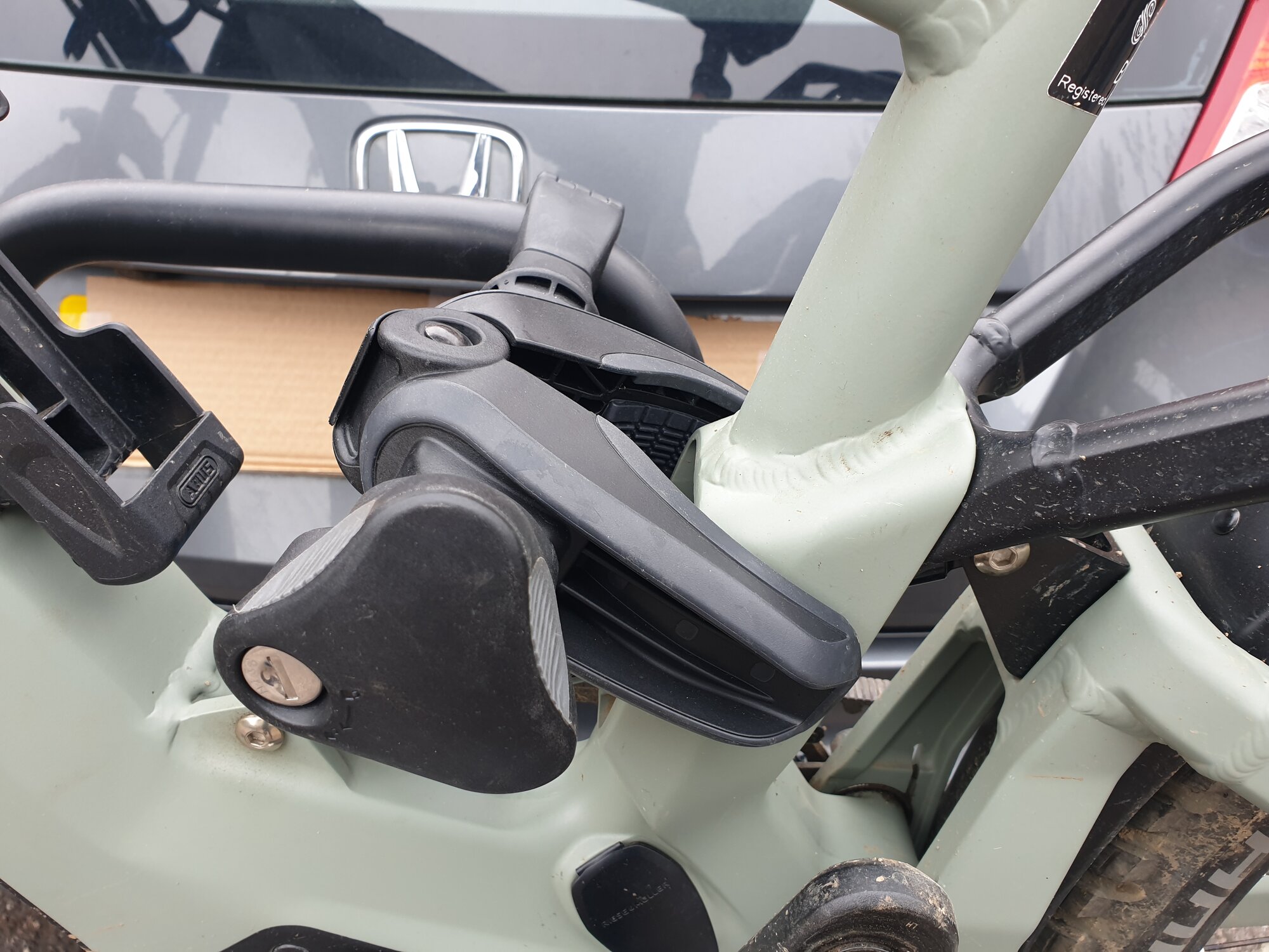

So you put the clamp in the red or blue area? If it was the red, did you have to relocate the lock (not pictured here)? It looks tight from the pics, but maybe the lock will mount down by the rear shock on those bolts? I updated the post, I got the medium size frame. I'll look into ordering the larger straps for the tires.
I clamp in the middle between the red and blue and it is tight to get the angle of the clamp arm right. Give me a day and I'll stick the rack on and take some pictures for you.

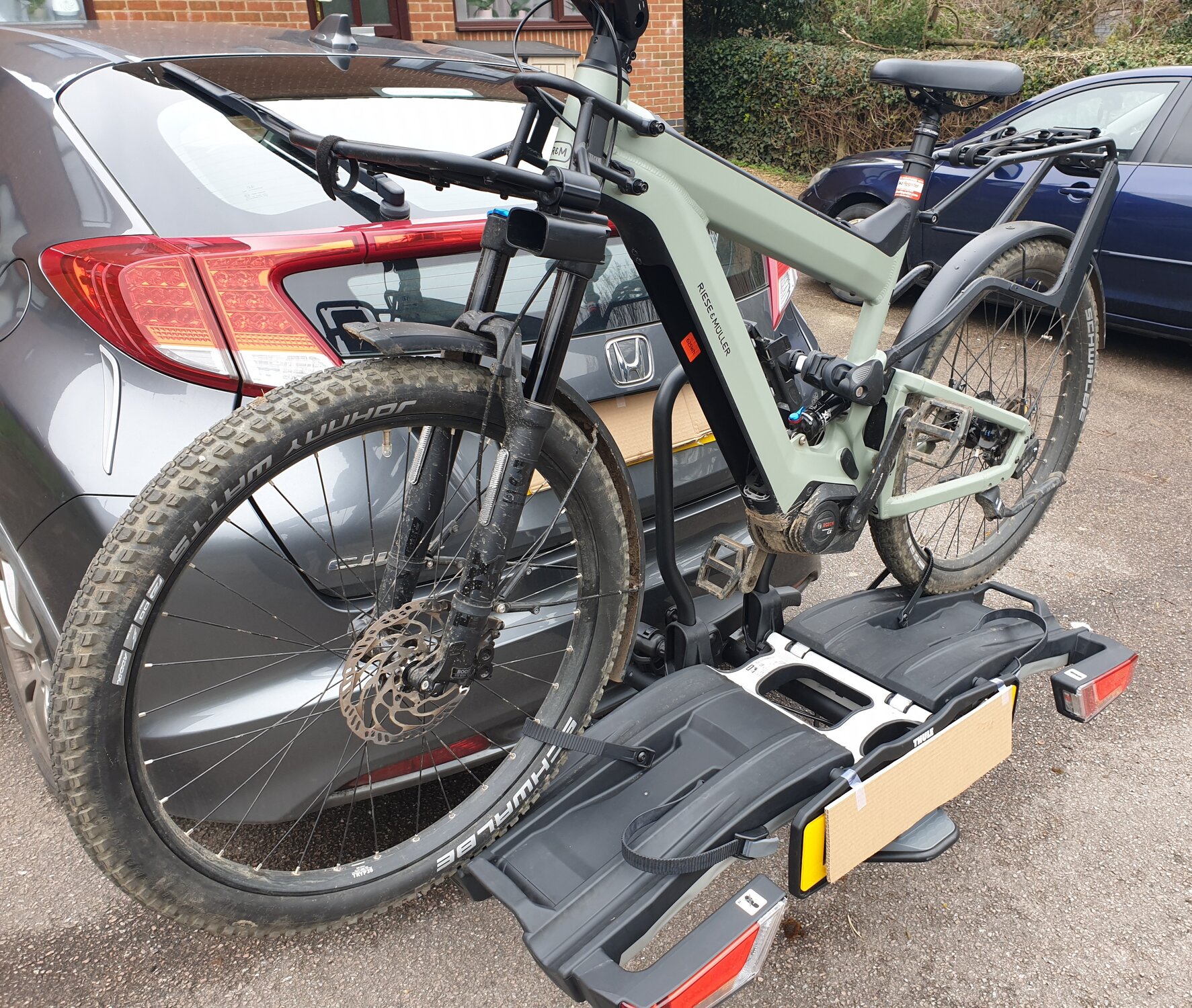

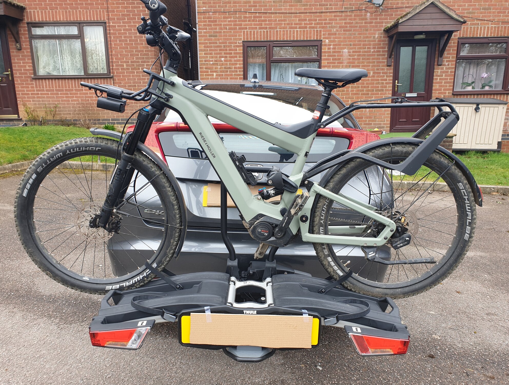

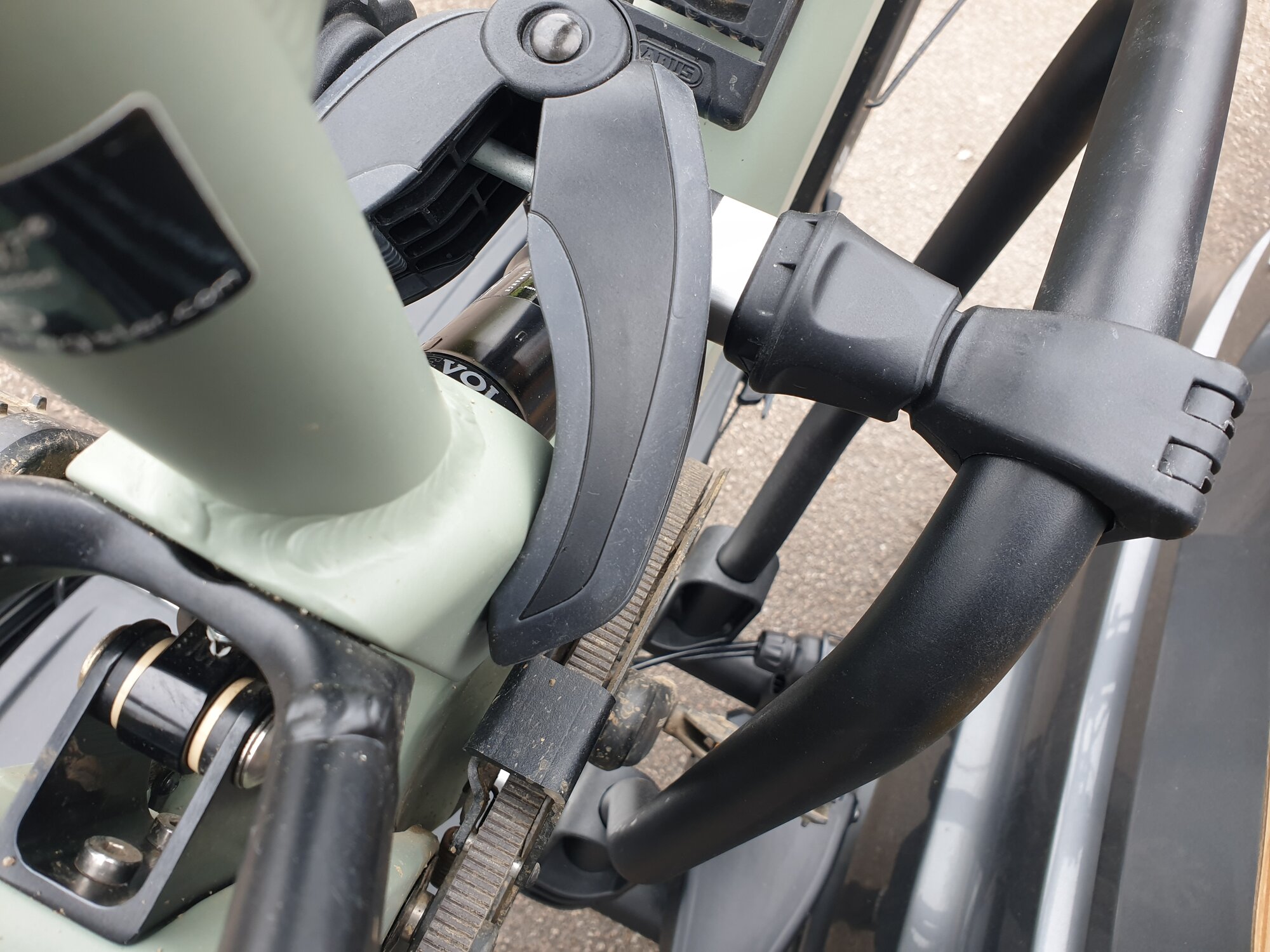

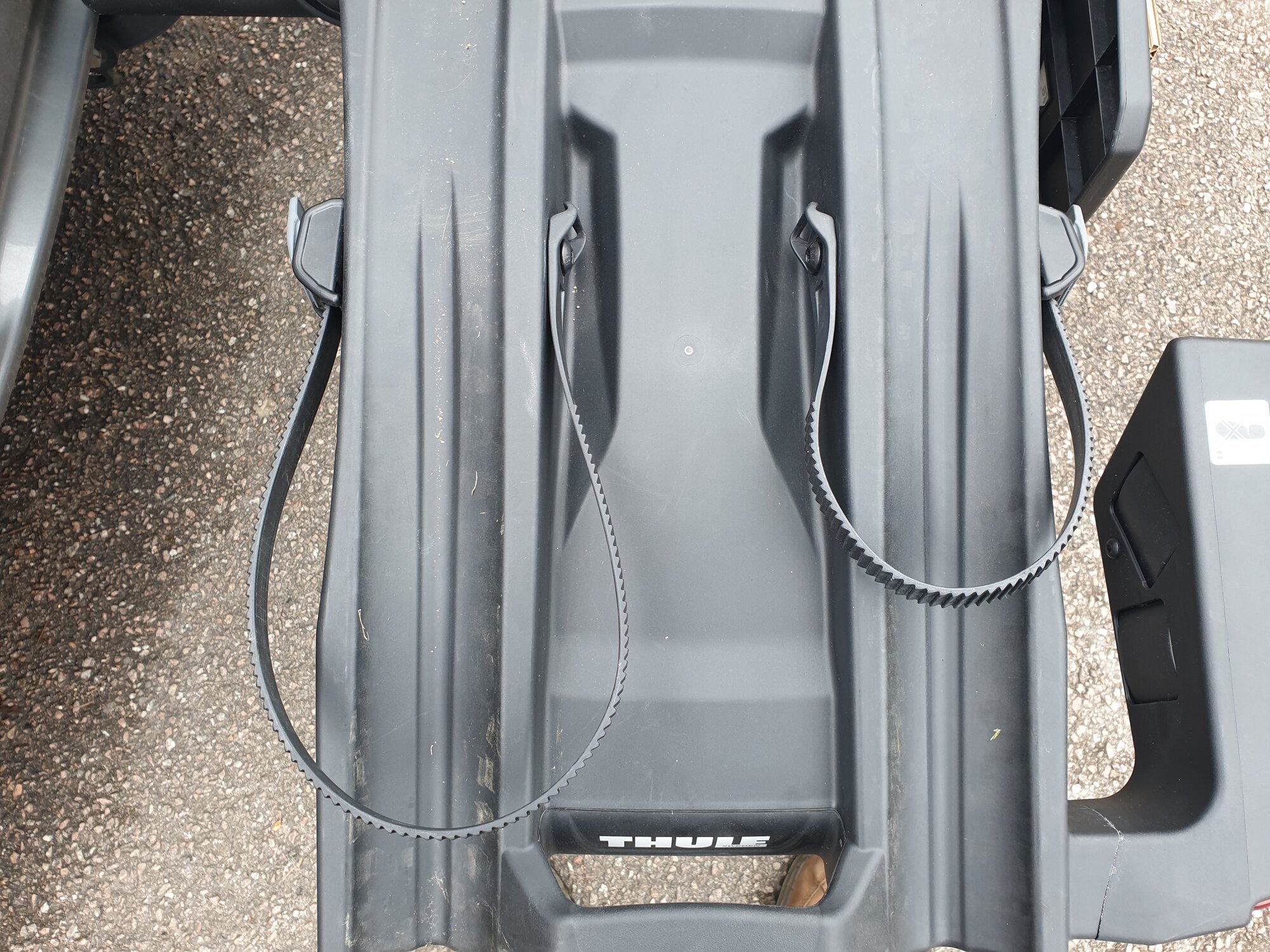

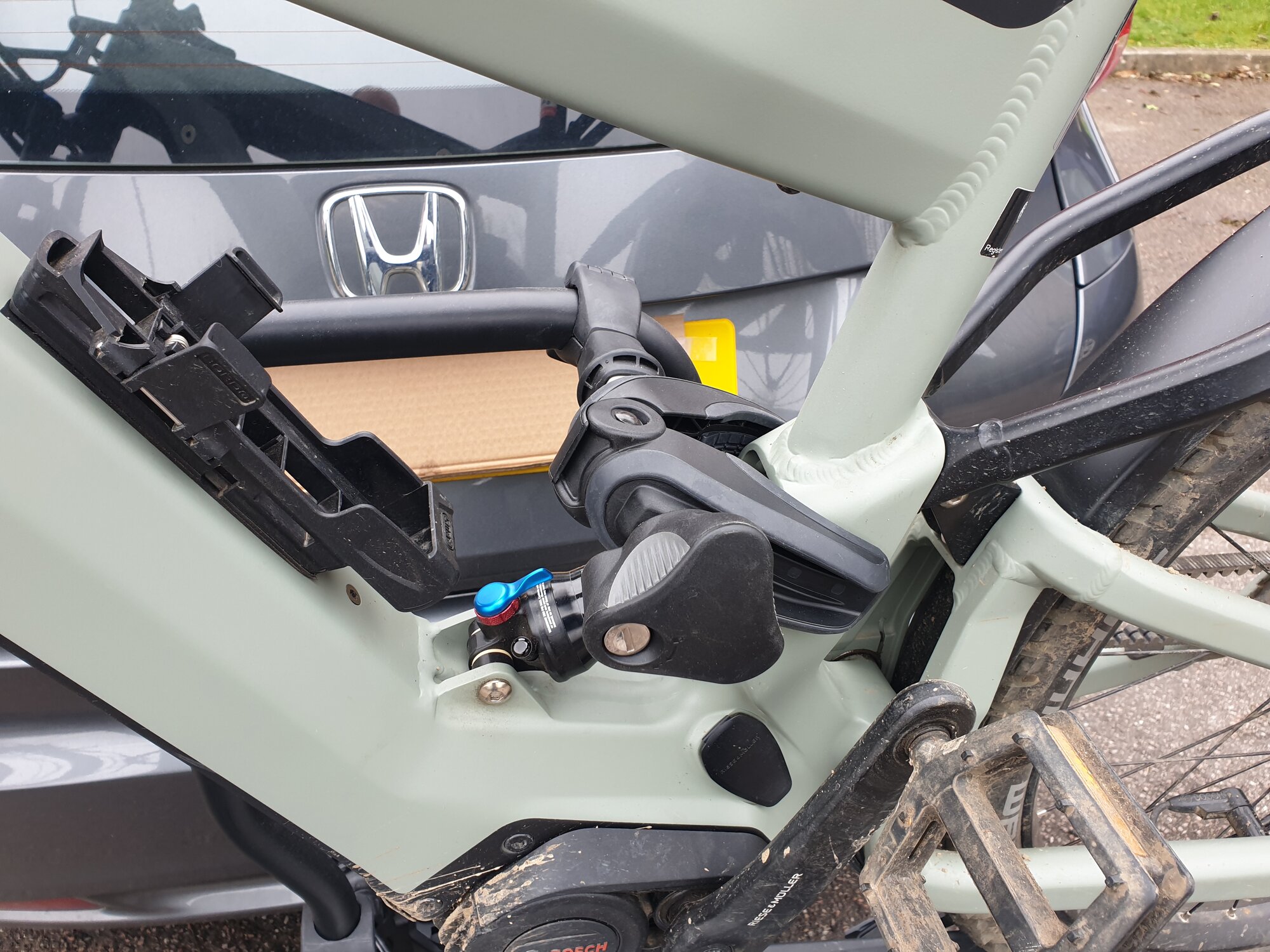

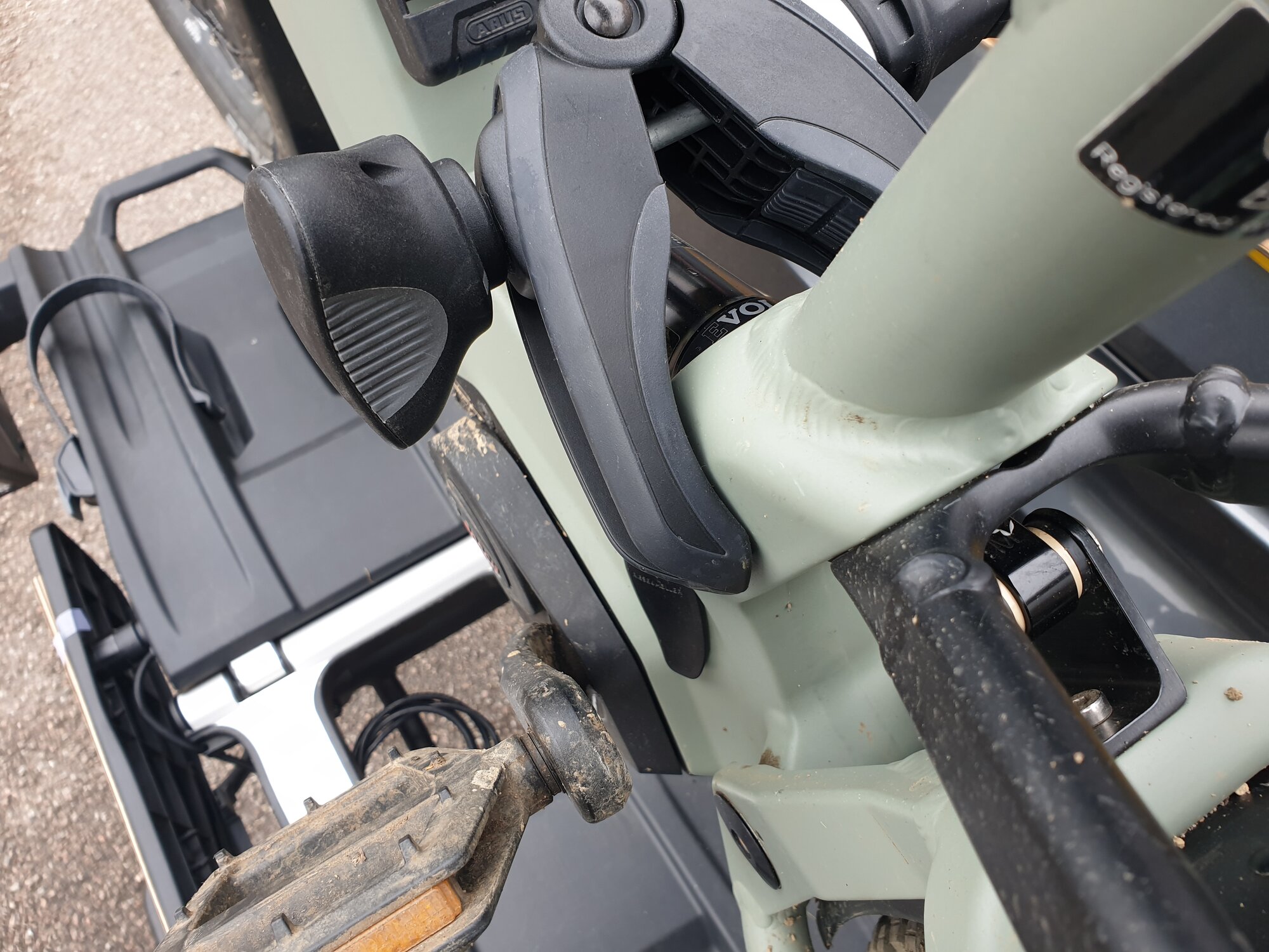

A little later than I said due to rain but here they are.

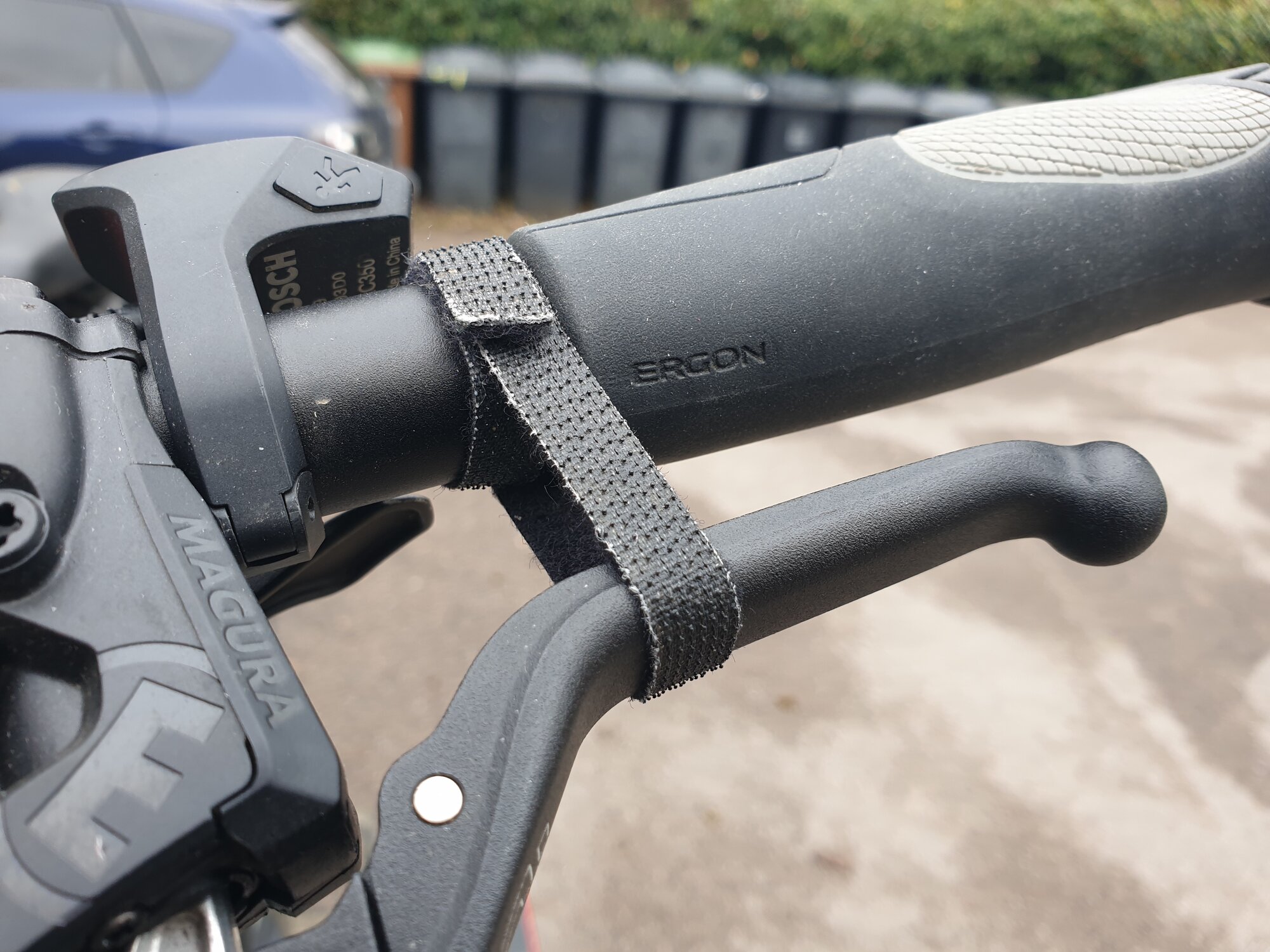

The secret ingredient is some double sided Velcro to hold the back brake on. Makes it so much easier getting the bike in the right position and holding it there whilst you get the clamp on.

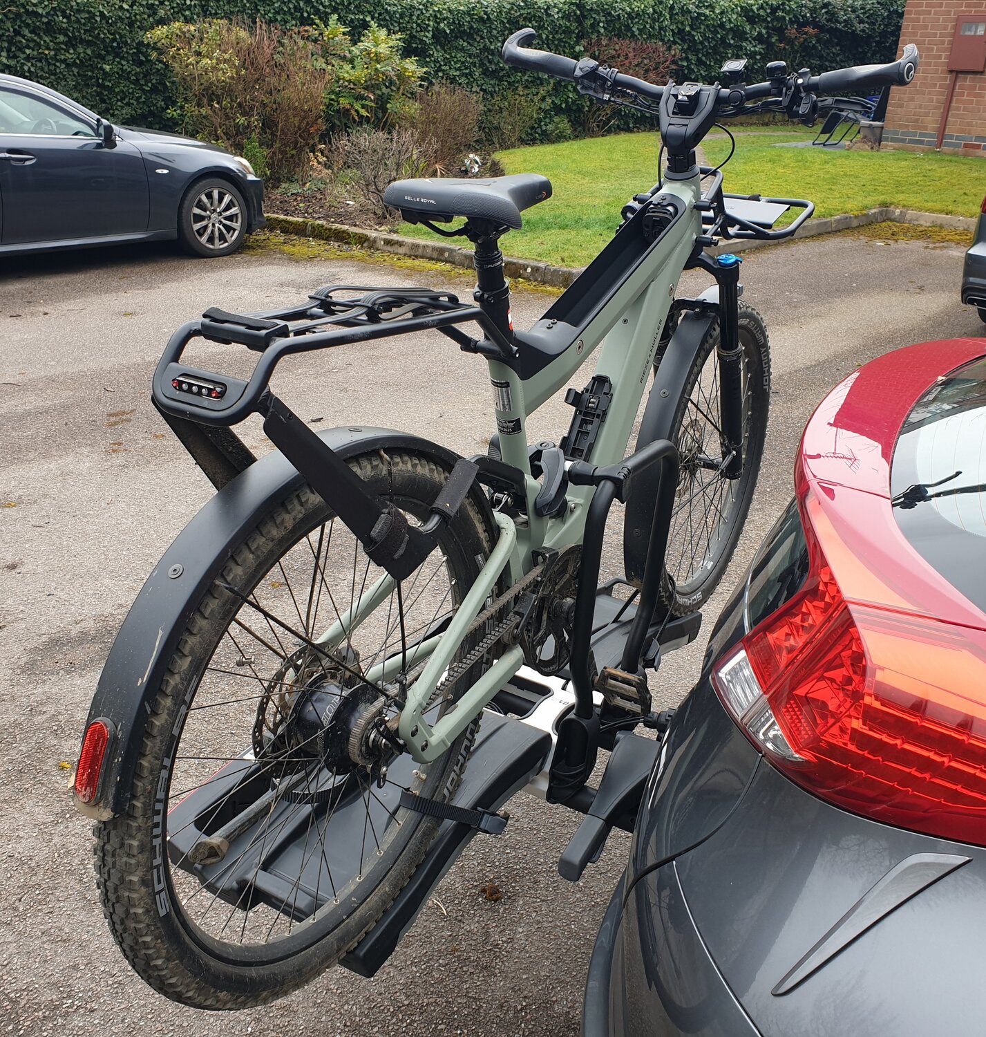

So this is the Thule Easy Fold XT2 with Fatbike wheel straps and a large frame SD with GX option.
And this is the difference between the standard wheel straps and the Fatbike straps.
Thanks so much. I've got a set of the longer straps on order now. Long term, I may get my brother to modify the pipe on the Thule so that it is taller, and maybe add some cross bars and such, depending on how it fits with my wife's bike. He owns a metal working company, so it will be trivial for him. Cause it appears that if it was a tad taller, you could raise where you clamp the bike a couple inches, and have a more secure grip on the seat post. But it will definitely do for now. Thanks for saving me $250!
Those pictures also answered a question I had about relocating the factory lock, to the lower mounting point. I hadn't seen anyone do that, and didn't know if it was too close to the rear shock or not. But with it relocated, and a taller pipe on the rack, there seems to be plenty of room to grab the bike.
I agree with you regarding a taller frame on the rack and think that just an inch would make all the difference in getting a better angle on the seat tube.

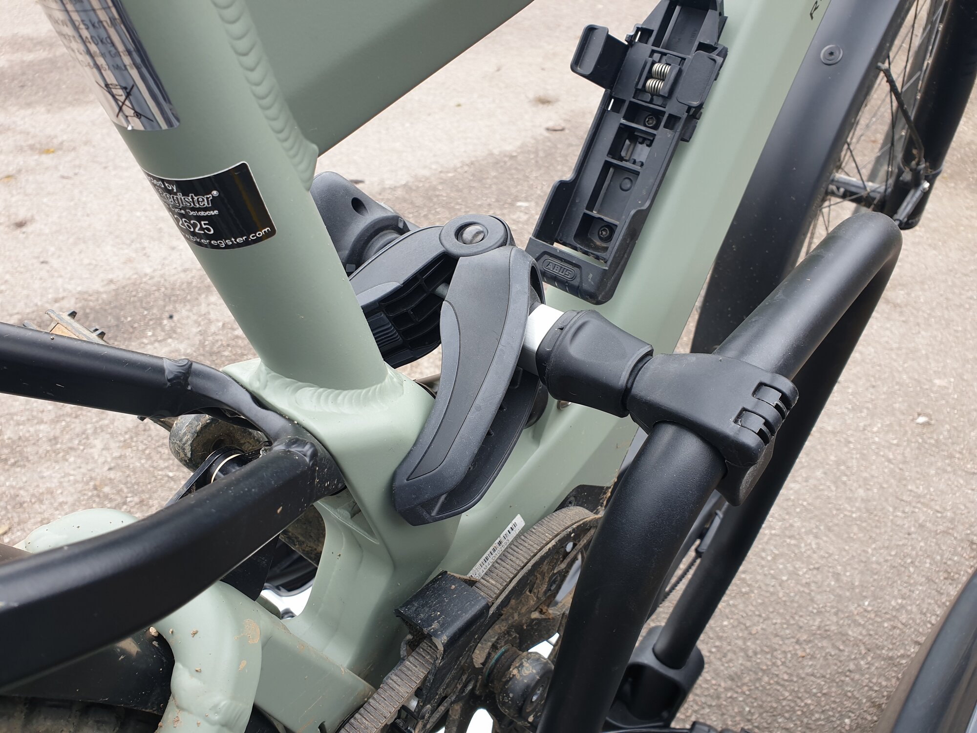

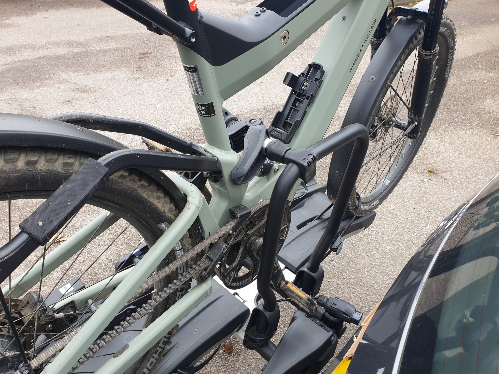

Here is a photo of my wife’s new Nevo 3 on the Thule rack if that helps. I also use it for my 49 cm Charger 3. I know the wheelbase of the superdelite is slightly bigger but I think it should fit ok. I am thinking of upgrading my Charger 3 to the SD.
Funny you should ask...
I haven't carried my 2020 SD on our Thule XT2 rack for months. This morning an unexpected need presented itself.....
FWIW: the bike is the 54cm frame, GX variant, and, as you can see, the standard length wheel straps are fine. The longer straps would be a little easier to use, but these are working OK for me.
