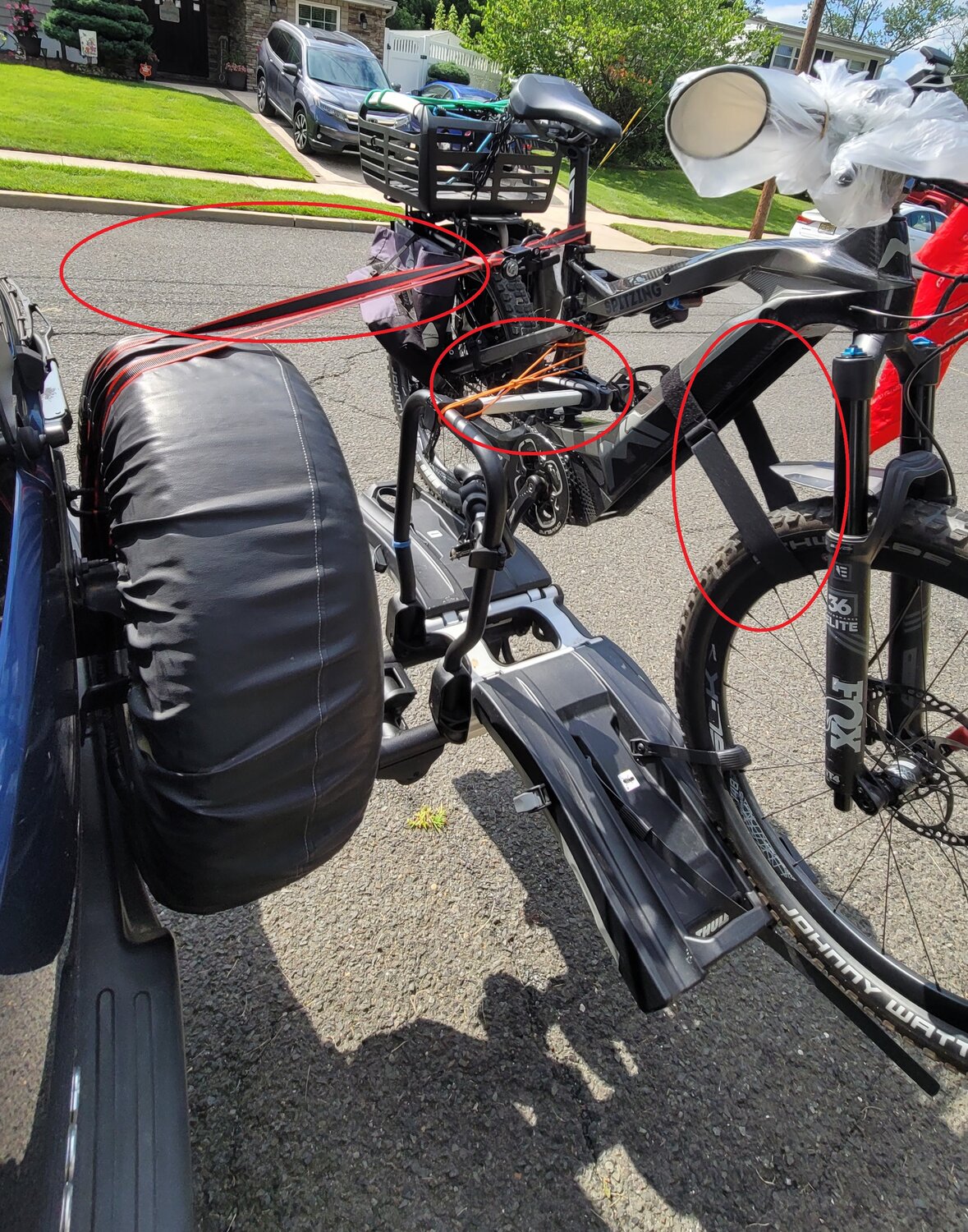

have this same rack for my 38 pound carbon fiber Spitzing, would *not* recommend using only the hook without a second bungie!
had an incident where a vibration caused the hook to pop off throwing the bike over!
luckily the foot straps held it and since it was higher up (on a jeep) i only lost a grip and some of the handlebar as it scraped along the road
the bike popped out of the hook a second time, but i used a small orange bungie (see pic) the prevented it from falling over after the first time
i have also found a small comealong to secure the rack (it's attached to the seat post and spare tire post) stabilizes the rack from the rocking motion (see pic)
finally, a section of velcro strap makes putting on the bike a 1 person job and easy!
it only takes a few minutes more and piece of mind, especially with an $11K bike, is essential!
