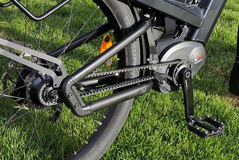

I have no problem removing the rear wheel and replacing the carbon belt on a Riese & Muller Homage. I guess if you have a bike where you need to take the chain stay apart, that adds a level of difficulty. With the Riese & Muller they put a high idler pully just behind and near the top of the motor that the bottom of the belt rides up and over, eliminating any need to break the chain stay.
It is handy to be able to remove the wheel quickly to fix flat tires, change tires, tune up the wheel's spoke tension, adjust fenders, etc. With the Homage I loosen the spindle, holding on to the top of the tire so it stays in place. The I let the hub drop down slightly, just below the droppouts. At that point it can go forward about an inch (2mm) or so which is enough slack to pull the belt off the rear drive ring. If the belt is on a Rohloff hub with the E14 don't forget to unplug the electric cable to the E14 mech on the left side of the bike. It is a two prong, rubber coated, two part male and female plug that is snug but will separate. It is important to remember to plug it back in as your last step in reinstalling the back wheel, otherwise you will get an error message and the shifter won't work.
Even with just these 'simple' steps, I would conjecture this puts you in the 80th percentile of people who are a) able and b) willing. So, best that the wheel very infrequently requires removal (few tire punctures, high-mileage tires, high-mileage belts, etc.).
