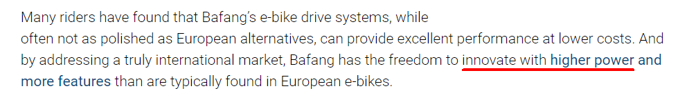

They mean that Bafang develops for places besides Europe where power limits are higher so they create different products.
That’s not what the the author of the electrek article implied at all. They clearly implied that bafang would bring their higher power motors to Europe.
The article suggests that Bafang may bring their high-end limited assist 250W mid-drives and shown in the M800 photo below from the Electrek article.

Good point but keep in mind that Bosch, Brose, Shimano, Yamaha all have 250W mid-drives in name only... ;)
Many studies have shown that they all output considerably more power at close to 3 times the rated number.
For limited duration. Johnny has reported in this very thread how he was able to "cap" the motor power of his Bosch CX and how the motor had to return to its nominal power to avoid overheating. The article you quoted claimed Bafang would be able to compete with EU motor makers in Europe based on power. I said: "No chance". Because they would need to certify their motors for EU first. You simply do not compete by power in Europe; Shimano, the Japanese company seems to understand it very well.
