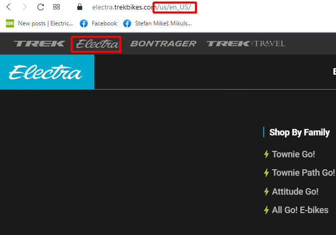

@mschwett: Could it be Trek changed their website part to mention Electra overnight?
Click this link please and tell me whether you can see "Electra". It is the U.S. website, referring to the same e-bike you showed:
@tomjasz: Really? Why is the Giant brand separated from Momentum one then?

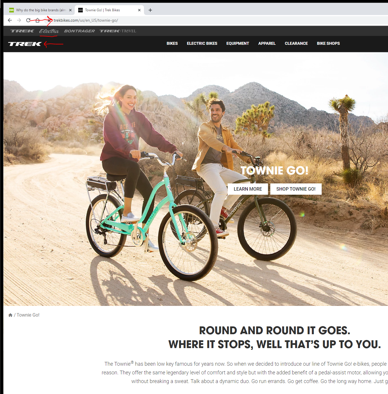

it's really irrelevant - you can walk into a trek store and buy these bikes with a trek badge on them and trek support and write a check to "trek" to buy them - but the branding seems to depend how you get to the page. if you go trek and then ebikes, there's no reference to the townie series being "electra" bikes, but they reference electra technology and the very top ribbon of the website shows electra as one of the trek marquees. no reference to electra in the URL.
they're clearly in a mode of transition, having obtained the company and their designs/manufacturing/marketing many years ago (trek bought electra in 2014!), and not wanting to lose continuity with the value of the name. typical business.
