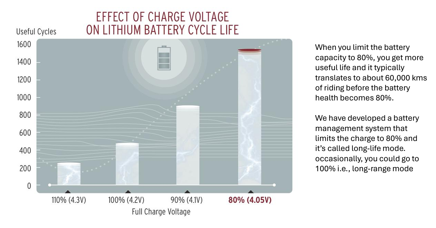

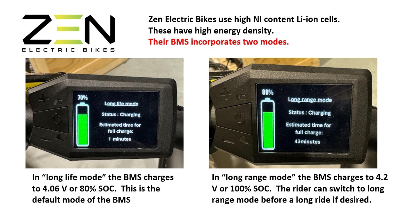

One of the features that we have implemented in our Photon Pro and Ultra bikes with 52V, 20Ah batteries is the smart BMS with the adjustable limit for an increased lifetime.
These modes can be changed with the simple click of a button on the control display. I don't know of any other E-bike that comes with such a feature. Our hope is that people make use of this feature and prolong the life of the battery.

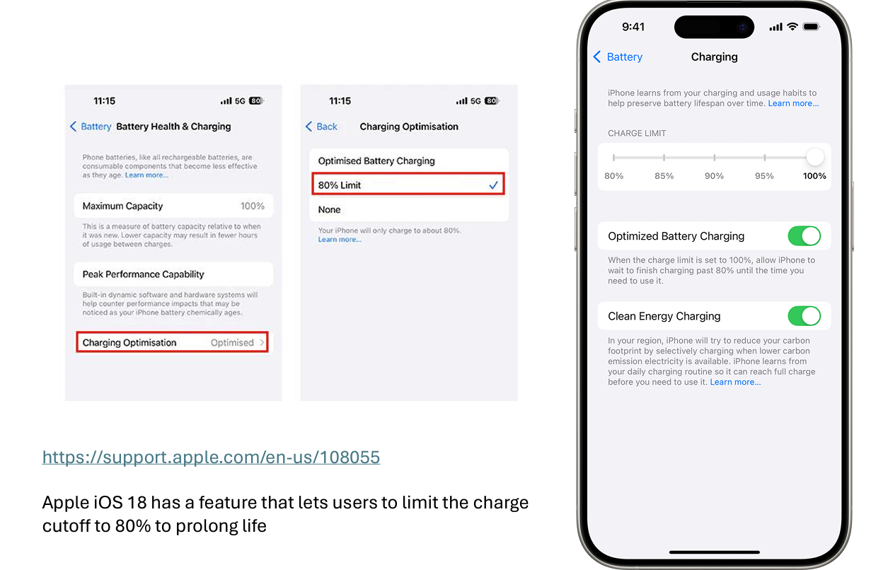

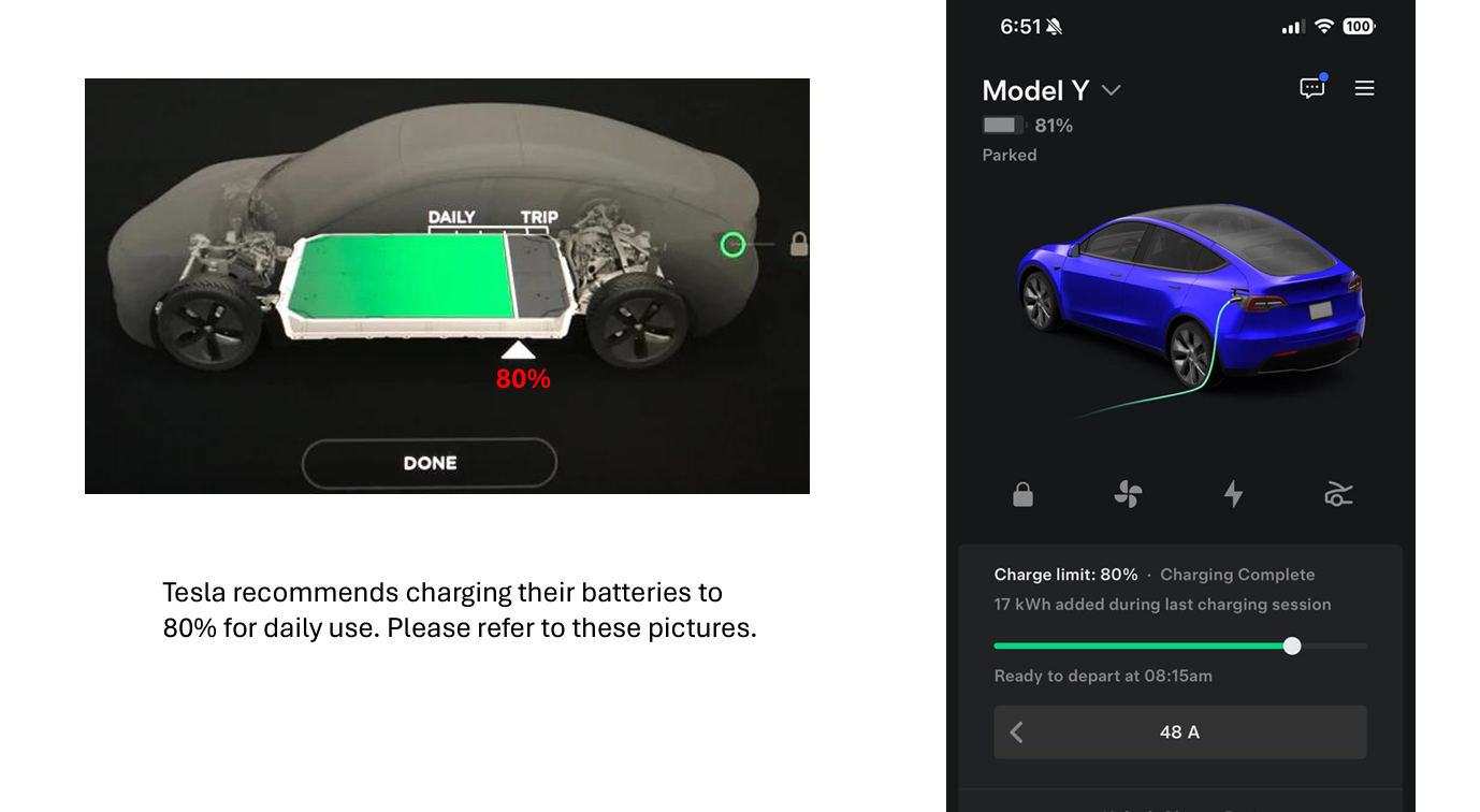

You may want to watch this video to understand why 80% charge benefits the overall lifetime of batteries. It's not just us, Tesla and Apple also recommends 80% charge for batteries [see image below]

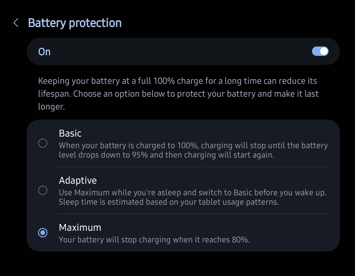

My Samsung tablet.
They've had this feature for years.
