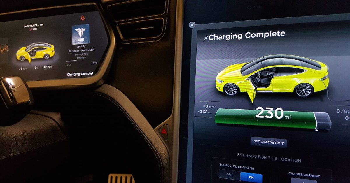

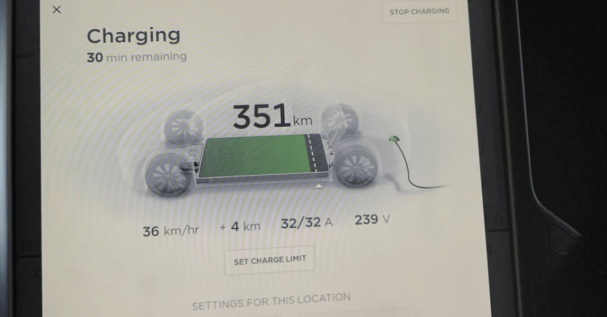

If cell phones and laptops had the size of battery pack your eBike does, they wouldn't be a quick charge either. The Tesla charger you refer to is a 220v input charger. Want to carry one of those to the coffee shop?
