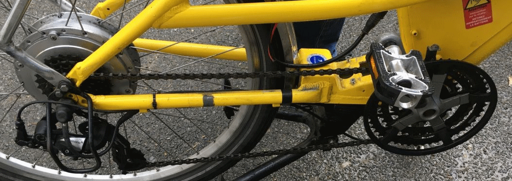

Hello,
I know someone who bought a second-hand e-bike with a Bafang/8 fun rear hub motor, and is looking for a solution to replace the very unnatural on/off cadence sensor. It feels like riding a motorcycle.
So I looked for Bafang-compatible bottom brackets with torque sensor… and found none.
So it looks like a more involved alternative would be to replace the controller with something a bit more sophisticated.
Considering the number of cheap/DIY bikes with a hub motor, and a torque sensor offers an experience closer to an acoustic bike… I'm surprised there's few bottom brackets with torque sensor. Out of curiosity, why aren't they more widespread?
Thank you.

I'm looking for a financially reasonable solution to add to that rear hub Bafang bike shown in the picture. Since it's in Europe, it has no throttle (illegal.)
Does Grin Tech provide a bottom bracket with torque sensor that I could hook up to a Bafang hub motor?
Alternatively, what KT controller would you recommend?

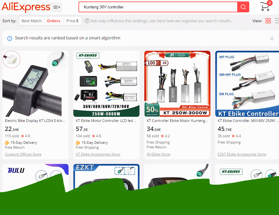

What plug and play KT controller do you guys suggest for that hub drive that offers a user experience close to a motor with torque sensor?
