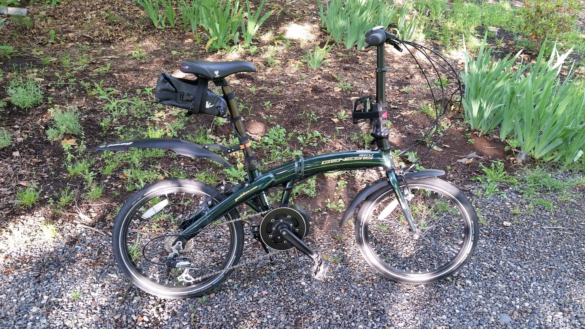

I have installed tsdz2 mid drives on three folders, a 20" Walmart "Genesis" folder, a Dahon Jack 26" folder and a Dahon Briza 24" folder. The Jack needed only to have the bolted on fold support on the bottom bracket removed, the Genesis had a protrusion on the bottom of the bottom bracket where the support was bolted on so that was cut off with an angle grinder and cutting disc, the Briza has a more complex frame that required more modification. The tsdz2 worked well on all three, currently on the Jack.
Here it is the Genesis when it was on that bike - 36v 10ah battery is in the seat bag. Weight was 40# which is at least as light or maybe lighter than listed weight for a Friday ebike, if I recall correctly what I had read. Overall a quick, easy, capable and fairly inexpensive conversion.
