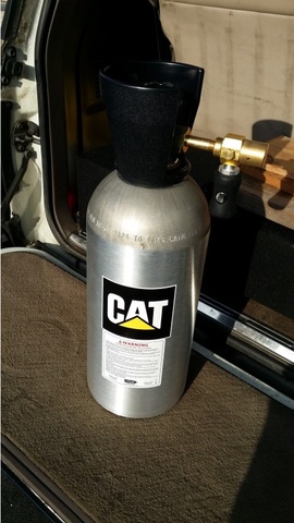

I buy CO2 in 5 and 10 lb bottles to air up my 4X4 truck after deflating to drive on sand, etc

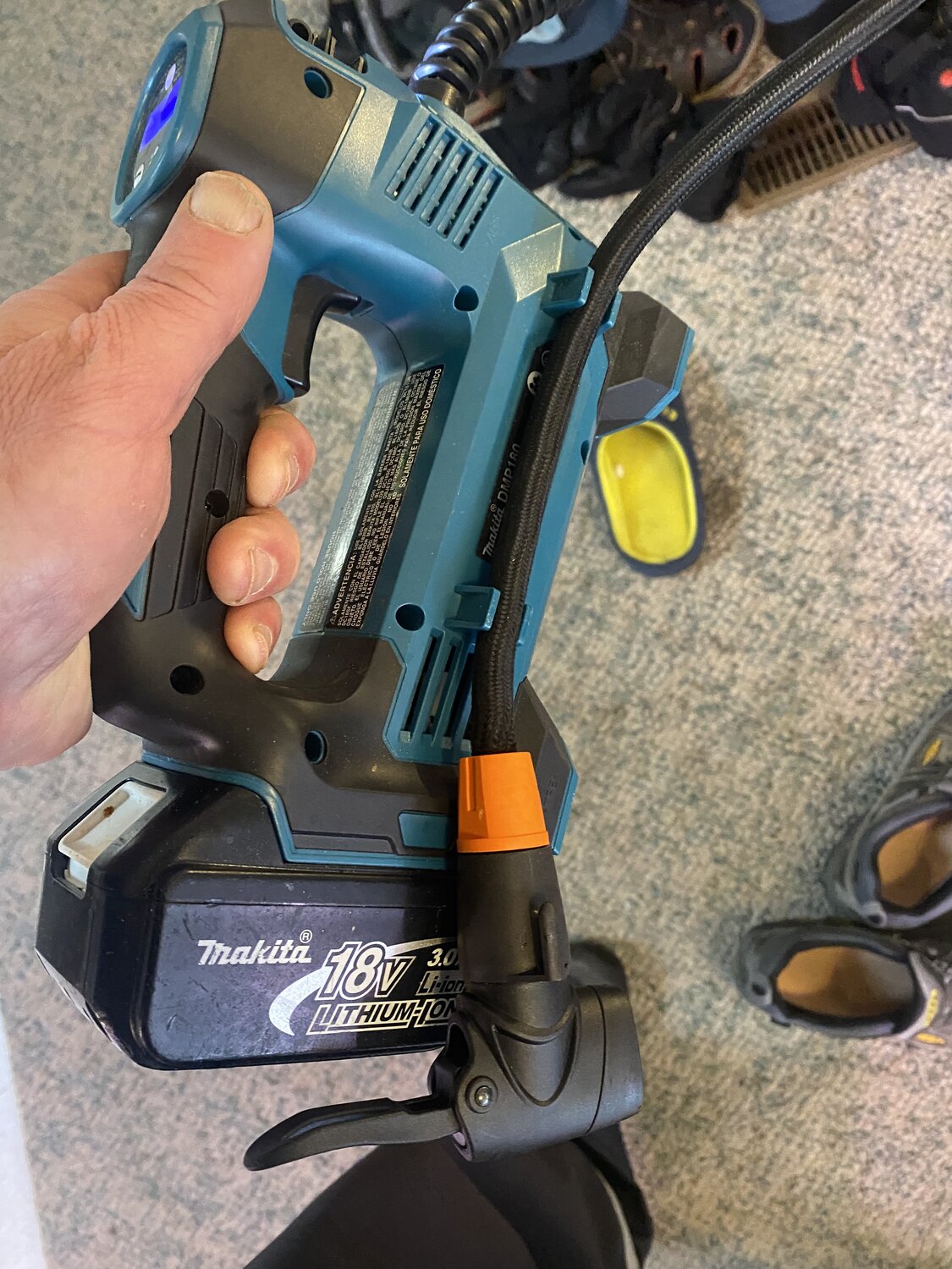

I am actually in the process of completely divesting my various tool kits of co2. the single-use nature of it doesn't jibe with my need for a backup to the backup. I've had situations where a co2 cartridge does not fully seal a fat tire, but just gives it more air to run out while the sealant is slowly doing its job (this was back when I was using Slime, before FlatOut which works better and faster). Still, I have lived the dream of using the two cartridges I had, then having to resort to the backup hand pump (the Lezyne Micro XL fat portable). Thats 200+ pumps and let me tell you life sucks on a hot day sitting on a rock getting that done. It would be worse with any other portable though.
A little over a year ago I went to a small compressor pump that runs off my ebike battery. Its been a great success, and I have never had one fail on me (I think I have four of them spread across multiple kits). I continued to carry the Lezyne hand pump as a backup.
Recently I started taking 2Fat out on some remote beach rides where I need to ride several miles on a paved path to get to the start, then several miles on the deep sand, then back home again over pavement. So I am now deliberately airing from 15 psi to 5 psi and back again on each ride. I decided I did not want to rely on just one compressor (it is soooo nice just to fire the thing up and relax and watch it work) so I bought a commercial pump with its own battery. I got the one with the biggest battery I could find that wasn't BS'ing people about its battery size.
Its been awesome. The new one is the primary and the one that runs off my battery is the backup. If I wanted to go cheap I could do two of the latter as they're half the price. I'm always using panniers so I can afford the space.

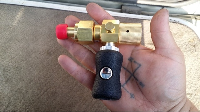

I use this guy at home with a better head.

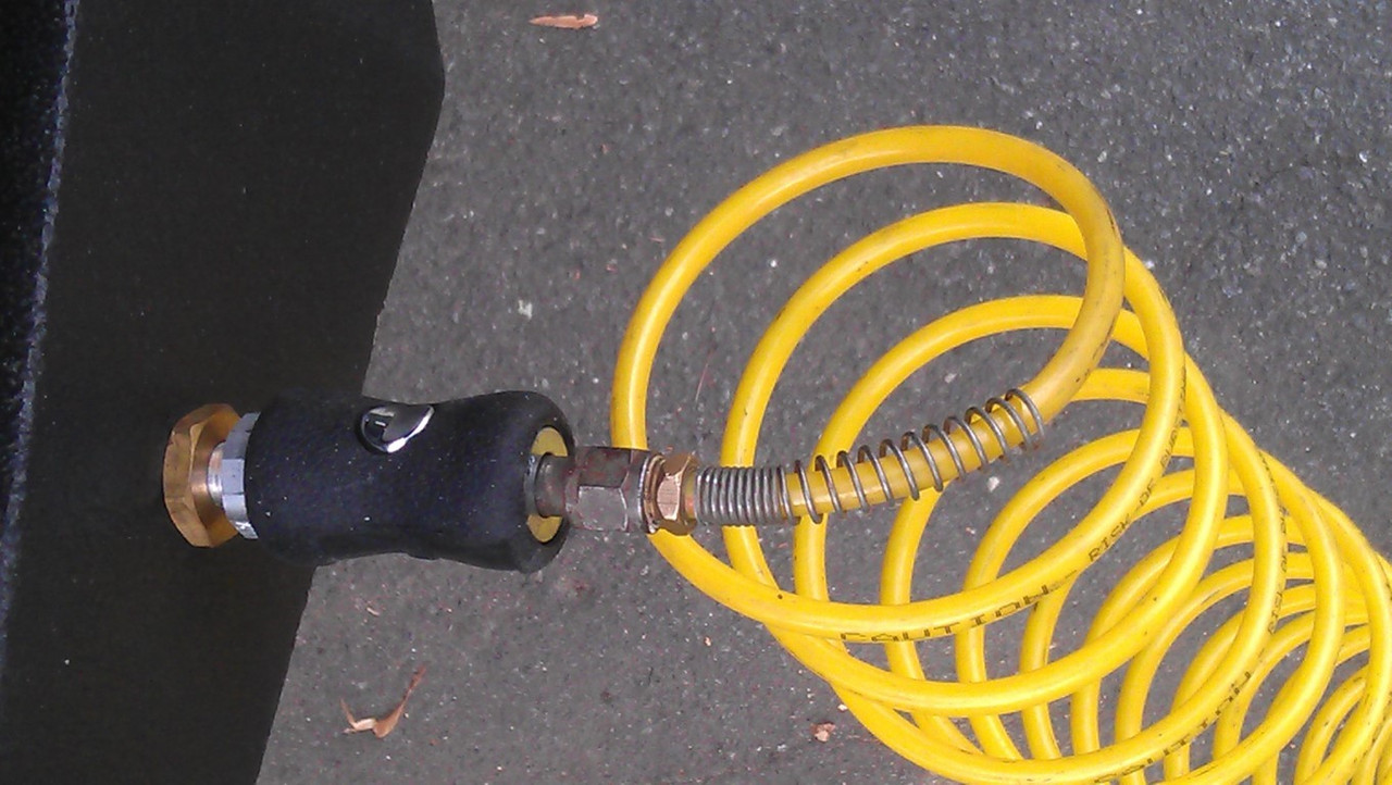

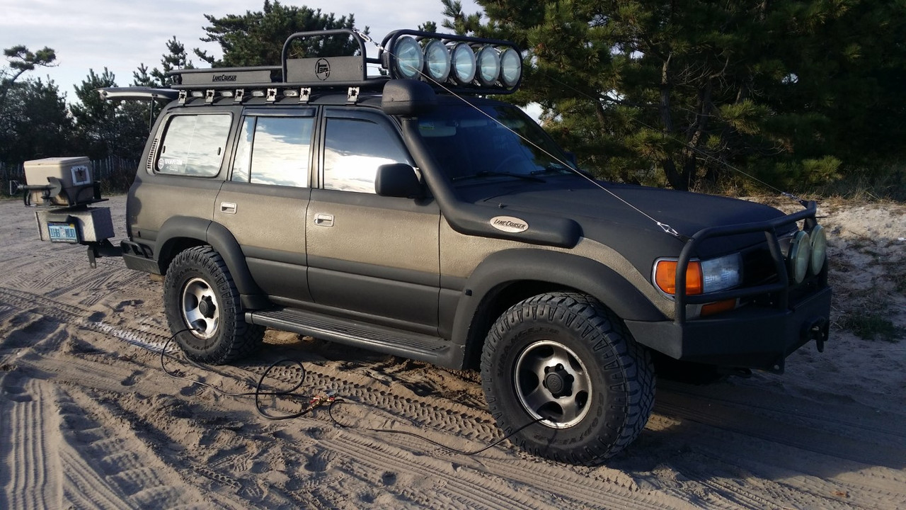

I have dual 200psi compressors on my rig, but also have a CO2 tank as a backup
Nothing of value to add - just want to say I love your 80 Series. HDJ , FJ, or FZJ? Had a '95 FZJ80 3X-locked, greatest vehicle I ever owned and I still kick myself for selling it.
Thanks
97 FZJ80 Locked with over half a million miles on her and she still drives like new
I sold mine w/ 255k mi on it, new owner drove it from US East Coast to Alaska where he lived, last I heard from him it had over 350k and the engine still hadn't been opened up/head never had been taken off. Talk about an awesome vehicle.... Dang, now I need to find me another!
My only complaint with her is that she drinks more gas than any of my vehicles
13 City/14 Hwy before I added 1700 lbs. worth of armor and recovery gear
Gets around 8 or 9 now
Not good when I have a 90 mile daily commute lol

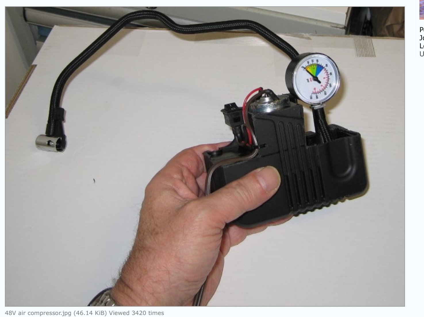

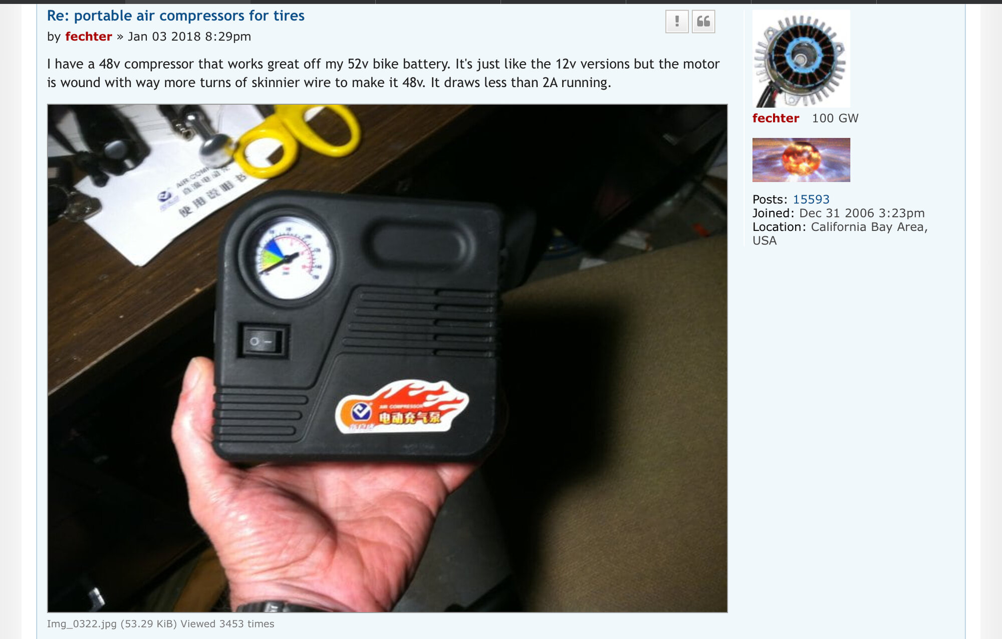

I bought a 48V from Banggood or ALiexpress . And parroted this post.
Just how practical are CO2 kits with 2.5” and wider tires? Missed m@ post.
Ha! just when you think you are oh so smart and figured out something new, it turns out you were the last one to the party. Looks like that guy found the same pump two years before I did. Mine came from an Amazon search.
