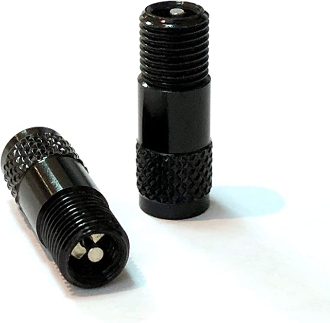

Nowadays I go right up to the line and no more, and my screw-on chucks have turned out to be the solution to giving zero air loss when airing up tires.

I've been using this setup for years and it works GREAT !
Link: https://a.co/d/8cFtIJv
Enjoy !!!!
