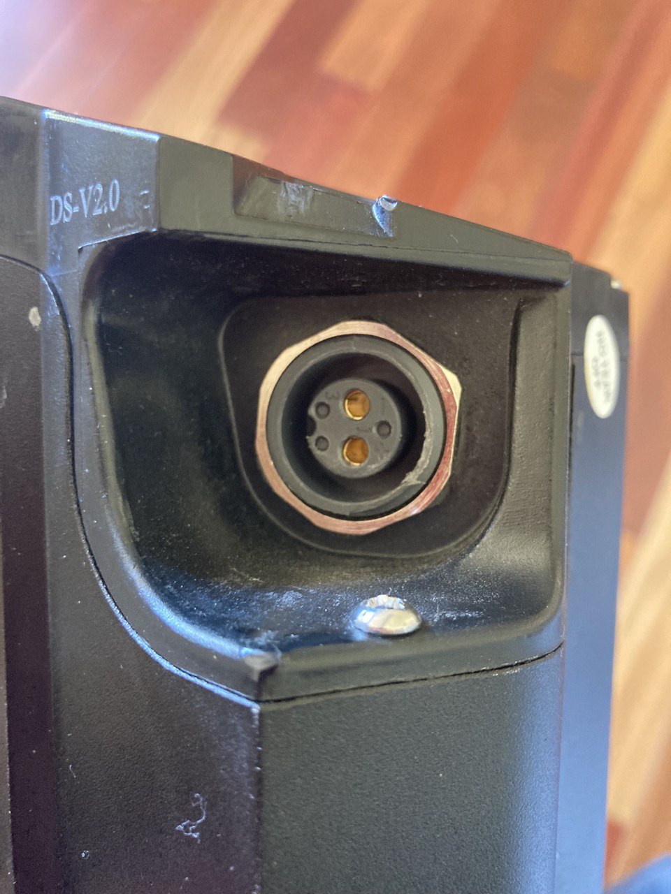

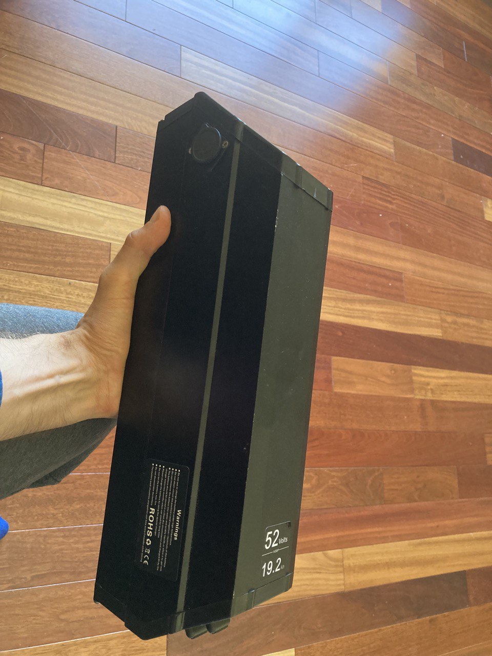

I have a Juicedbikes 52V*19Ah battery left after my ebike was stolen and I'm planning to convert a usual bike(Treck Dual Sport 1) to ebike using it. I've googled it and it seems that battery is similar or is a Reention Dorado battery. Anyone know if I can buy it somewhere in the US?

My battery is about 16 * 6 inch (40 * 15 cm). What is wrong with Luna bag? I was thinking about buying it. Zip ties on it looks more durable than straps on other bags, though because of the holes for zip ties It is more prone for the water getting into the bag I guess.
