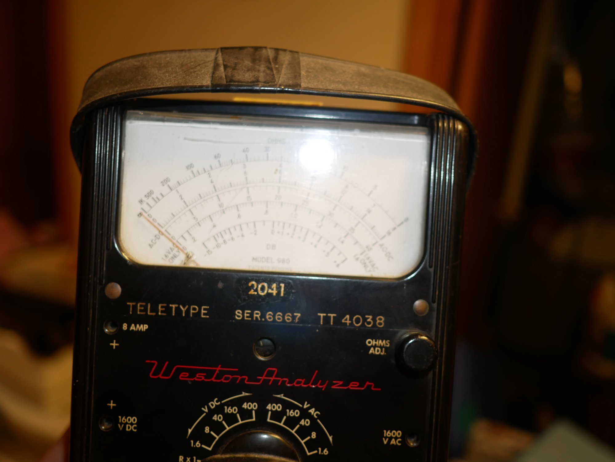

I don't know what prompted me to dig out my multimeter, but I did. At full charge at the charging port and at the power out port I get a reading of 33.3v instead of 48+v as it used to. Doing the math I come up with a group of 5 batteries that seem to be off line.
