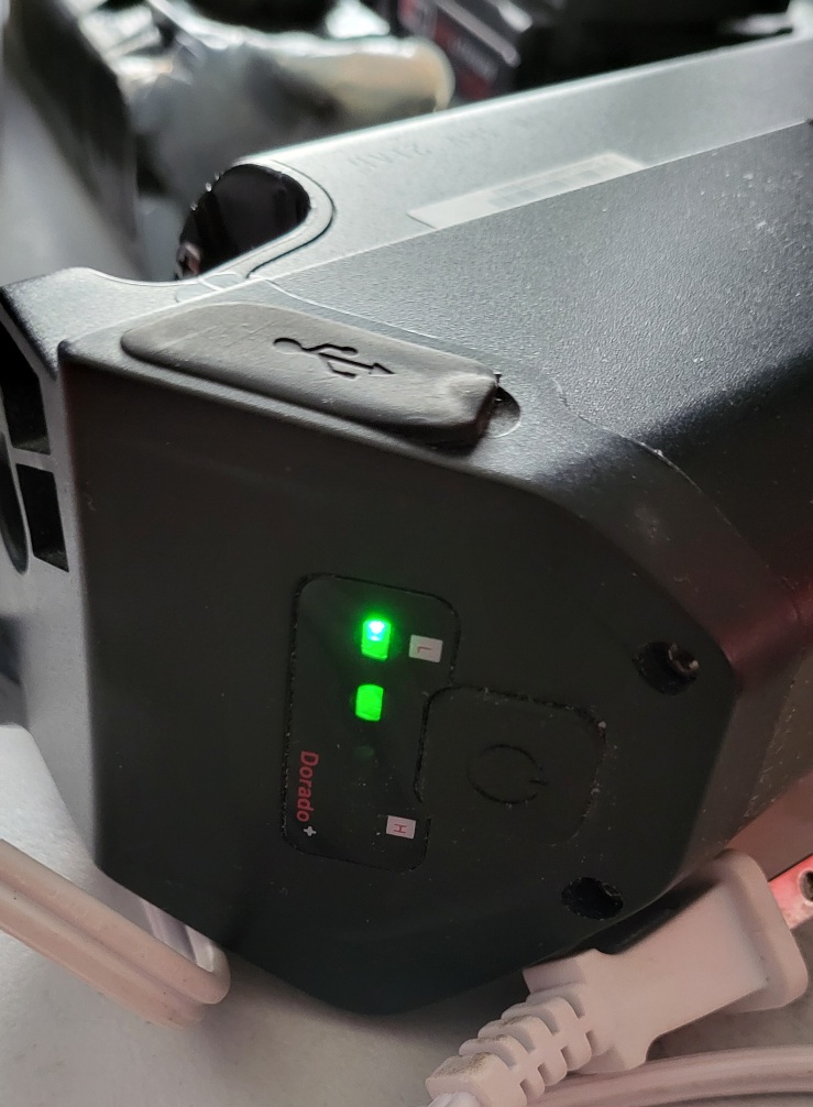

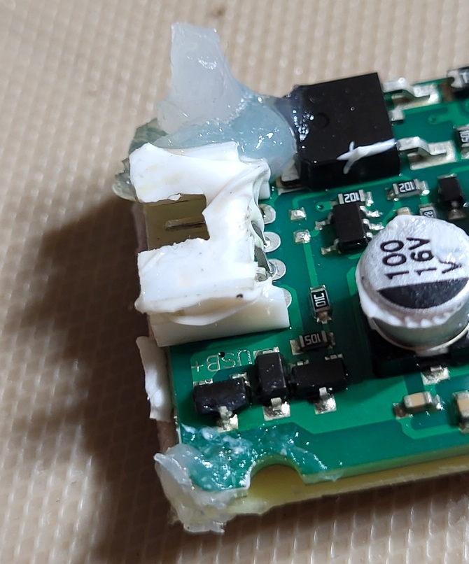

Is it possible to repair Reention battery power button (with LED lights)?

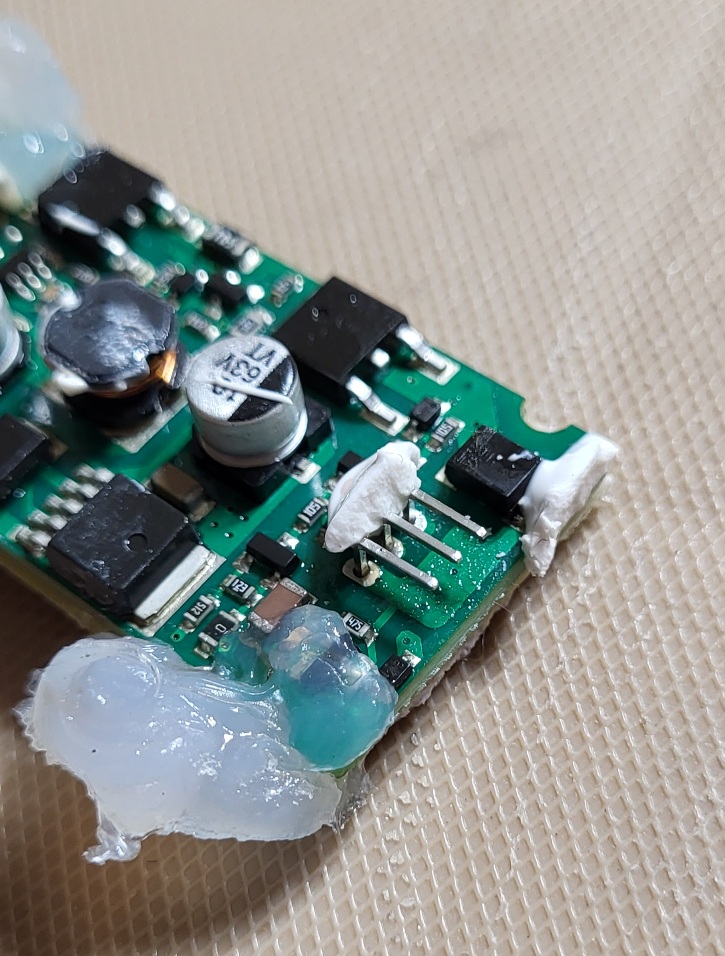

Mine just used the white electronics silicone, and I could pick it off easily.
(I added the clear silicone)

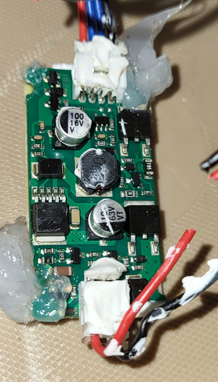

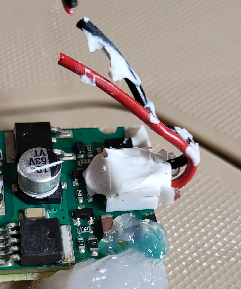

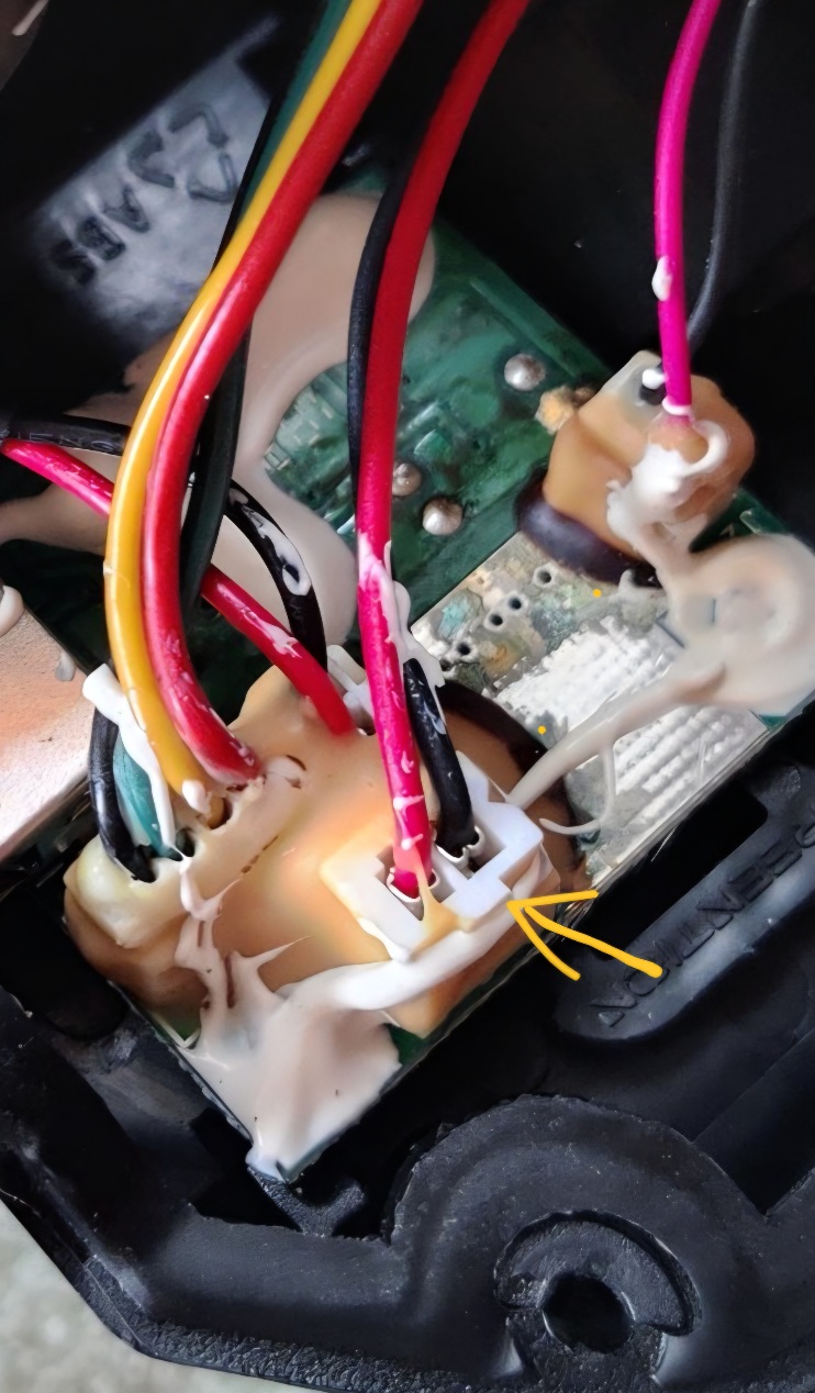

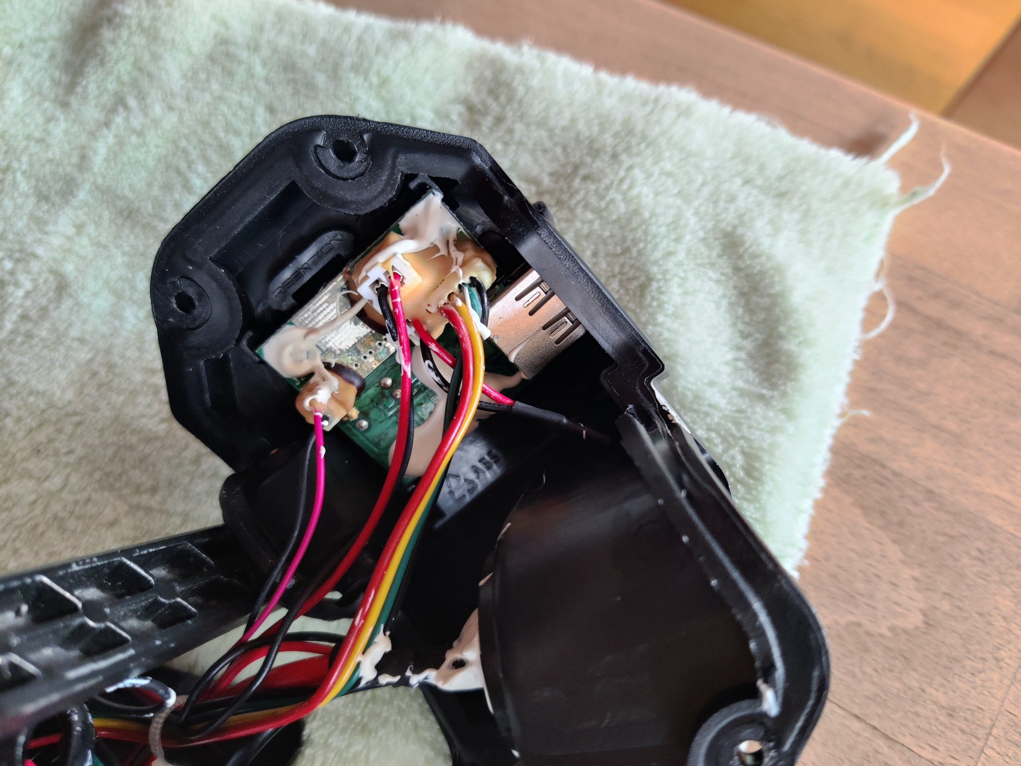

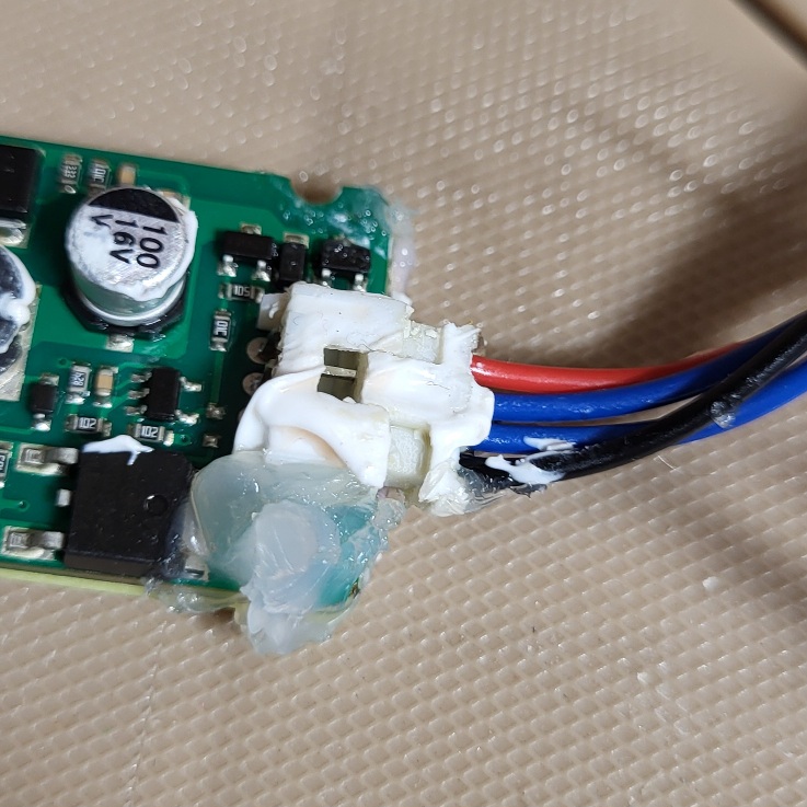

Sandros circuit board appears to be using both silicone and hot glue?
Hot glue can be more difficult to remove, and that 4 pin connector looks to be glued in pretty good?
Sandro should still be able to get his battery working without the USB port, if he can't get the connector disconnected.
It's not a concern to save the old board.. So it can be destroyed in the process if it makes things easier.
A hair dryer can soften the hot glue's bond. Just be patient and don't use so much heat that you deform the connector.
Patience with this type of work is paramount.
There are electronics repair stores all over the place these days. They usually repair phones and computers, but they may be willing to do this simple repair for you if you are uncomfortable with it.
Sandro should be OK.

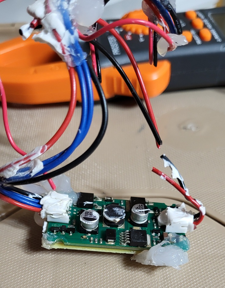

The chances of a short circuit are slim, and the BMS will shutdown the output if you do short something.

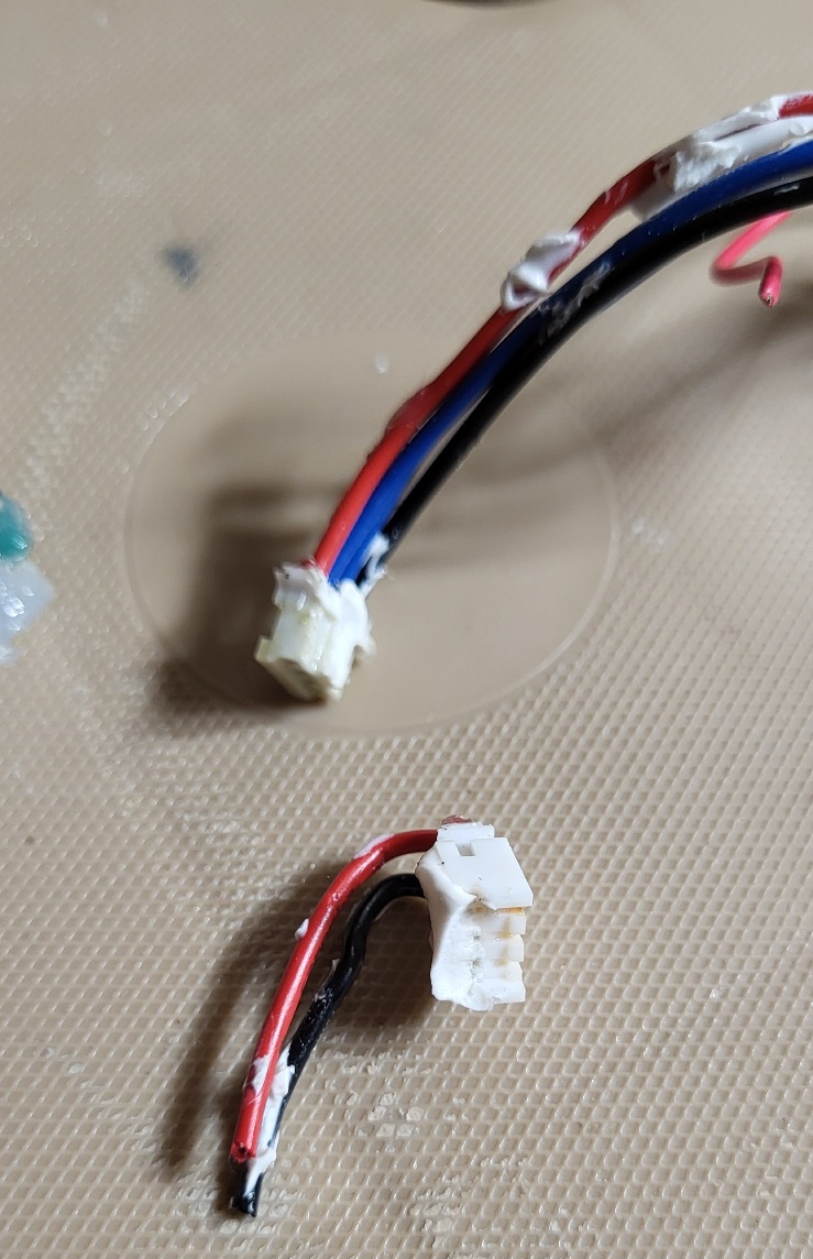

Just replace one connector or one wire at a time.
Even a fully charged battery (54.6V) isn't enough to give you a shock.
It takes over about 90 volts to feel a shock if you touch the wires with your fingers.

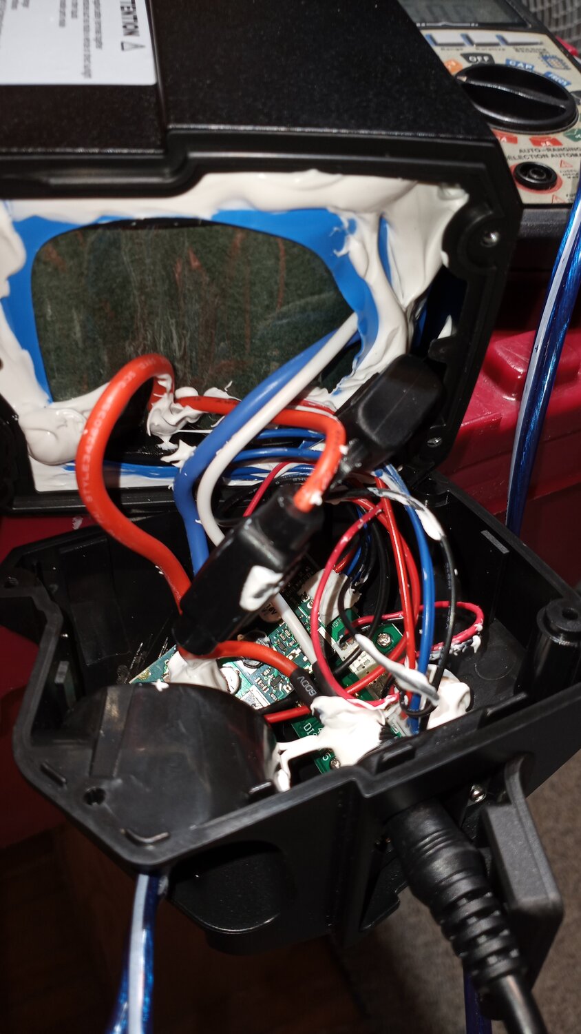

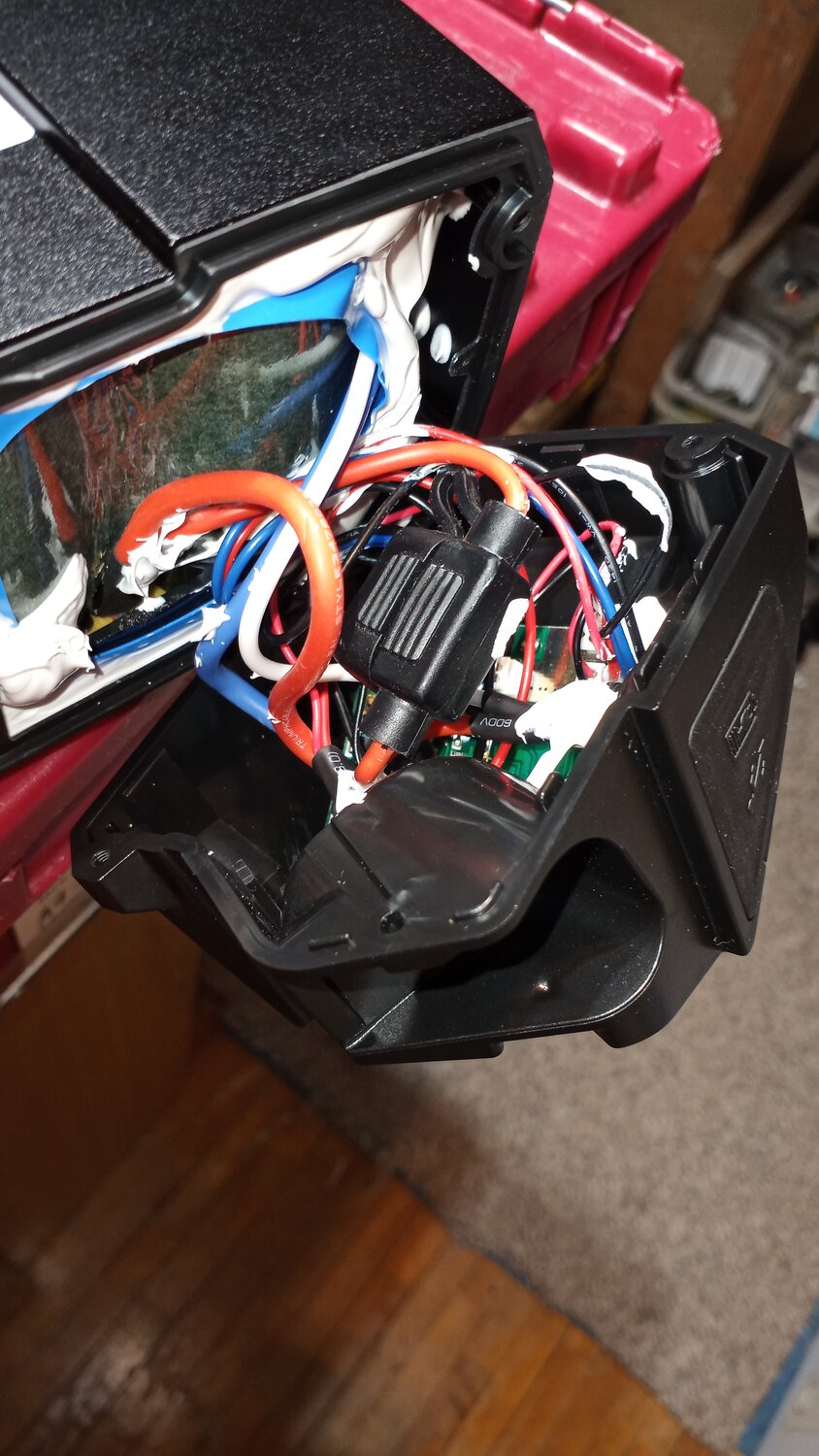

My battery and circuit boards were live when I gutted the circuit boards from my battery.
I just snipped all the wires (one at a time) then coated the cuts with silicone to insulate them.
I used a pair of Strong reading glasses to get all up in there to see what wires were coming and going and to find the seams of the connector to make sure that I was prying on the right spot.
I agree he should be fine. Connectors are easy, but not everyone is comfortable soldering or crimping wires. I use a headlamp when soldering, but reading glasses are a good idea.

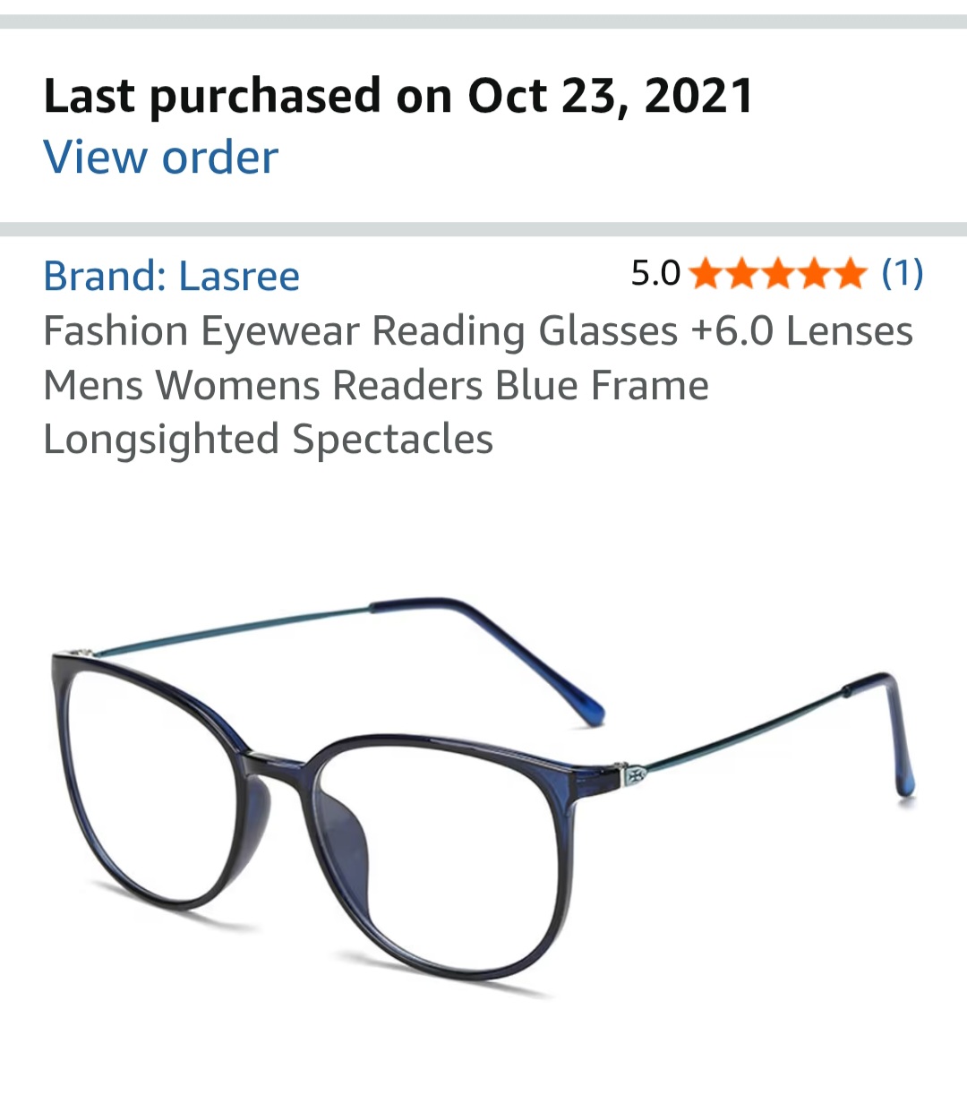

I bought a pair of +6.0 reading glasses, because the ones at the dollar store only go up to +3.25
I rarely use those glasses because they kinda give me vertigo and make me dizzy.
I don't wanna get sea sick and barf all over my circuit board. 😁

Little update.
I will eventually replace the board, the seller confirmed it's the right piece.
I found a local store that will do it for €30-40.
For now I'll be waiting because I noticed that pressing the power button with a little swing motion works instantly, probably there's a bit of rust that moved when I opened it to check? For now I'm good 👍
Little update.
Try spraying the switch with a little Contact Cleaner

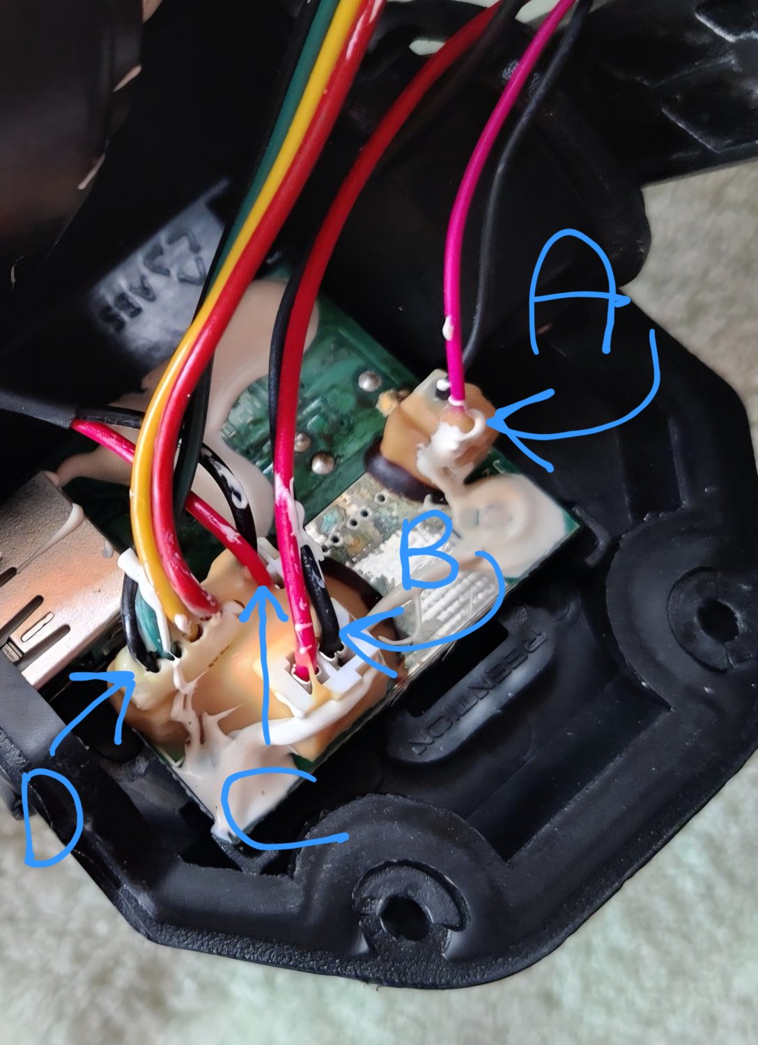

I'm glad that we have a few Reention Dorado people onboard as can only help each other when problem solving, plus instills confidence (for me anyway). While stripped out of casing, i would really appreciate any shots of the BMS end of the battery to physically confirm the wire runs for -P,-B and -C, as although i replaced "like-for-like" from the defective board to another, the majority of wiring diagrams for compatible BMS show a different connection to my large battery. I will post a pic of original BMS at some point but getting PC to talk to phone is a pain.
