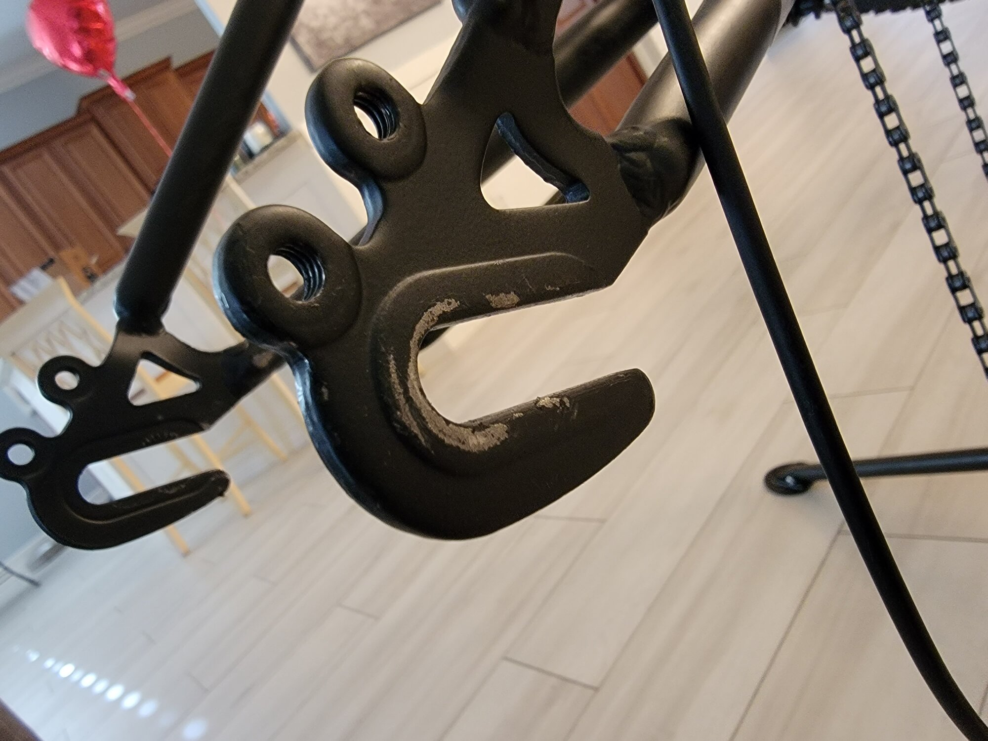

If you take the bike to a good hardware store they will try screws that fit the frame using mm and tpi, selling you the correct one. Give them a tip for their time.

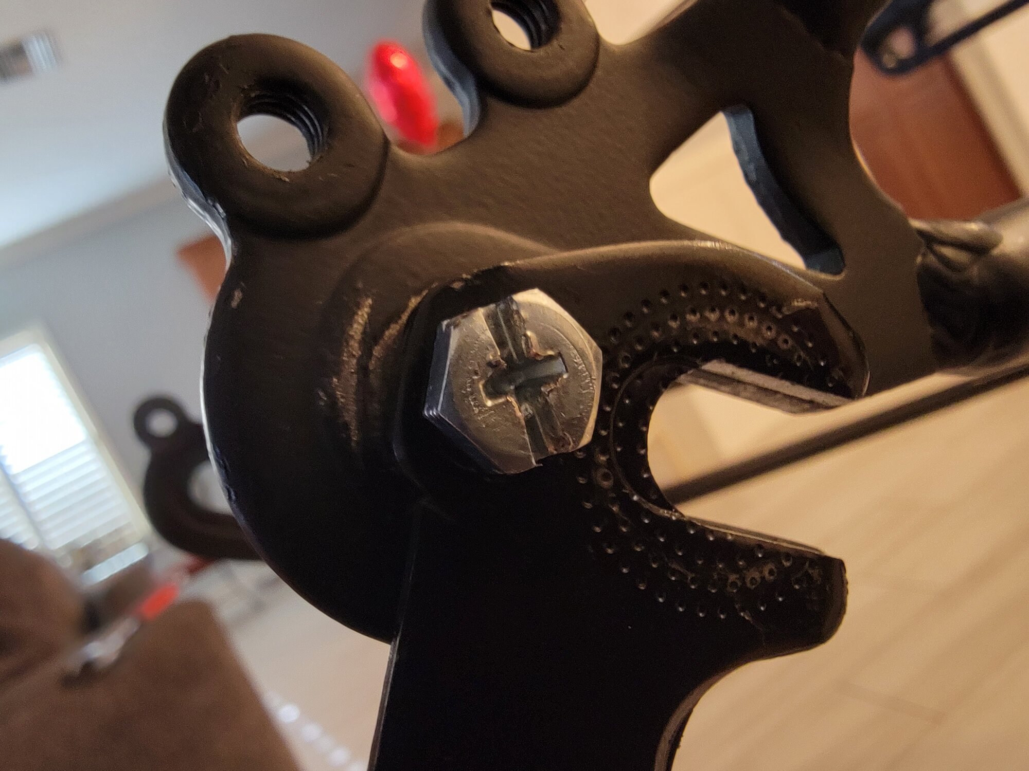

I had some time to poke around today and found the following:
The first photo is the right dropout with the 2 threaded screw holes. I found a screw to fit but if I use those holes, the dropout on the derailleur doesn't line up with the dropout of the frame.
The 2nd photo shows how the derailleur is designed to fit without using the threaded holes.
I'm at a loss

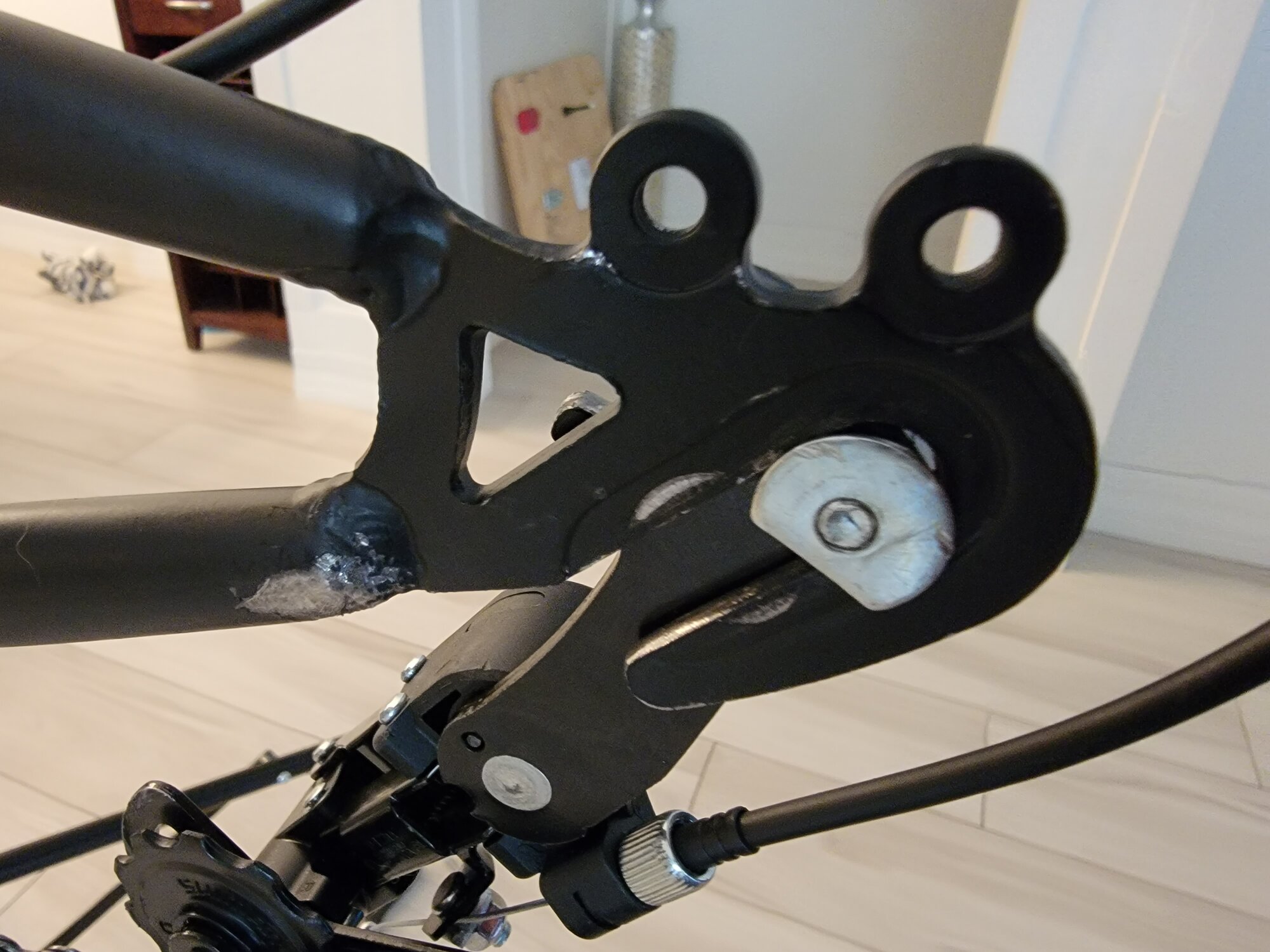

Try twisting it so the flat side of the washer in the last photo is down and report back.
I have. That last photo is just to show what the inside looks like with the derailleur and screw in place. It sticks out too far and hangs up on the side of the cassette.
I'm going to try to do a little filing of the nut and see what happens.
Don't file yet. I think it is backwards but it is hard to get context. Make sure that the derailleur is on the outside of the dropout. It looks to be on the inside.
It's on the outside with the bolt passing through to the inside. The bolt is what was binding up. I just made about 6 passes on the back of the screw and it fits like a glove now... a very tight glove but it no longer touches the cassette.

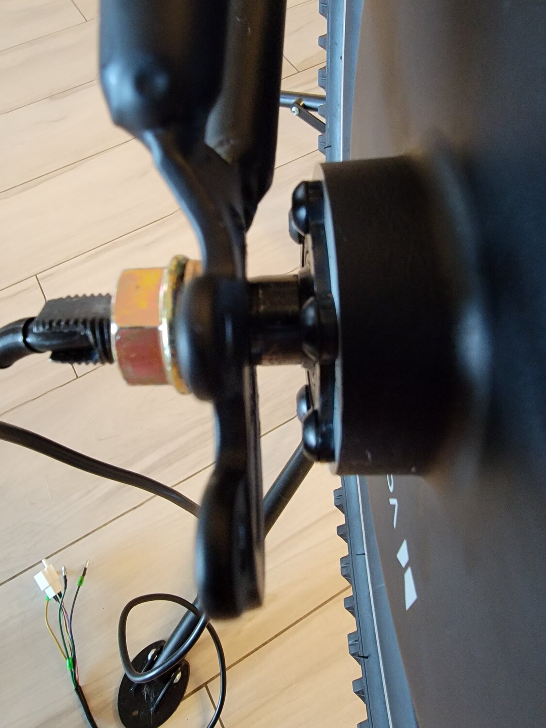

You can see in the photo there is no room for the inside
I'm trying to get away without having to spread the frame at all. The right side of the wheel I'm able to fit a spacer on each side of the axle but the left side there is no clearance for a spacer on the inside.
How imperative is it to have a washer in each side of the axle?
You can see in the photo there is no room for a spacer on the inside.
If you cannot expand the dropout to fit the washer/spacer on the inside And everything works without rubbing While being a secure fit Then you are probably just fine.

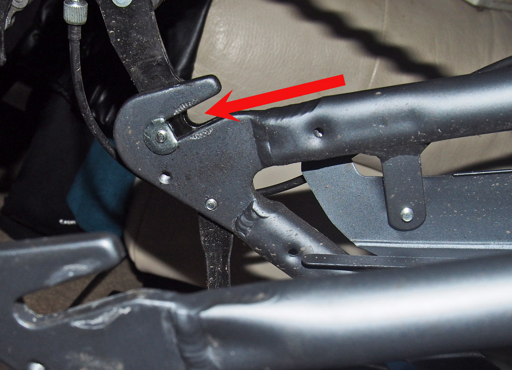

On bikes that use the hang-on derailleur hanger, one has to file the "C" part of the hanger to get the 12m flat of the motor axle deep enough into the dropout. Arrow points to that.
That round tab should seat in the dropout slot, but the axle shouldn't touch it. Sometimes it will hit the freewheel, but washers can be added. If the freewheel is that close, it's hard to use the small gear.
