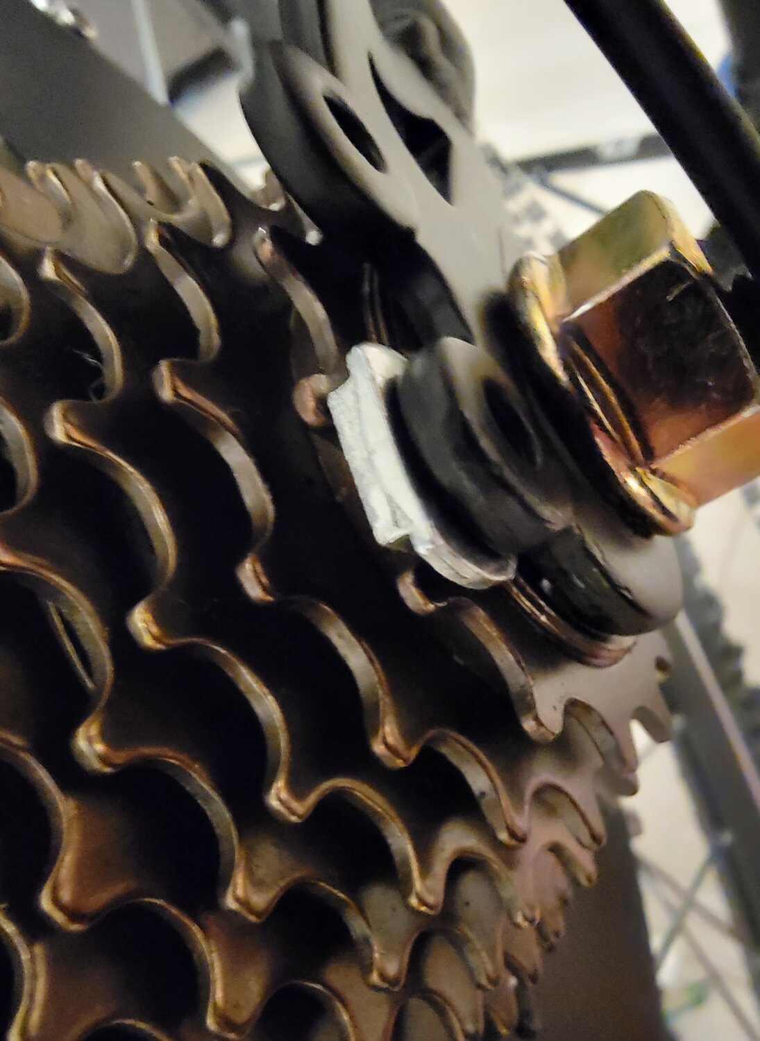

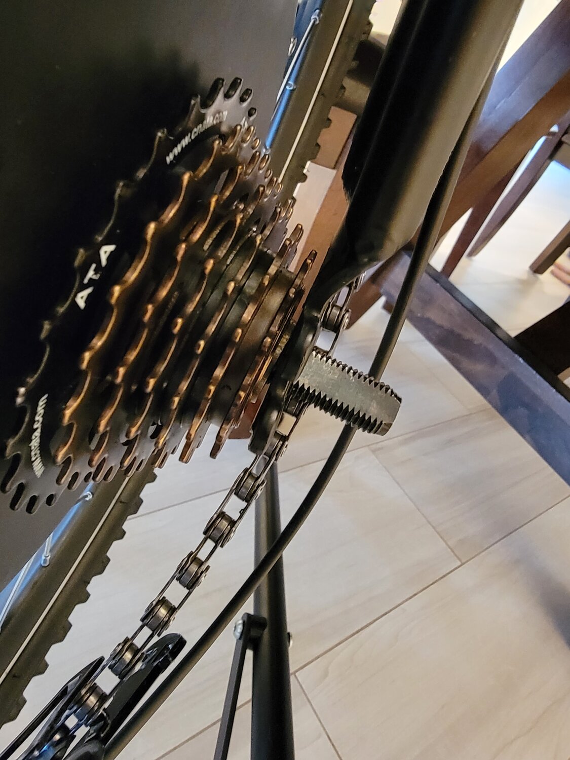

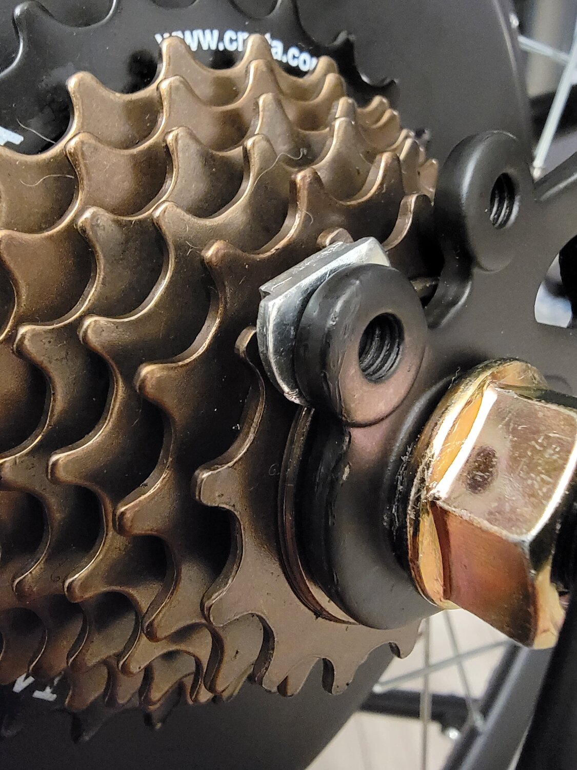

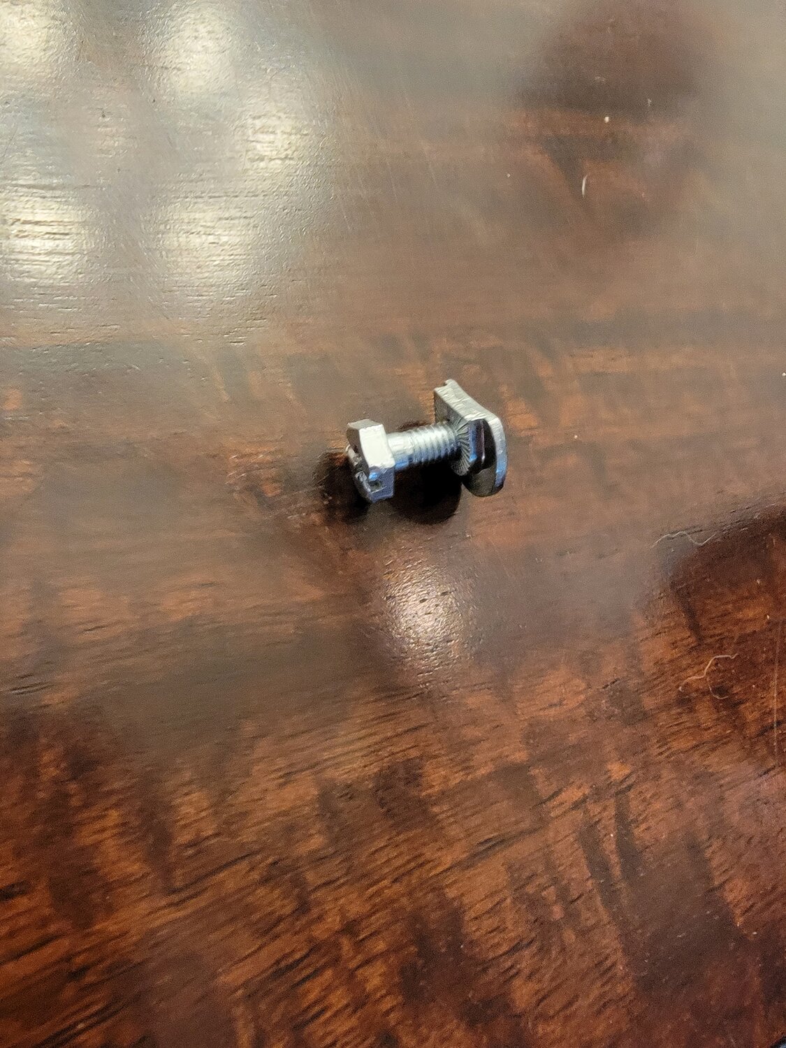

I was able to get the rear wheel in place but only with the derailleur removed. I've attached 2 photos showing the nut wedged against the cassette.
Ignore the lack of spacer(s) this was just testing to see if it would fit.
So at this point it looks like I'll need to spread the frame?

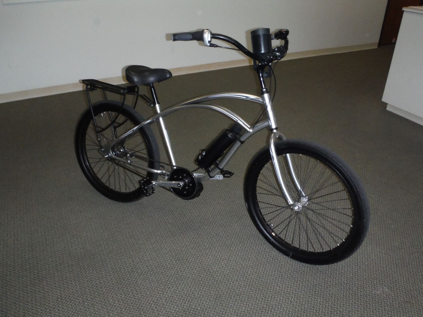

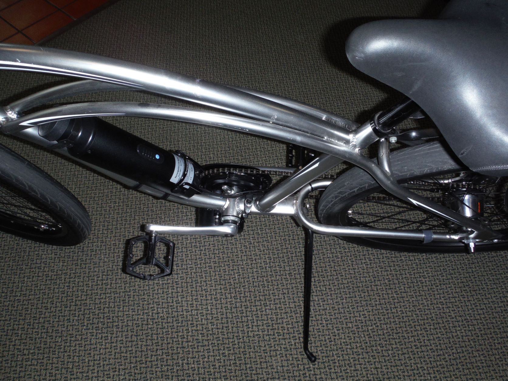

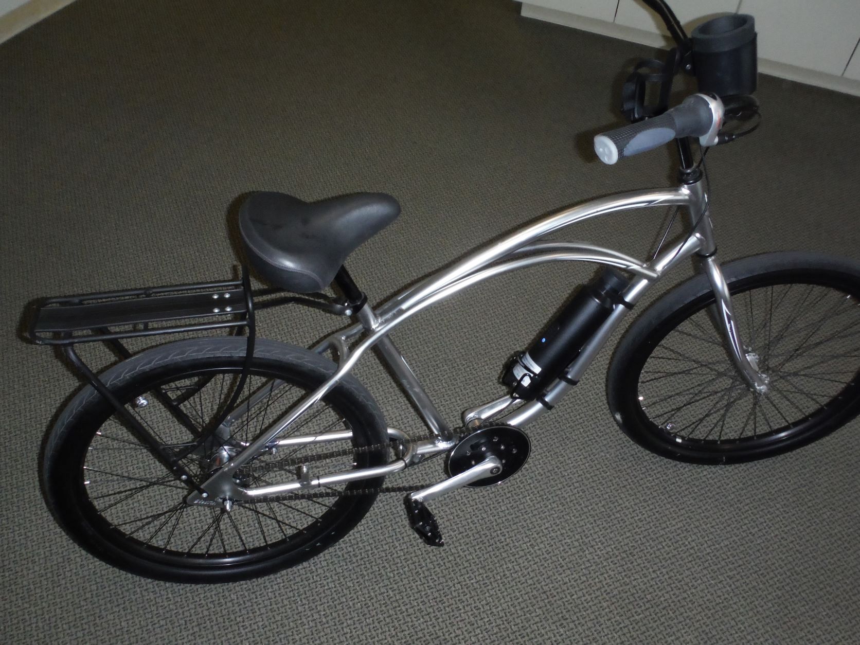

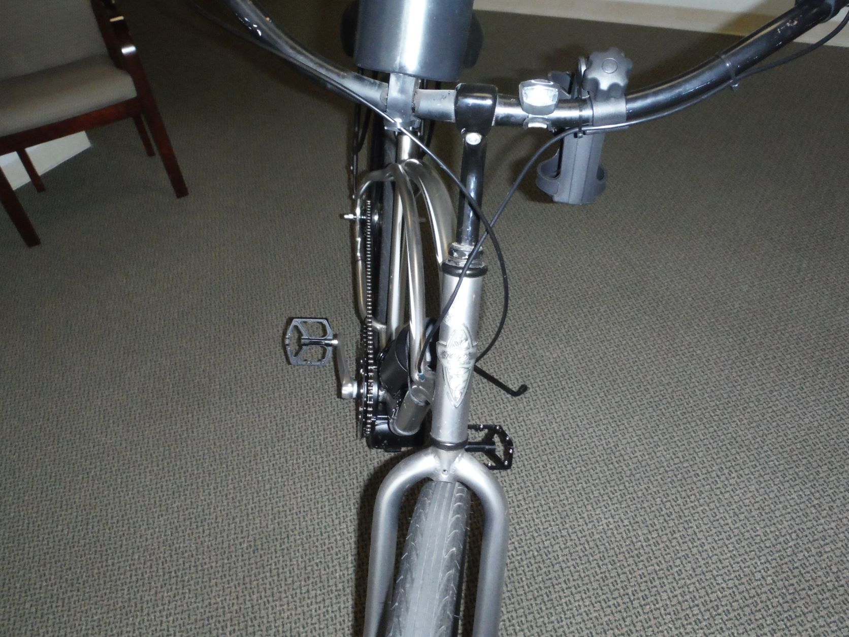

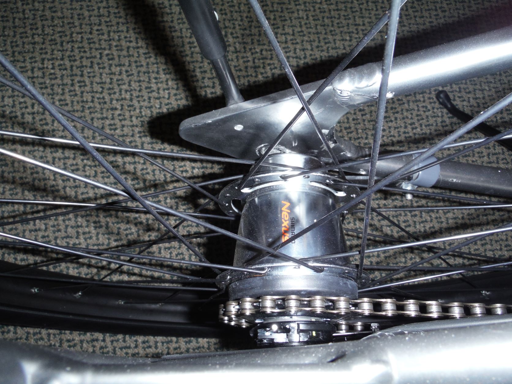

Yes, you will spread the fame the first attempt at three times the amount you need for clearance. Test the spread and spread a little more the second time if needed. Test again. Be gentle the first time. You are right to mention spacers. They will need to stack inside the free wheel and against the frame, allowing for both clearance and something to tighten the axle nuts down against, so it holds in the dropouts. Here is the build I made that tool for. It was a regular one speed bike. I made it an eight speed coaster brake internal hub with a torque sensing mid-drive. The goal was to make it a clean build. This is a class three bike now. The dropouts were too narrow. I needed to expand by 6mm. That meant stretching to 18mm and letting it spring back to 6. Zoom to see how I removed ugly wires and connectors.
What is that piece of metal between the gear cluster and the frame? If it's meant to represent where the derailleur fastens, is there a good reason you can't install the derailleur on the other side of the frame?
If that piece is supposed to act as a nut for the bolt holding the derailleur, it's not necessary, as that hole is threaded. No nut on the inside of the frame necessary.
Or maybe I'm just misunderstanding the issue totally.....
That piece of metal is the nut that holds the screw for the derailleur. The hole is threaded, but the screw that came with the bike is too small... I suppose I can get a bigger one and try that.
