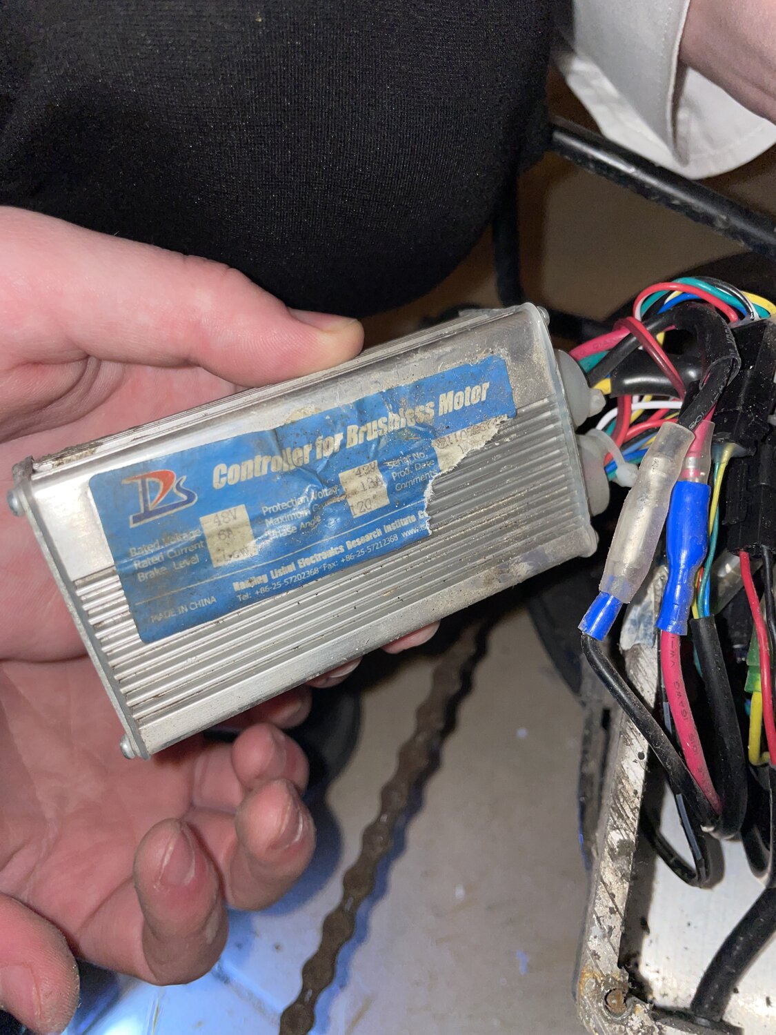

What is the continuous amp rating of your controller? Your battery is sufficient. Your controller regulates the amps to the motor. More amps = more power/speed.
cant get to the controller itself :( the screws are all stripped. ill see if i can check through retailer or bike model number

There is probably a connector loop on the controller that limits what power this motor puts out, so you should think about getting those stripped screws off,

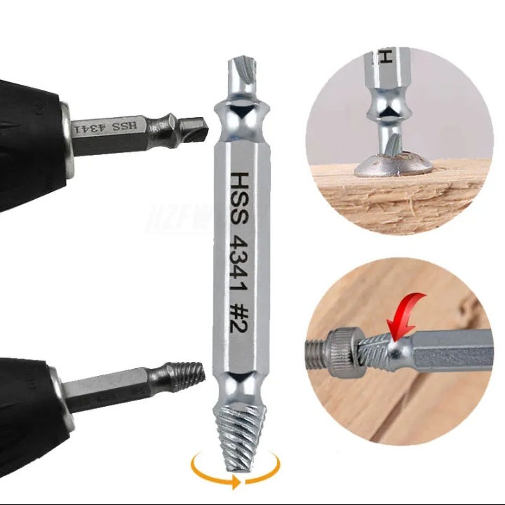

While I prefer screw extractors, that's last resort. Cutting a slot with a dremel and using a flat bladed screwdriver works for some people. Those are just coarse screws in a cheaply tapped aluminum boss. Or get a new Phillips screwfriver with a sharp tip, give it a tap with a hammer to sink it into the soft screws, and see if you can spin them out while pressing hard against the screw. Hit them with some penetrating oil and let it soak in for an hour before trying to torque them out,
