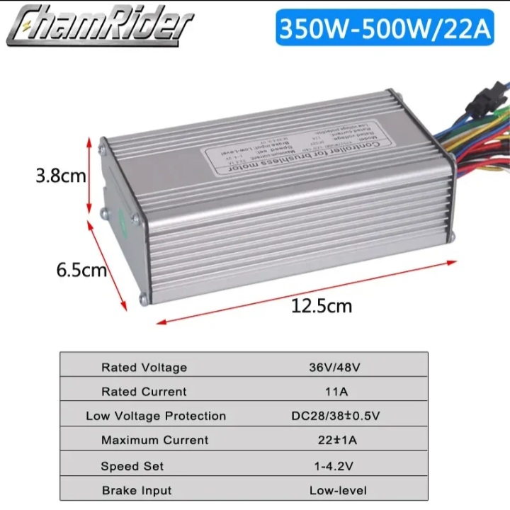

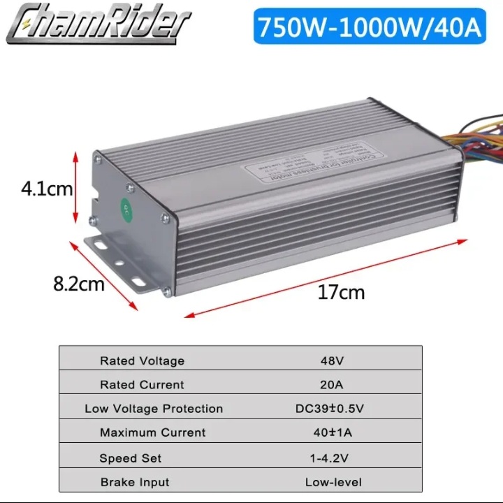

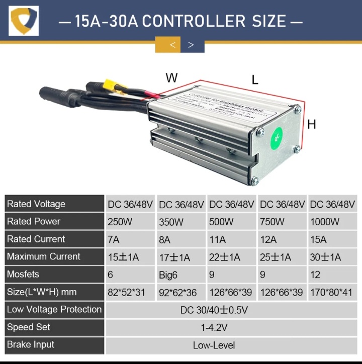

All the KT controllers that I found on AliExpress listed the measurements.
Generally speaking they have 6, 9, or 12 Mosfets.
The Mosfets have been improving over the years and became more efficient, so the old 17 amp controllers are now capable of about 22 amps with the same size box.
You should be able to measure your current controller to compare with what you're interested in buying.
Sinewave is generally better than square wave.
Square wave is more efficient for the controller but it's noisier for both the controller and motor, and the efficiency saved by the controller is then wasted as extra heat in the motor.
Sinewave is kinder to your motor by providing smoother and cleaner power.
The KT controller also comes with JST connectors or waterproof connectors, so you'll need to pick the one that will plug into your ebike.

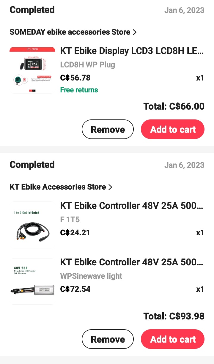

This is what I decided on,..
I figure that they aren't going to lie about the dimensions, but they could lie about the power, because everyone wants More Power. 😂
I have seen mistakes though where the measurements weren't listed properly.

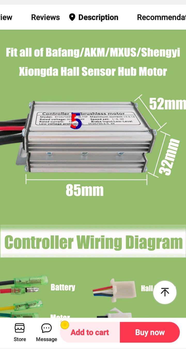

@Gionnirocket there's another more obscure one...took me a while to find it. Listed measurement 96x61x35mm

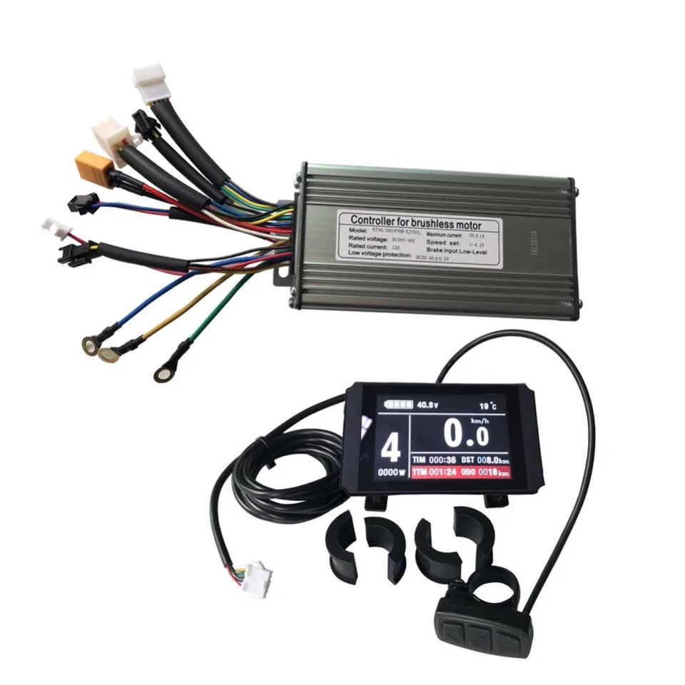

Could I do this on one of the cheaper displays? Lcd3 or Lcd5?
There are lots of KT displays to choose from, and they will all work, but some of them don't have all the adjustable settings available.
The LED880 doesn't have any adjustable settings.
The LCD3 and the LCD8 have all the same settings (except for one extra setting on the LCD8 that isn't worth mentioning) and all the displays are a bit cheaper if they don't have a built-in USB port.
The LCD3 is apparently easier to see in direct sunlight whereas the LCD8 screen washes out in the sun ,and is hard to see.
I'm not sure what the other displays offer for settings.
Yes. Here is a link to lcd3 and the lcd5 manuals. They all look different, but function the same.
