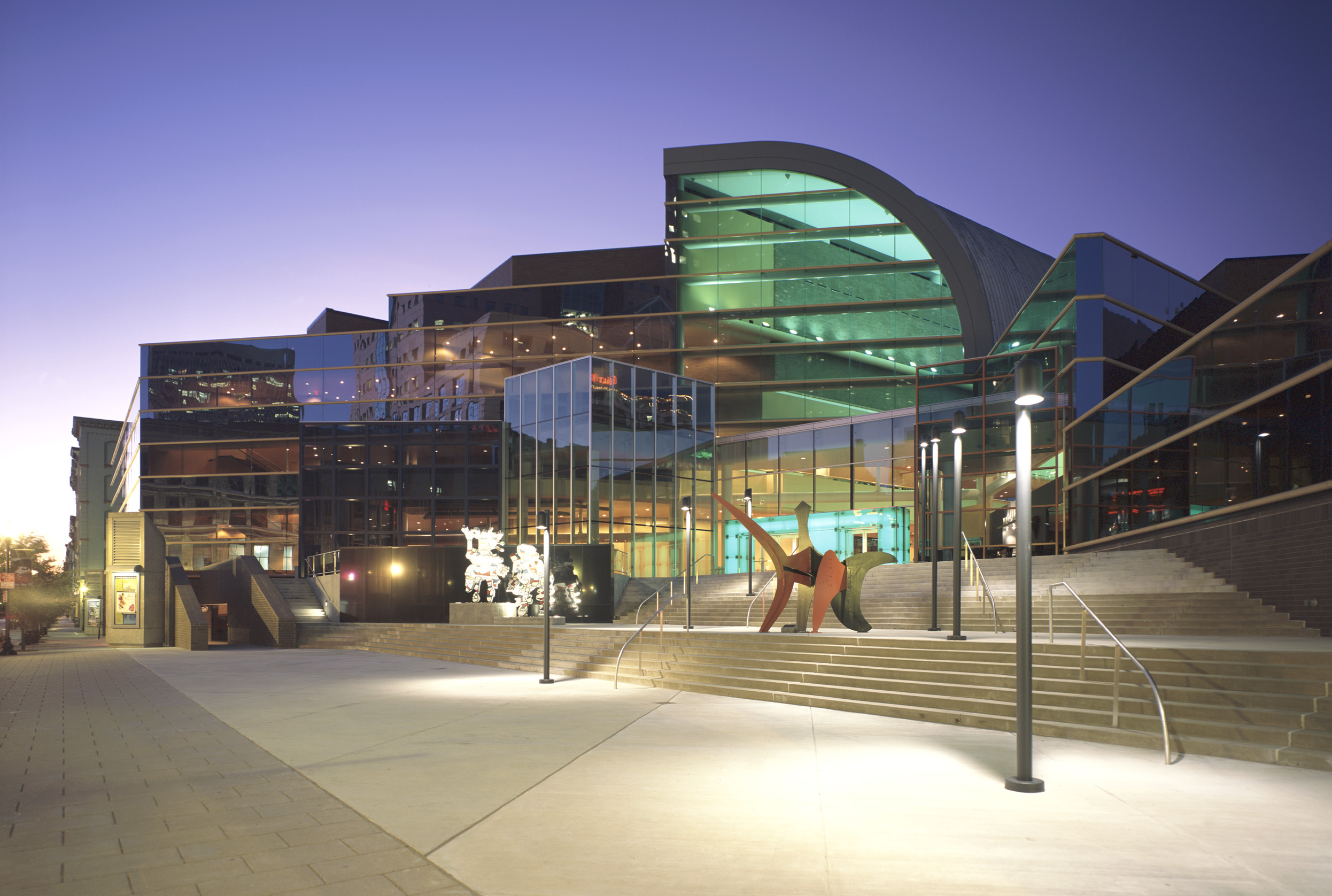

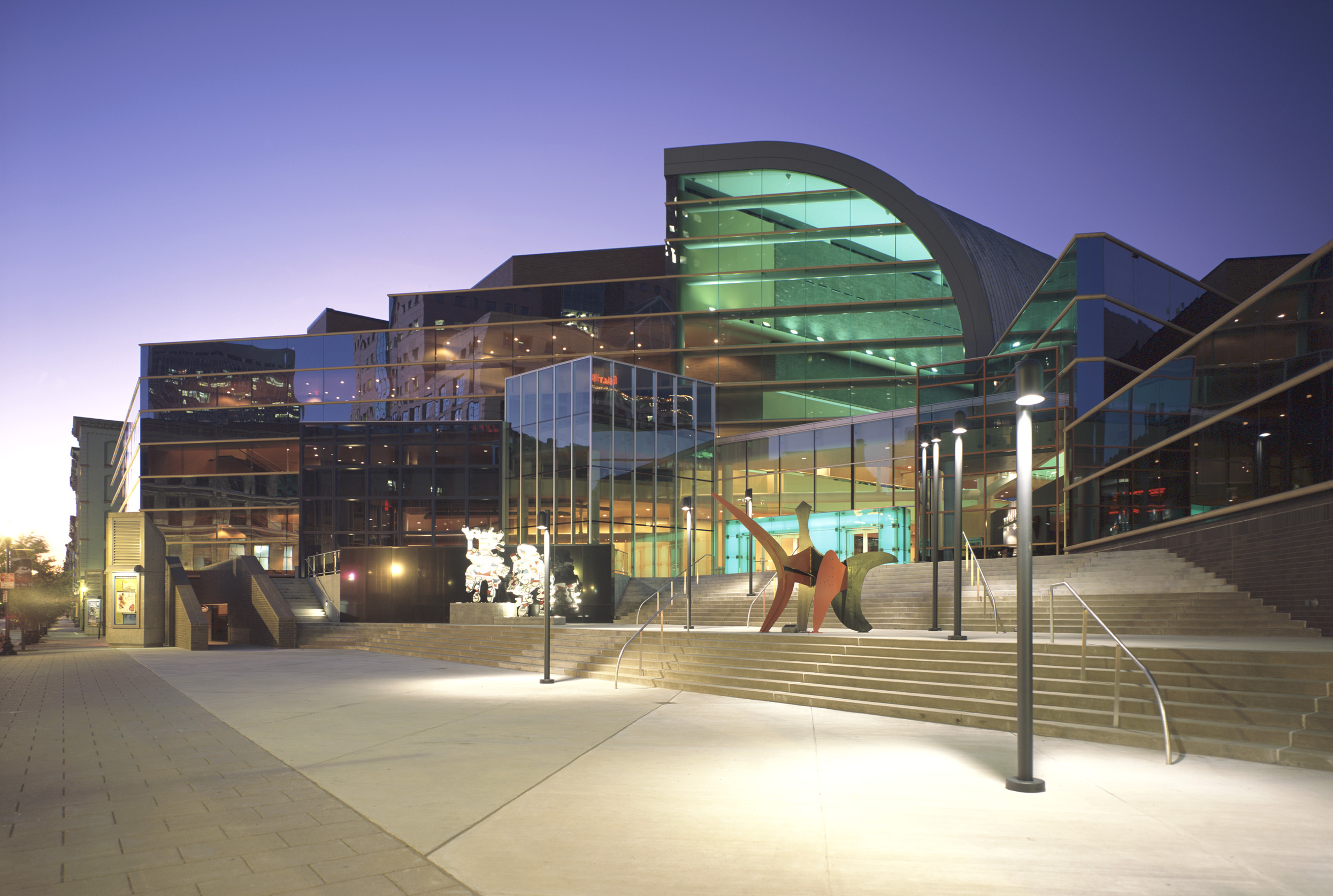

I like those bike cages under a CC camera. Might happen at Red Rocks some day. Will never happen here. Louisville has for about 4 year gotten to thunderstuding steel loops to the sidewalk to lock bikes to. No CC camera.
I've only seen two electric bikes in Kentuckiana, both home conversions of mountain bikes. The one I chased down shopping at Save-a-Lot had soldered his own battery together from cells he bought on ali-express. Talk about do-it-yourself! Not even welded. As I have never seen him again, the reliability might not be that great.
I lock my $50 mountain bike to the no parking signpost right behind the photographer's head at KY Center for the Arts when I go to the symphony. I've never taken the $2000 cargo bike down there yet. View attachment 24769
