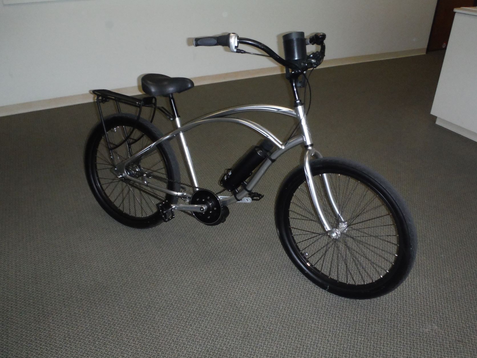

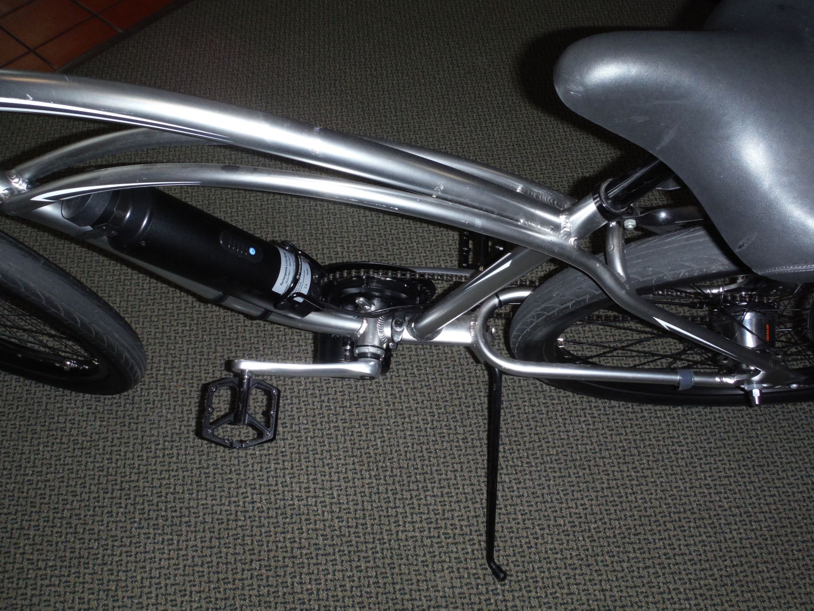

It must be a motor designed specifically for a coaster brake. The internal clutch system is different. These motors have a label on the bottom that says BK for brake. There are also start up issues. The torque sensor must be in a neutral position, without forward or back pressure to set a zero tare. Or it will not work and will give an error code. Yes, this one is a TS. I do not know of others. My go to bike is a coaster brake bike. It also helps make the build clean with two wires to the HB, shift and display. Here is one example.
