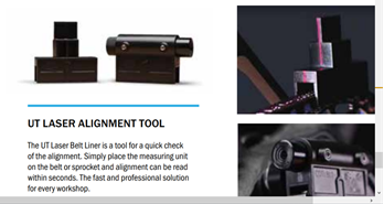

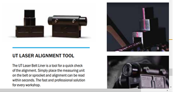

…I've said and repeat: a laser guide is a required investment to align Gates belts.
The biggest flaw of the Gates is that it must be precisely centered. Read the literature....
Thanks for this advice. I've been trying to resolve a belt skipping problem on my Wattwagons CrossTour even after taking it to two bike shops for alignment, one of which specializes in ebikes. Its already at maximum recommended tension. I tore through one belt already.
I see the gates manual refers to the "GATES UT LASER ALIGNMENT TOOL" but I don't couldn't find that specific tool for sale. I don't see it on the U.S. Gates website. When googling, I just get laser alignment tools for car motor belts. Although there is a good video from Gates Germany on using the UT tool. Do you have a link to the this or another laser that would work?
View attachment 104846From the Gates catalog. This is what I'm looking for.
I am Sorry Opimax I read the contents of your conversation this morning, I thought you were talking about the tazer guns. I
But now I realise you guys are talking about fixing your problematic bike.
Another "duh" moment arrives - fleeting glimmers of awareness blossom.
Again what I've said, you need this tool - or better yet, the real one (and to take the course on the site I posted) to keep that Gates in alignment - unless you're cool enough to trust a shop.
Gates has workshop vids posted on European Bike sites - FREE.
What study I did indicated alignment off 2mm was sufficient to fail. My eyes ain't what they were back when rocks were soft, so not sure I could eyeball that, I agree: a laser (to prevent the Empire from Striking Back? uh, no) guide is a must. Hey, I have one on my level and my Skillsaw, why not?
