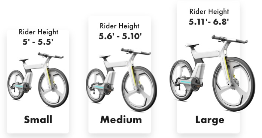

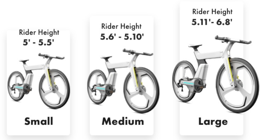

The fact that they use a lightweight, skeletonized chain is not the sign of a builder with experience that has spanned much in the way of time. Although zooming in on the pics at the web page bottom MIGHT be showing the bike in action with a standard chain. Also, titanium is not the metal you want to use for a rigid bottom bracket, which is necessary for a powerful mid drive (been there, done that). This construction, which looks to integrate the gear reduction into the frame in a sort of second bottom bracket - is different from anything else I've seen, though. It might be rigid. Maybe.Titanium, <40 lbs, 3800 watts. Seems to good to be true (although battery is ridiculously undersized - probably last 15 minutes at top power). https://www.chimeracycles.com/home. Maybe someone knowledgeable can let me know if this is for real or a scam (its going up on Indiegogo next month).
